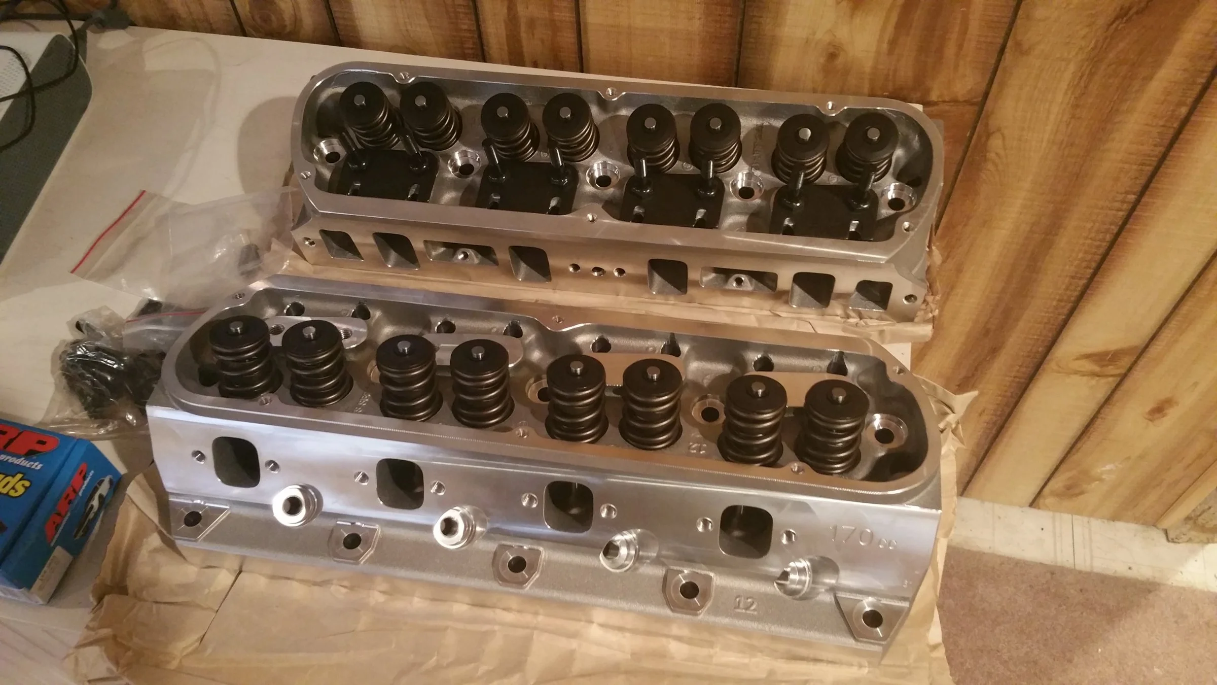

I went with TFS 170''s but it was the whole top end kit. I don't have a flow bench and I don't scream down a quarter mile so I can't give you performance comparisons. what I can tell you is they look great, they assembled with no problems and my ass dyno says they work pretty good.

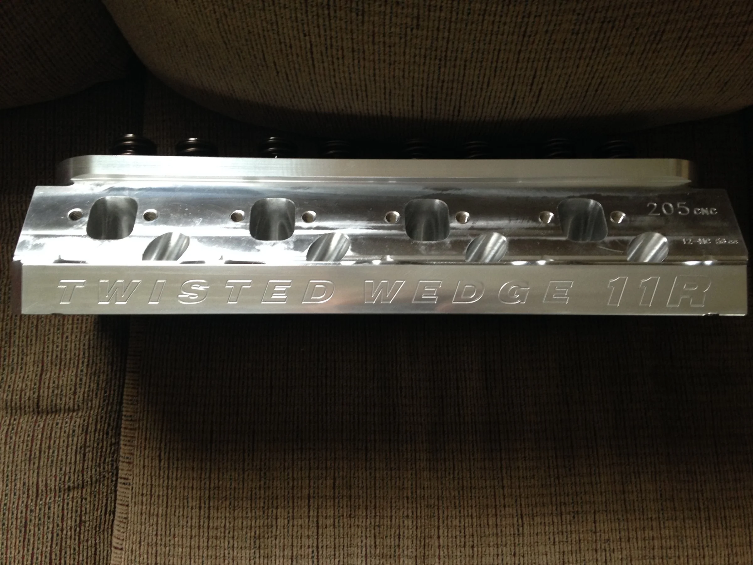

These were mine. No bolton issues. You may want a custom cam. I had the 205's with a custom cam designed for stock shortblock. There are a few guys on corral.net running the 195's on stock shortblocks with mostly custom cams but some have used catalog grinds. Most are making 20-50hp more than the typical tfs kit. Now these are more deticated builds to n/a power but streetable. It's not the cheapest route or absolutely necessary for what your ultimate goals are or will be. If going stroker-n/a build you will need more breathing ability out of the head. That's why I recommend these.
If blower...not so much because you are forcing more air into the engine. The 11r's are a one stop shopping IMO. Capable of supporting a sedate stock shortblock build(overkill but they work) up to about 1000hp in a big inch blower motor. They were running around 2k the last time I looked.
If you're going to make a 300rwhp semi daily driver...go with the 170cc head. If adding a blower and wanting around 450rwhp...either head is a good choice. If wanting a n/a motor in the 350+rwhp or plan on a aftermarket block build...go 11r's
