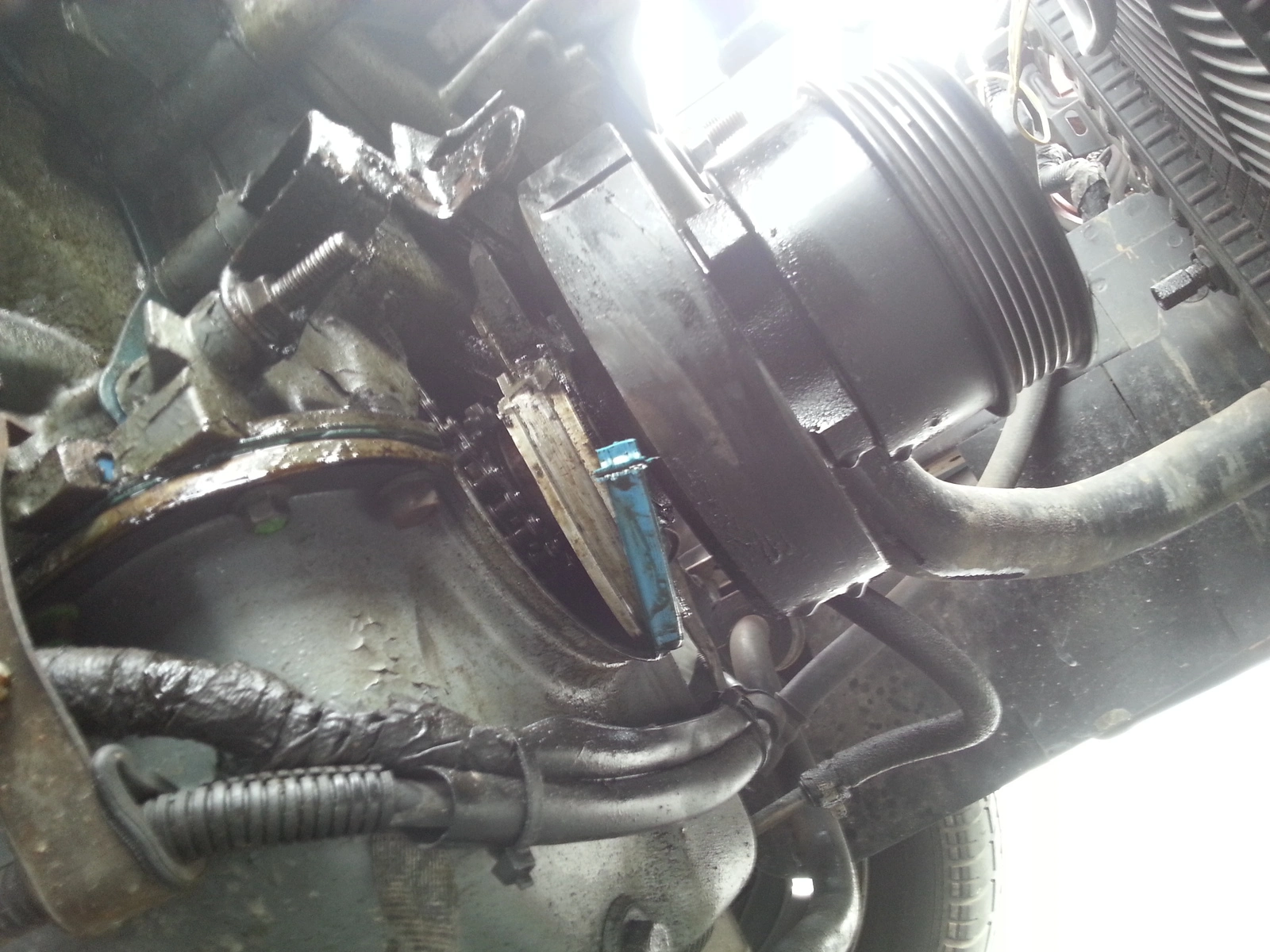

Okay guys here goes for my first post. I was hoping it would be for advice for upgrades. Yesterday something turned loose in my bottom end so now I will be shopping for a new/rebuilt short block. I have been seeing a lot about the expedition motors. Is this a route I should go? What do I need to look for while choosing my short block. My car now has afr 185 aluminum heads a e cam (from what I was told) trick flow intake with 70mm throttle body. I am hoping to bolt everything I can back up. What ever isnt damaged anyway. And also I would like for the bottom end to take a spray if I ever choose to go that way. Thanks for any help

How are u sure the crank is bad and not something else
I am not totally sure. Just by looking at how the crank tried to walk out of the timing chain cover i feel like the crank broke. Im not really sure of ryhme or reason until i get it out. Looks like next weekend may be my first chance. Work is taken presence this weekend but I also need the extra cash to help pay for what ever may come.
If the crank walked or snapped the snout in most cases the cam, lifters and everything else internally are trash. I would expect some head damage as well, but that can all be fixed after a careful inspection...
