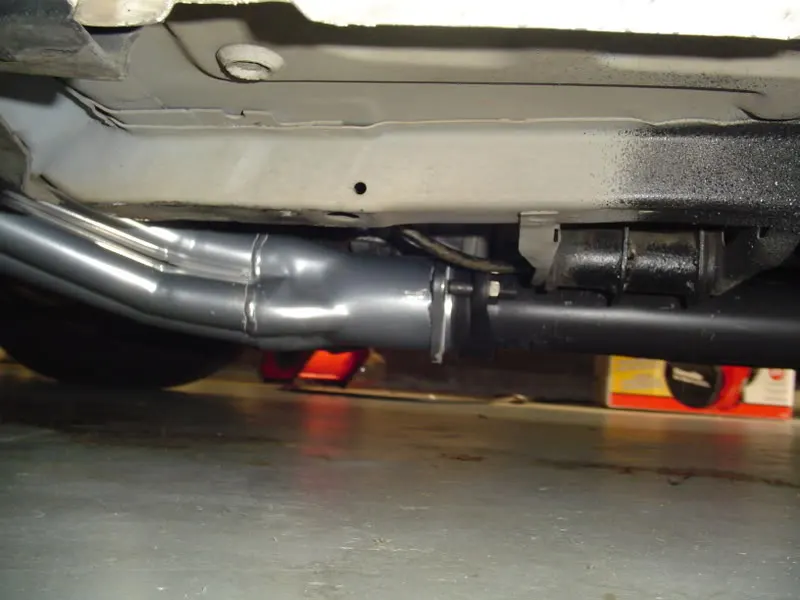

I have the car stock right now; eventually I want to do h/c/i. I just installed a magnaflow exhaust, but don’t really like how low it is... I want it to be louder, so I figured installing header and x pipe will do the trick... Someone had told me if I ever plan on lowering the car to not get long tubes because they will be too close to the ground. In the future I don’t know if I am going to want to put an aftermarket suspension, which will lower the car by 1-2 inches, and want to keep that option open... Is there any truth to this?
yes with a drop of over 1" or in some cases even a 1" drop with spring settling with long tubes there is a very high chance they will scrape stuff like speed bumps, slightly steep angled drives/park lot entries, etc. The long tubes sit lower than shorties.

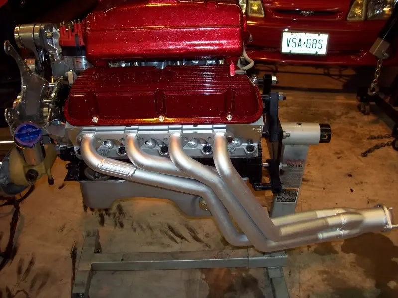

pic of long tubes and how they sit for reference..
