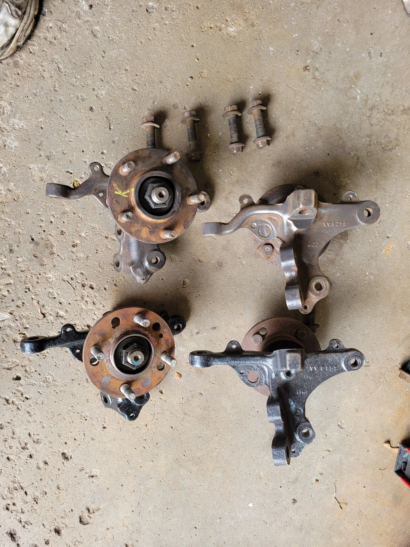

If you want 4 lug on SN95 spindles, do this
The pair on the bottom. This is what I ran for 3 years until I did 5 lug swap. They are 5x108 T-bird hubs re-drilled for the foxbody 4x108. Because the bolt circle is the same, you can use one of the lugs to center a template. I used a 4 lug drum as my template. Drill your three holes and re-install three studs. Voila, 4 lug hubs for SN95 spindles. If you are doing this, find the 89-90 T-bird hubs with the smooth back - this way you can relocate bolt holes.
T-bird guys have been doing the reverse swap for years, putting SN hubs on T-birds, to get 5x114 wheels on their cars.
For rotors, depends how large a rotor you want. If you want to keep your 15" 10-hole or turbine rims, get a rotor from a 94 T-bird (96-98 Windstar, 96-99 Taurus) and redrill. These rotors are same diameter, width, height and hub diameter as SN rotors so a 99-04 dual piston caliper should bolt right up. Earlier T-birds have a smaller hub. For larger rotors, look at Jaguar and Volvo for rotors up to 15.75" in diameter (obviously at this size different calipers and adapter brackets will be required - but can be done with OEM parts).
