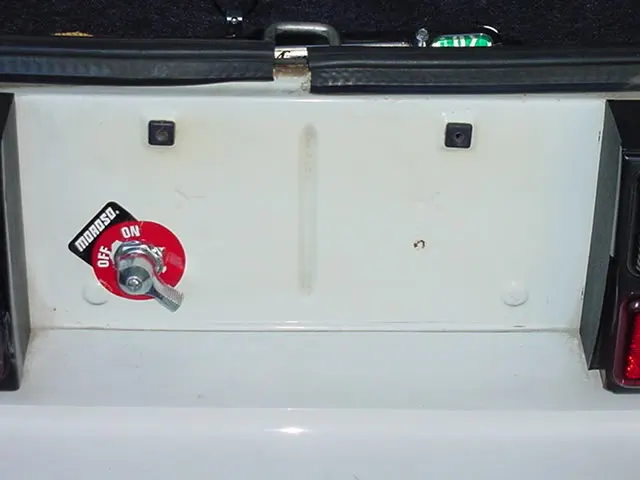

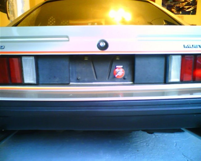

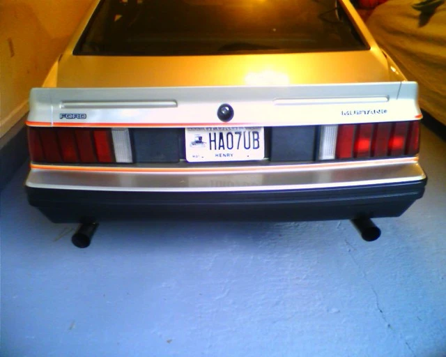

Here are a couple crappy cell phone pics of my switch.
Shot at 2007-07-08
Shot at 2007-07-08

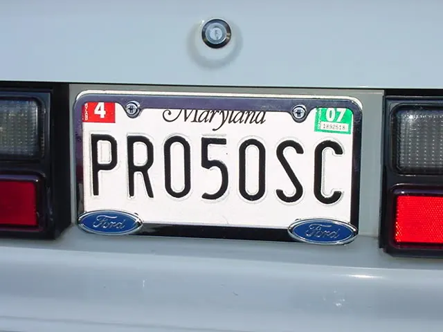

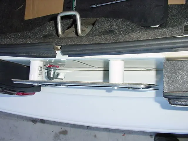

I have since added a flip up tag bracket. No pics though

That is an awesome setup, thank you. I think I might just go ahead and steal that idea.

post some pics of flip up bracket..please..I mounted mine through my buymper and before I go get car painted I think Im gonna move it behind the plate and hide it. But I dont want to take it off every time I go race...

when you space the plate out, the plate lights don't exactly light up the plate and could lead to tickets. just some food for thought

Mine isn't spaced out. Its at an angle so the lights light it up just fine.

Its funny how the simple ideas always amaze me. I never would have thought of doing that.

Yea, that is exactly what I was thinking. I have been killing myself, trying to find a way to not drill into my tail lights and not have a switch exposed on my DD. Then I see that idea, which is insanely simple...yet I NEVER would have come up with that on my own.
