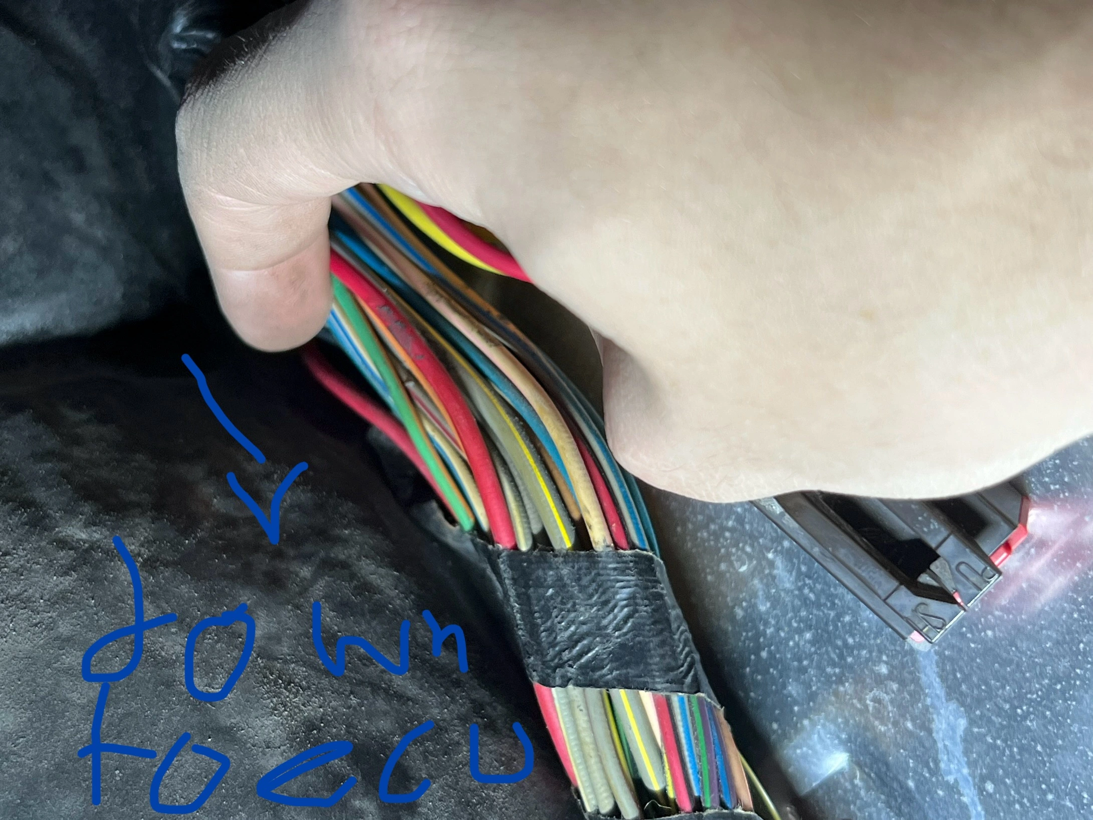

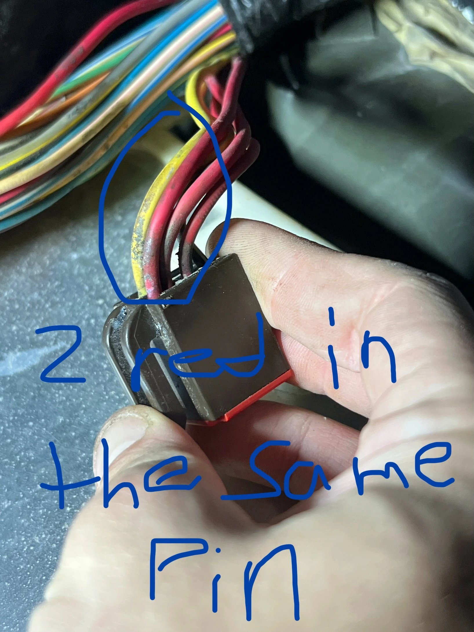

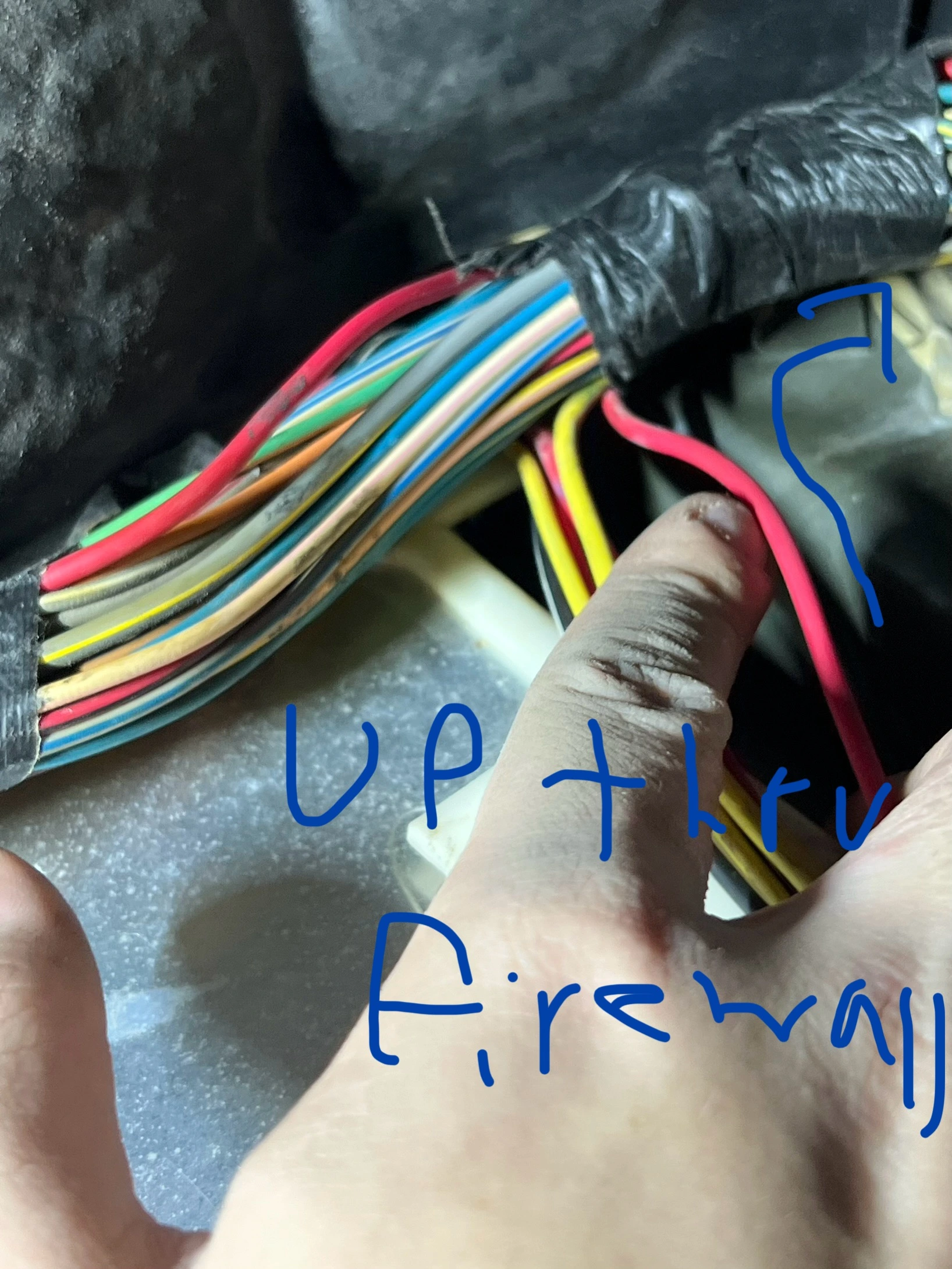

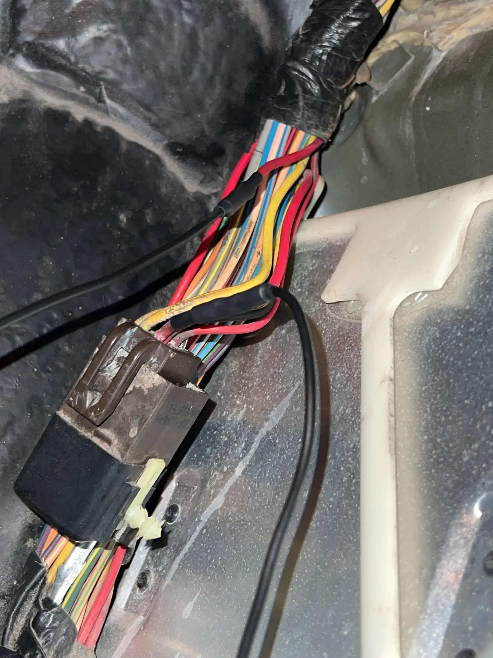

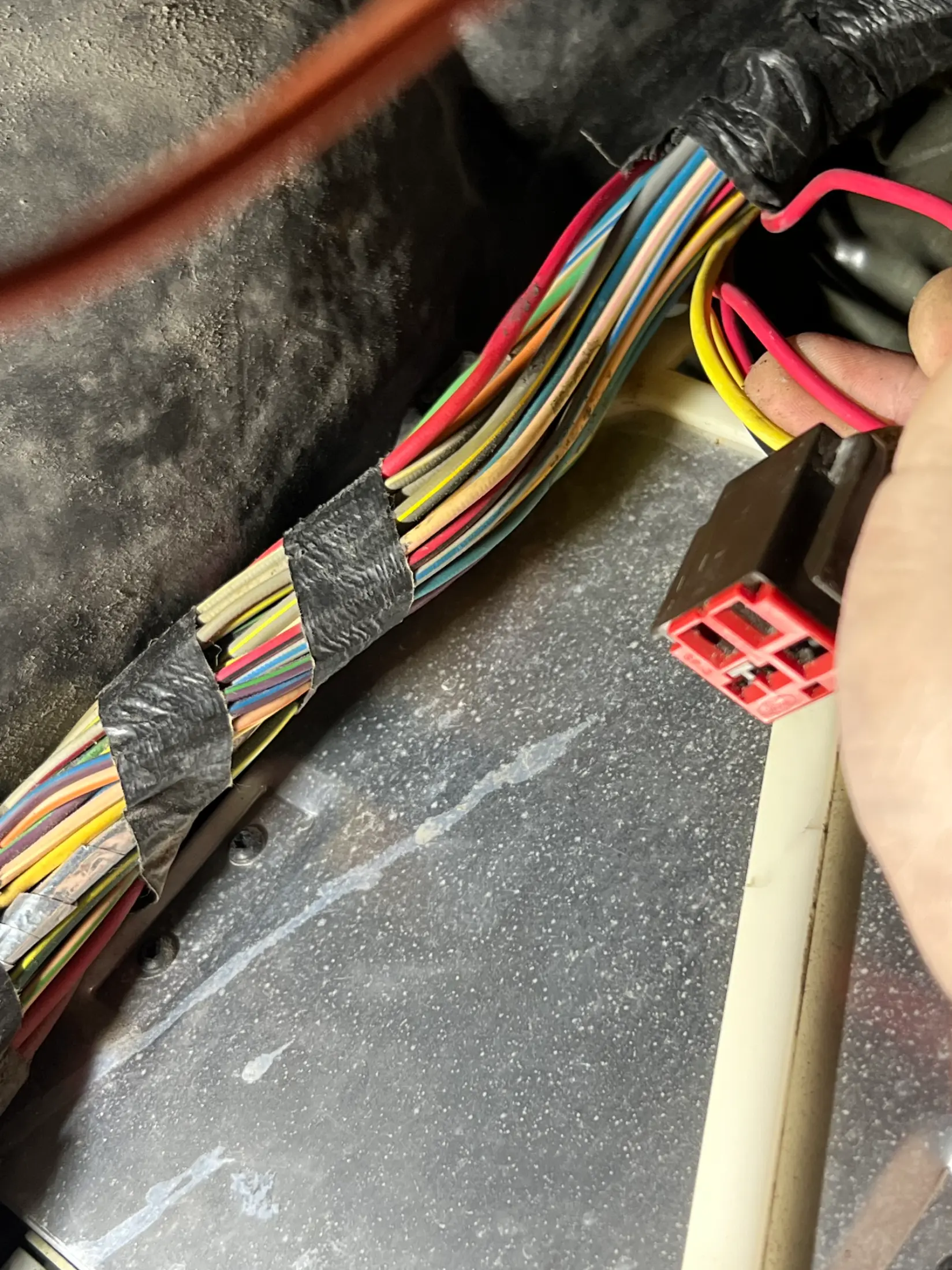

So I got to the eec relay. I have two red wires going into the relay. Which should I cut and put the kill switch into? One of the red wires goes down into the computer, the other one goes out and through the firewall to hopefully the fuel pump relay. I’m planning on cutting the one that goes up off the relay towards the fuel pump relay. Can anyone just confirm this for me that this is correct.

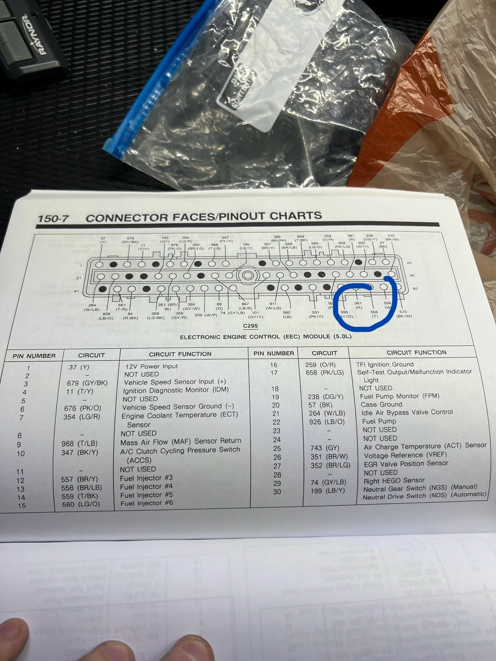

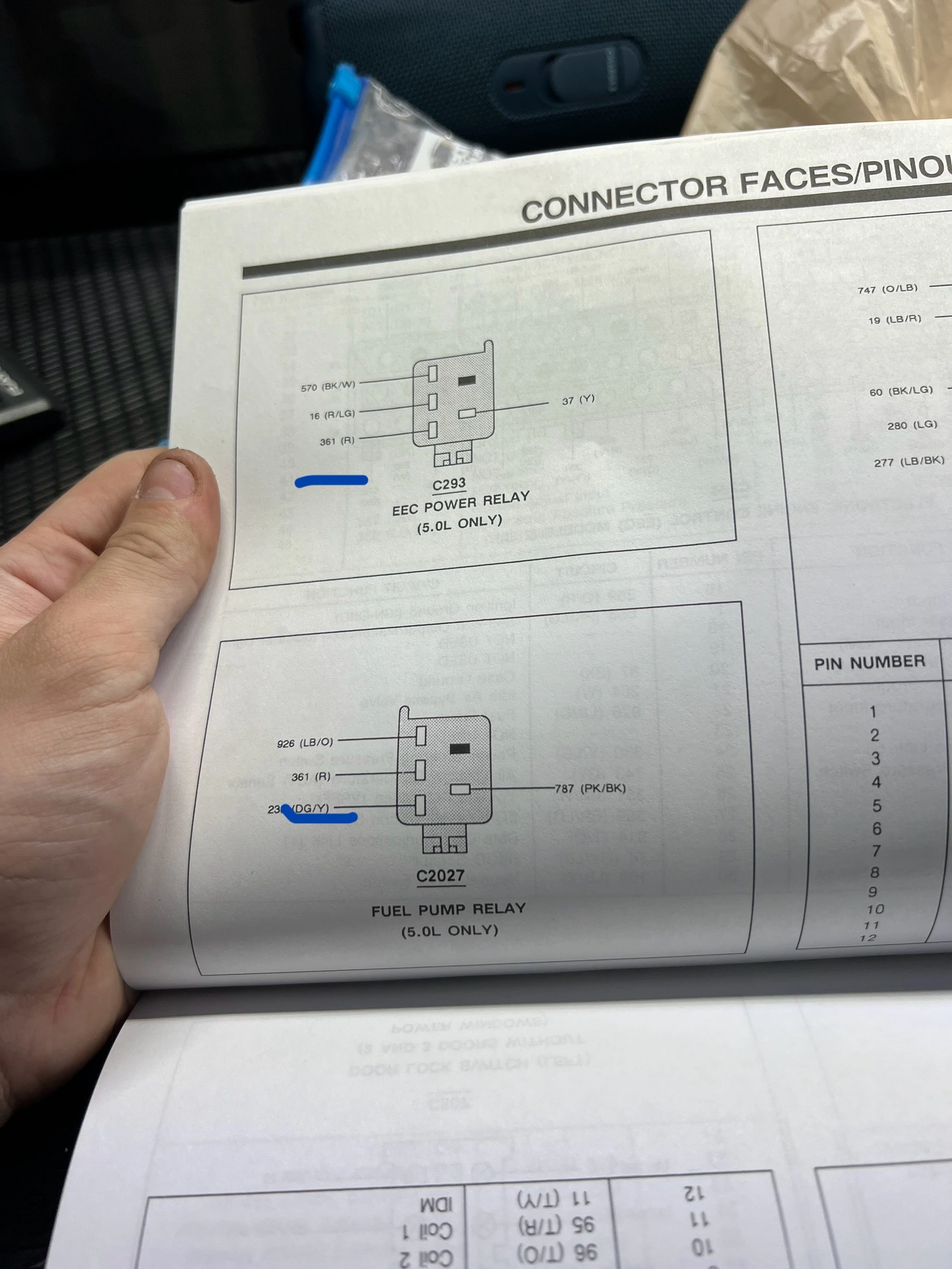

Here’s what I read in my electrical diagram book, it shows that the red wire comes out of the computer, then is at the eec relay, then the fuel pump relay. It’s listed as 361 vehicle power.
If anyone can confirm this is right for the kill switch and I should cut the one coming off the eec relay and heading up towards the firewall I’d appreciate it

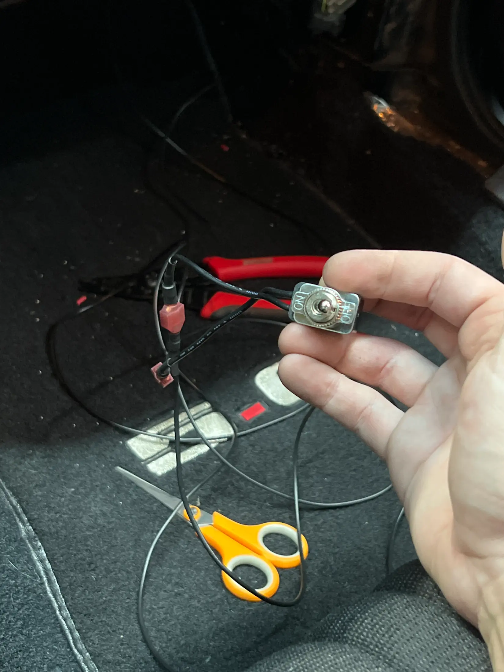

I cut the wire and spliced in the switch where I showed I was in my previous posts and it still starts and runs the same with the switch on or off…
Anyone know what I’m doing wrong here
This is what I did

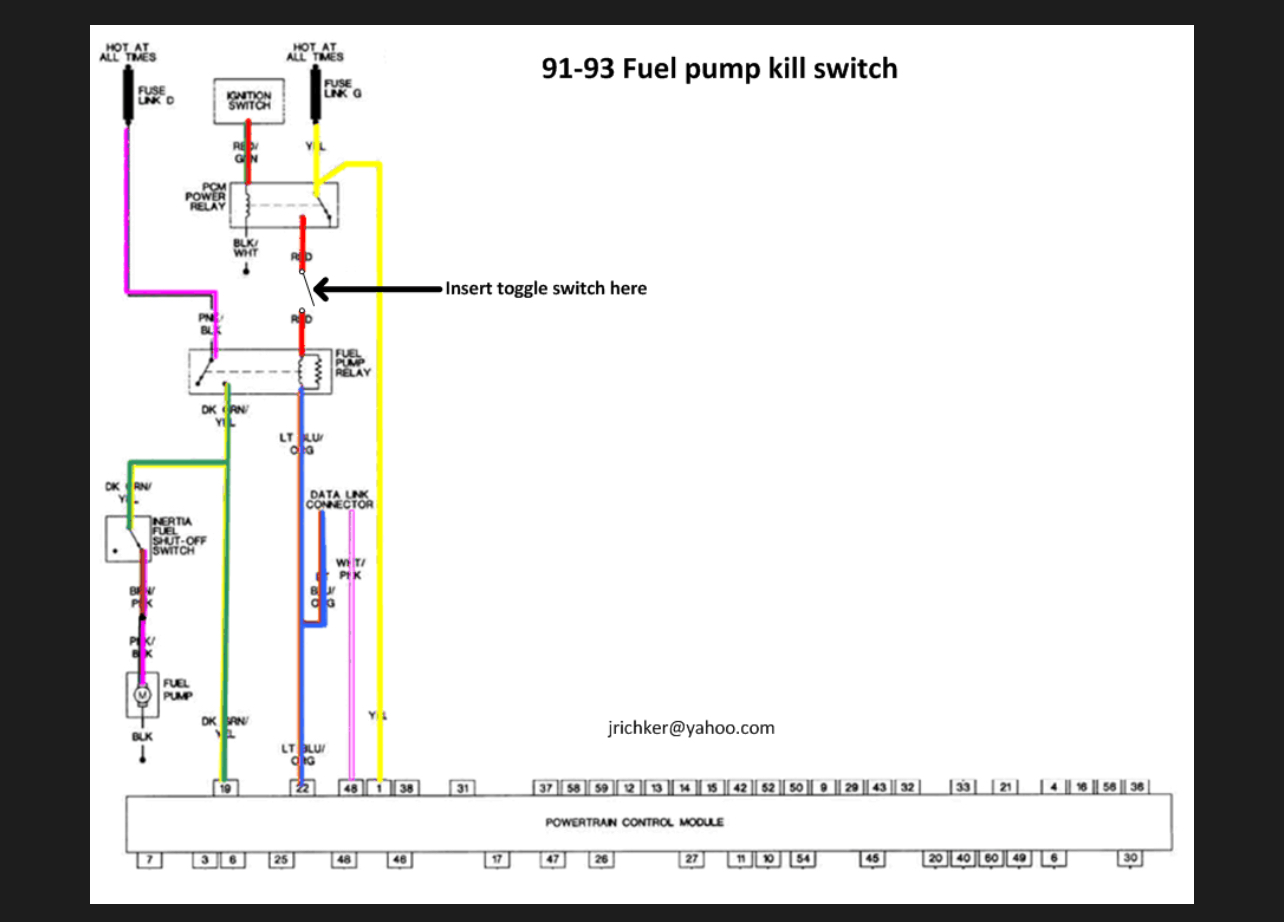

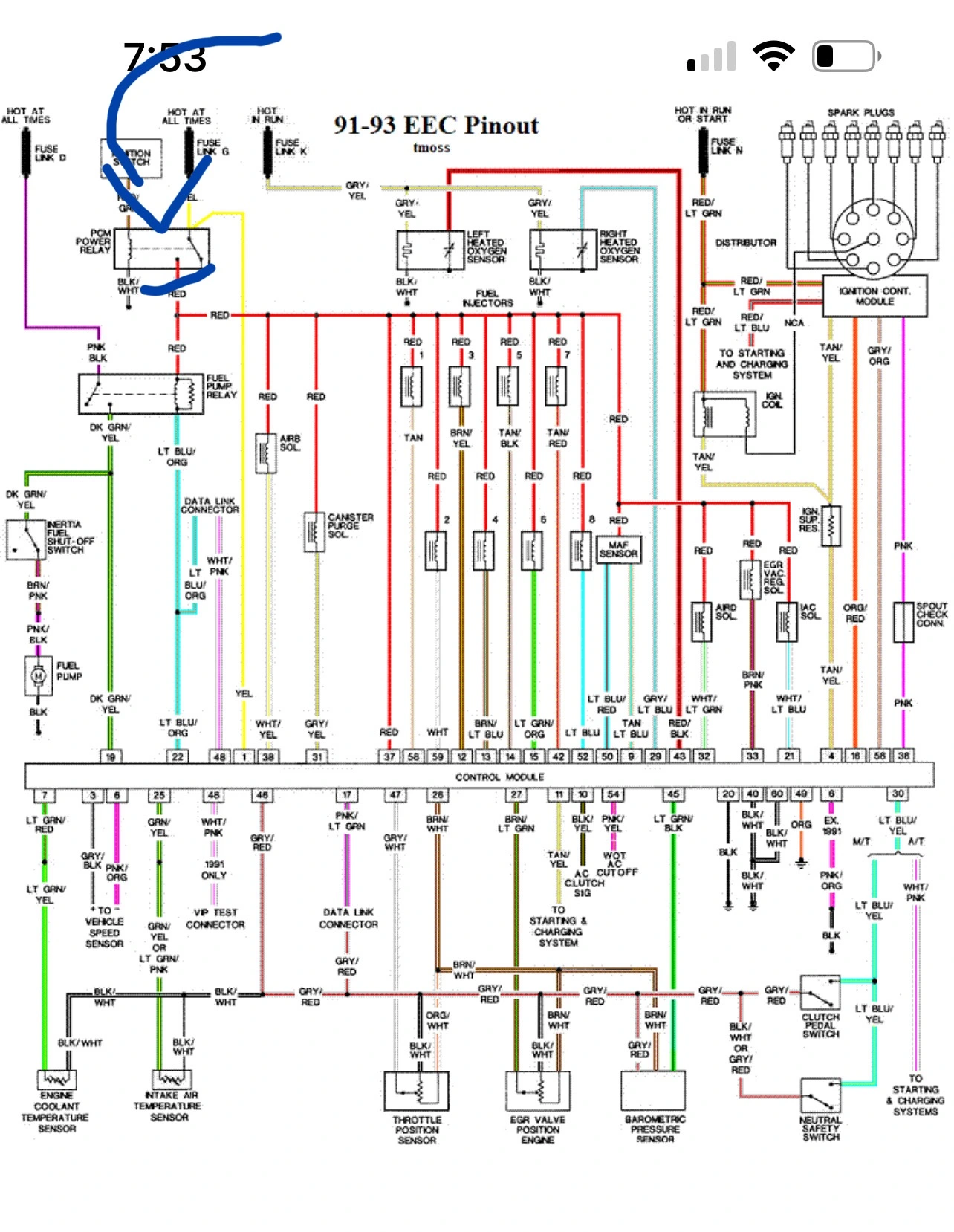

I’m looking at this diagram I found of foxbody wiring. i suspected maybe that switch was bad and was stuck on all the time. I disconnected the wire so that the circuit is completely broken and the car ran fine. I don’t understand how my car could still run the same and everything works being as though I cut that red wire….
