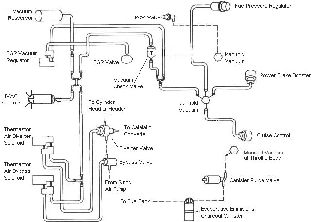

sounds like a vaccum leak to me.make sure you have on all the proper gaskets when installing new parts. and check for work or cracked vaccum lines.
this should help you locate the lines for inspection.
