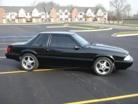

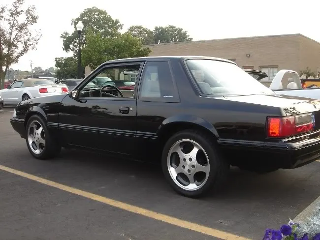

I don't know if they wetsand or not. But your paint sure is gleaming! I've seen close ups of your car too. Wet sand, or not, they did a damn good job, and it looked like there was no orange peel. You prolly found a Maaco that cared about their rep. There is 1 Maaco around here like that. I think they did a great job on your notch.

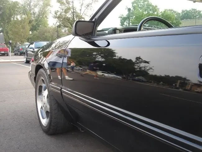

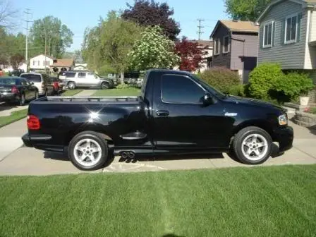

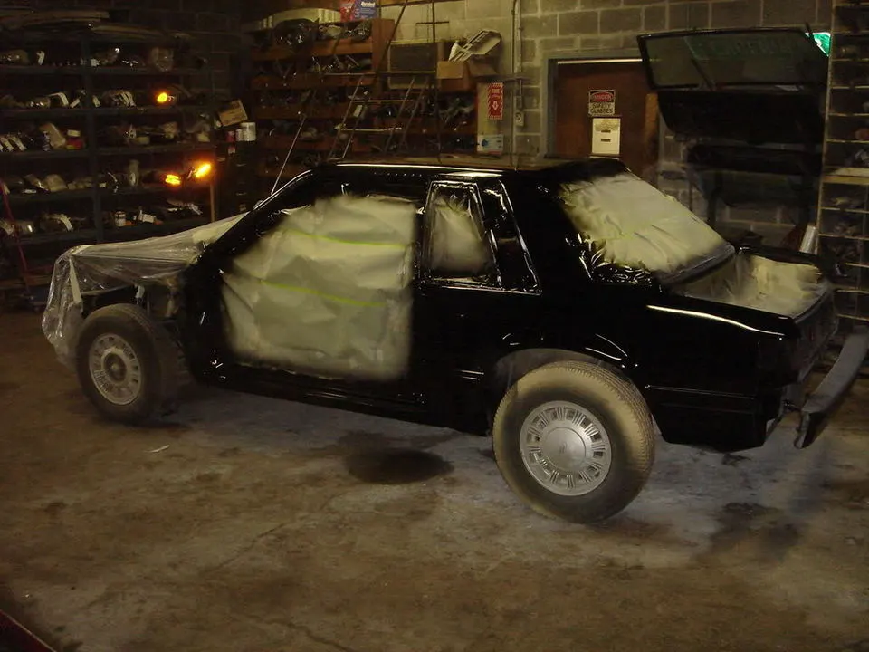

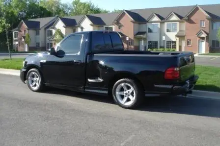

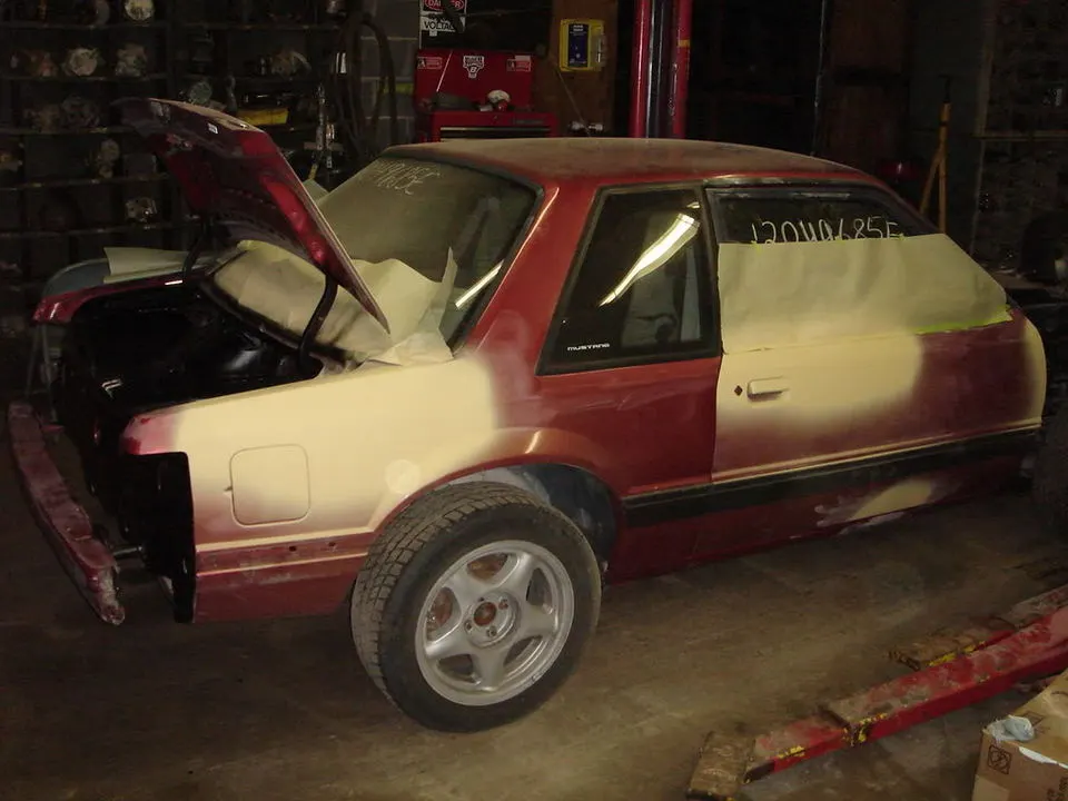

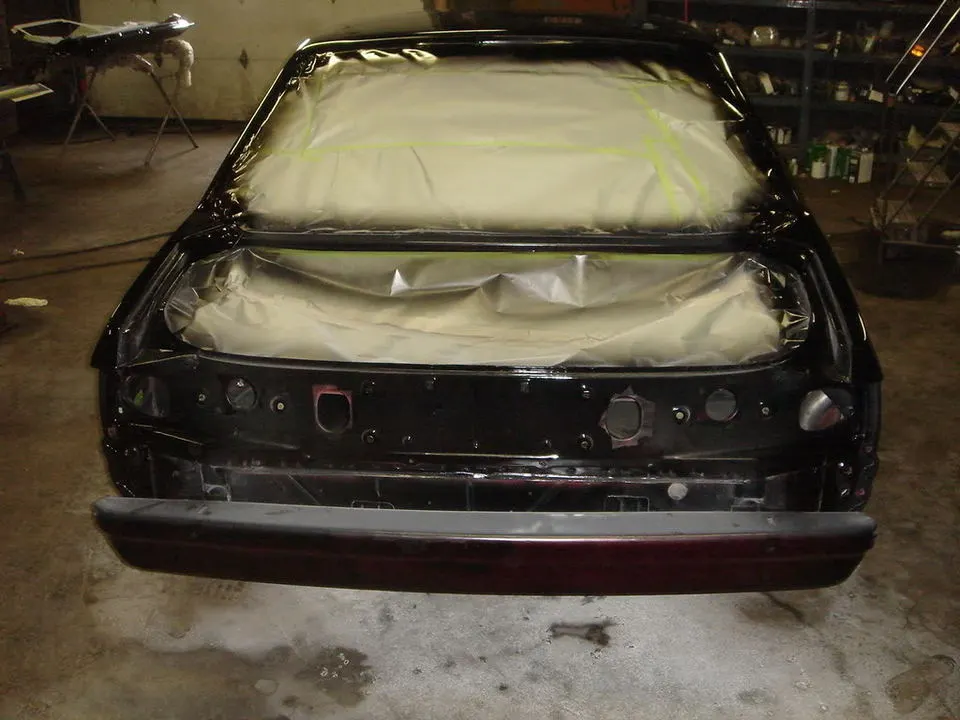

Yes sir!! IF you paint black, go with bc/cc. Single stage black, will drive you nuts when you go to wet sand it, because it will show EVERYTHING!! The clear is a little bit softer so it wheels out very easy. The trick to black, is get it smooth before paint. If you don't use a sealer, I would lay down 3 coats of paint, wetsand it with 1500, lay down 2 more coats of paint, then clear it. It will turn out excellent. BUT...I highly recommed a sealer because it fills in all scratches, and will not allow the paint to shrink, or any primer to eat through it. If you use a sealer, there is no need to wetsand the paint before sealer, and no need to wetsand the sealer before paint. I wish I knew about sealers before I painted my black notch. I just painted over the yellow primer and the maroon paint. It took a lot of paint to cover it.
I then assembled the hood, doors, fenders, and painted those on the car, but I have pics at my parents. I painted all the bumpers and moldings off the car on stands. I have no tape lines on the car anywhere.
