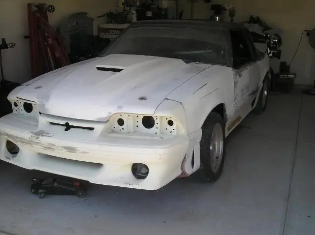

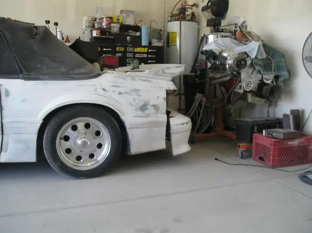

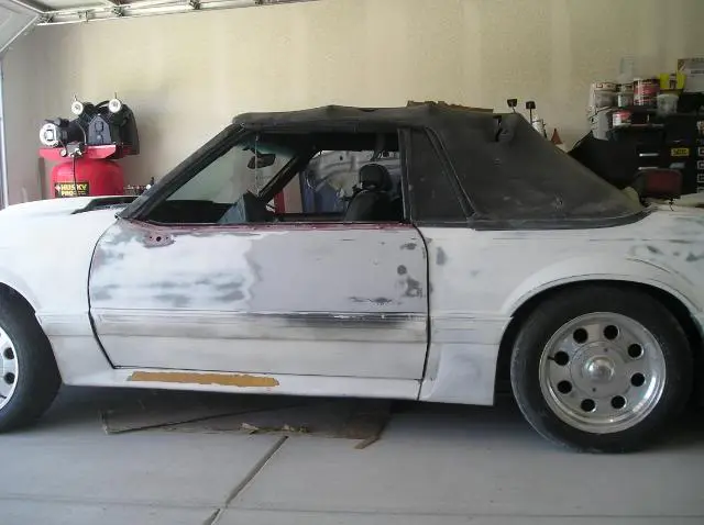

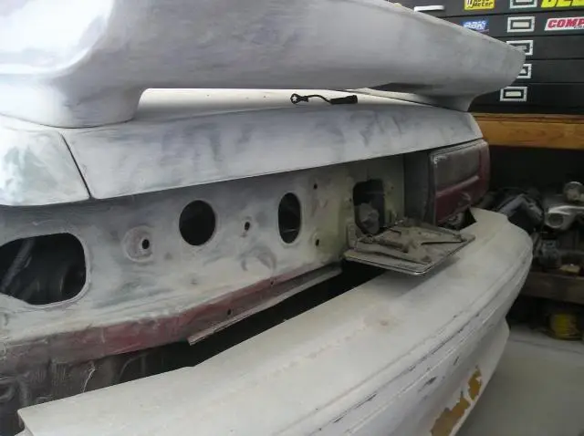

put up some pictures of your current stage now of your mustang. Yes i think that will look unique. Here is my stang at the moment.......

Thats a bad ass car.TimThank for the pictures

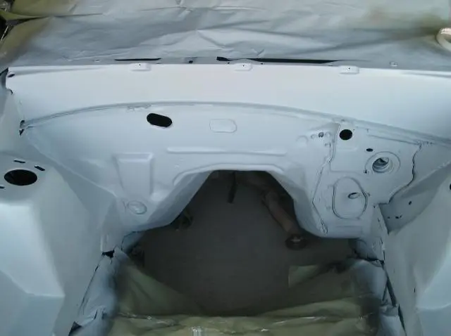

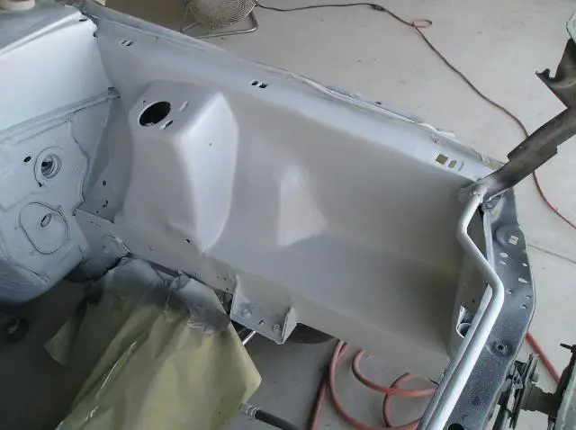

Got my paint and clear today. Just need to get my sealer.. Now I have a question. If I take my doors, hood, trunk of to paint my jams and engine bay and paint those items seperately off the car will the color match after i put them together? I don't want it to look like it was painted at different times,like two different shades. Should I paint the jams and insides first them let them dry and another day paint the whole car together as one?Just trying to see what the easiest and best way of doing this. Thanks

The car won't be a different color. 99K black is 99K black. I would paint all the jambs, engine bay etc...one day. Then assemble it, tape off all that stuff so overspray doesn't fog it all up. Then tape up the outside of the car, and paint it as a whole. Hanging painted parts is nail biting. New paint is soft and could possibly chip if it hits something. I hate hangin parts after paint....gets me nervous. I painted my black notch like that, and I painted Hack Job as a whole, and I gotta say that was much better, and faster.
