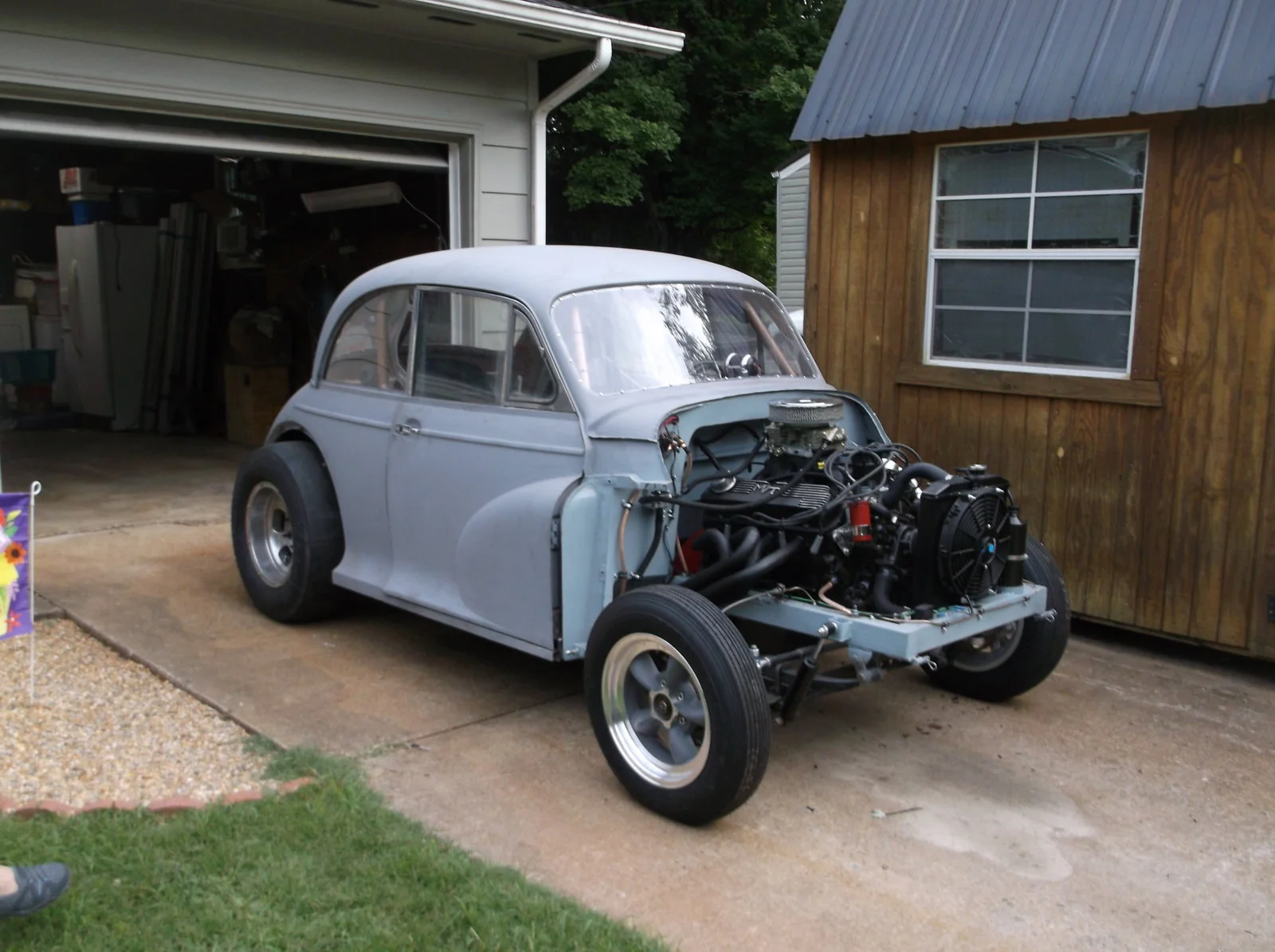

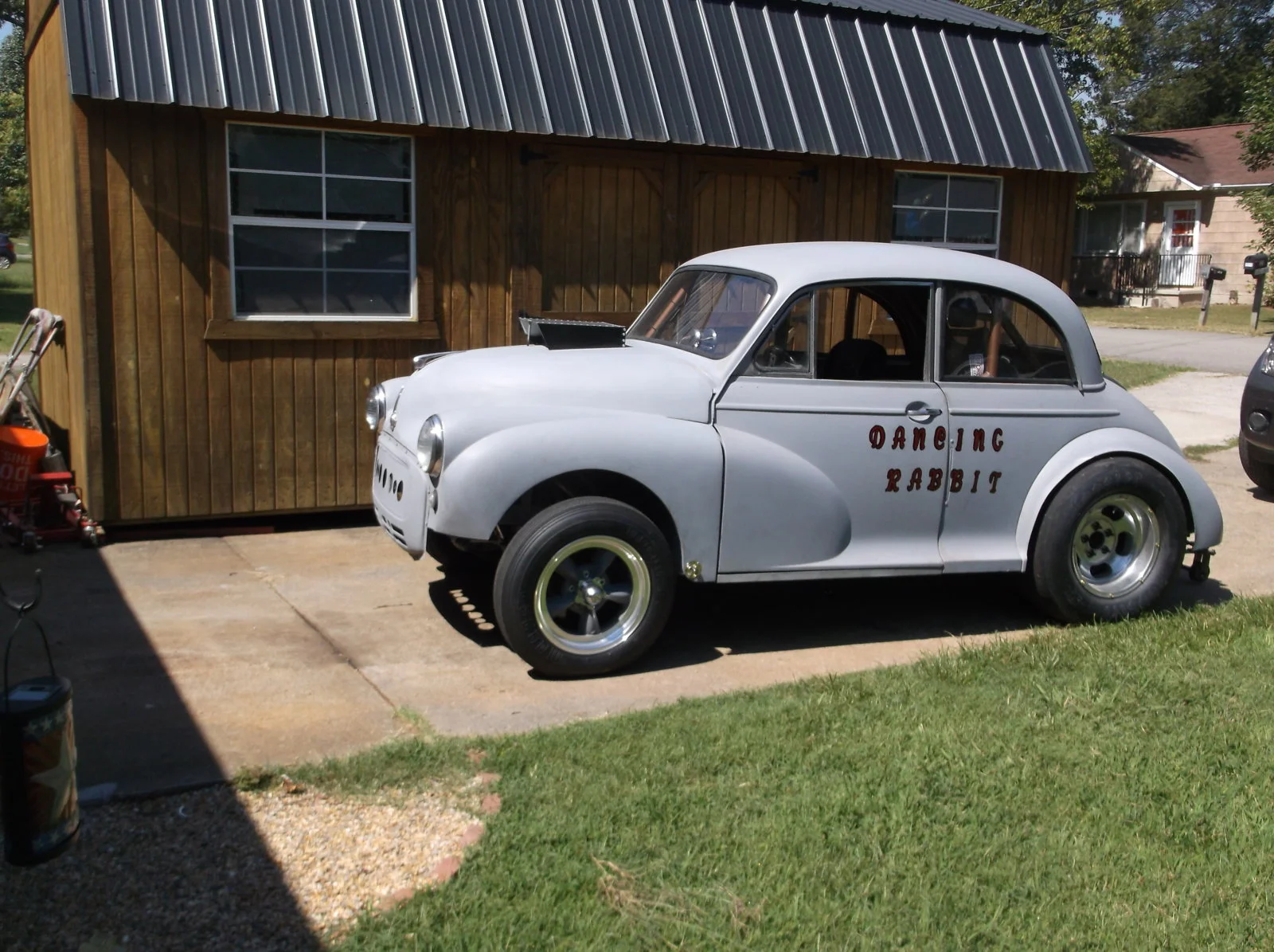

small block Windsor in a Morris Minor Gasser

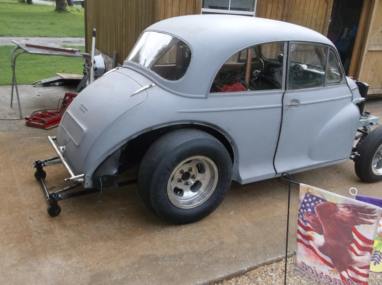

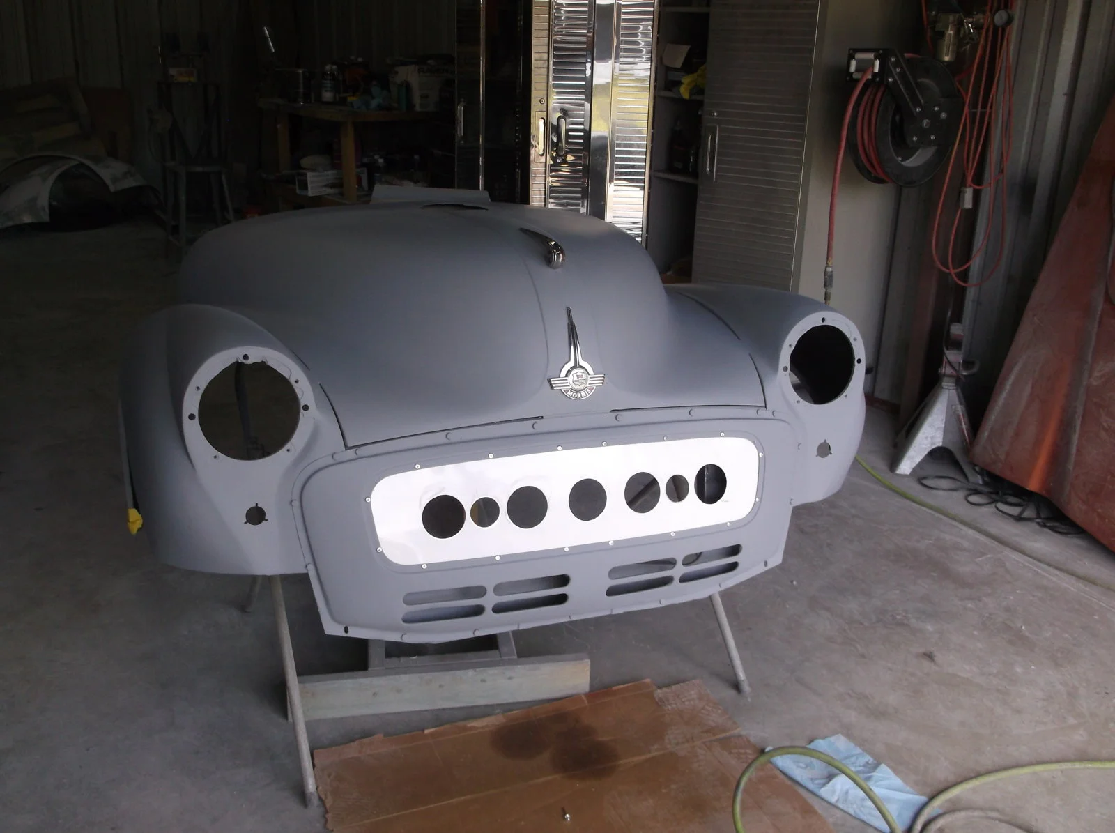

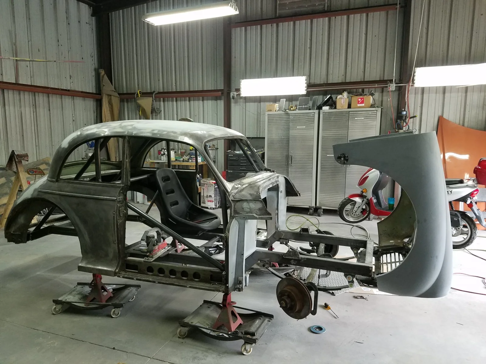

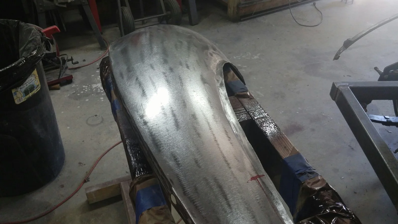

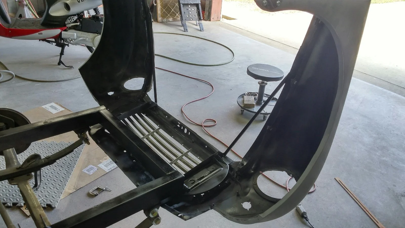

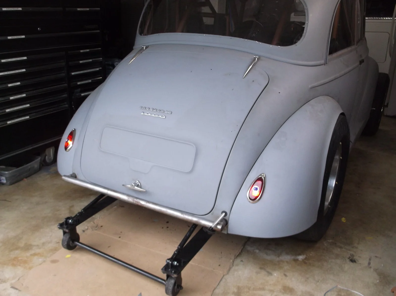

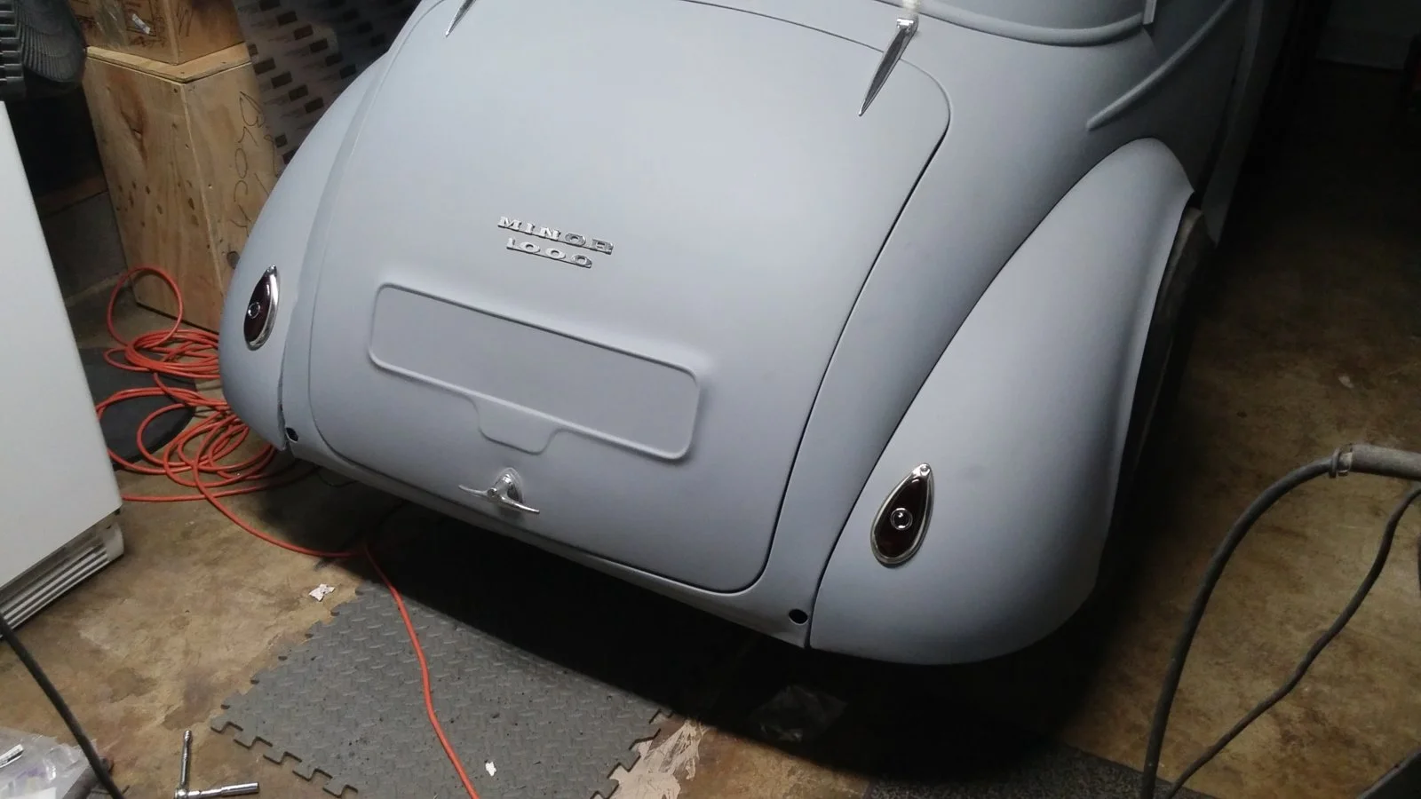

Some more pistures of the car being built here is a picture of using my bead roller to flare the rear fenders. Works great when you have removable rear fenders. could be used on front fenders. These will be just random photos.

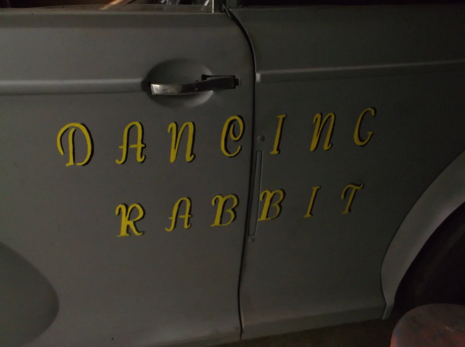

The story behind the " Dancing Rabbit" name is my wife collects rabbit figurines and she said that thing looks like it should hop like rabbit going down the track.
So, I thought dancing rabbit sounded better than hopping rabbit. dancing Rabbit sounds like it is more under control.

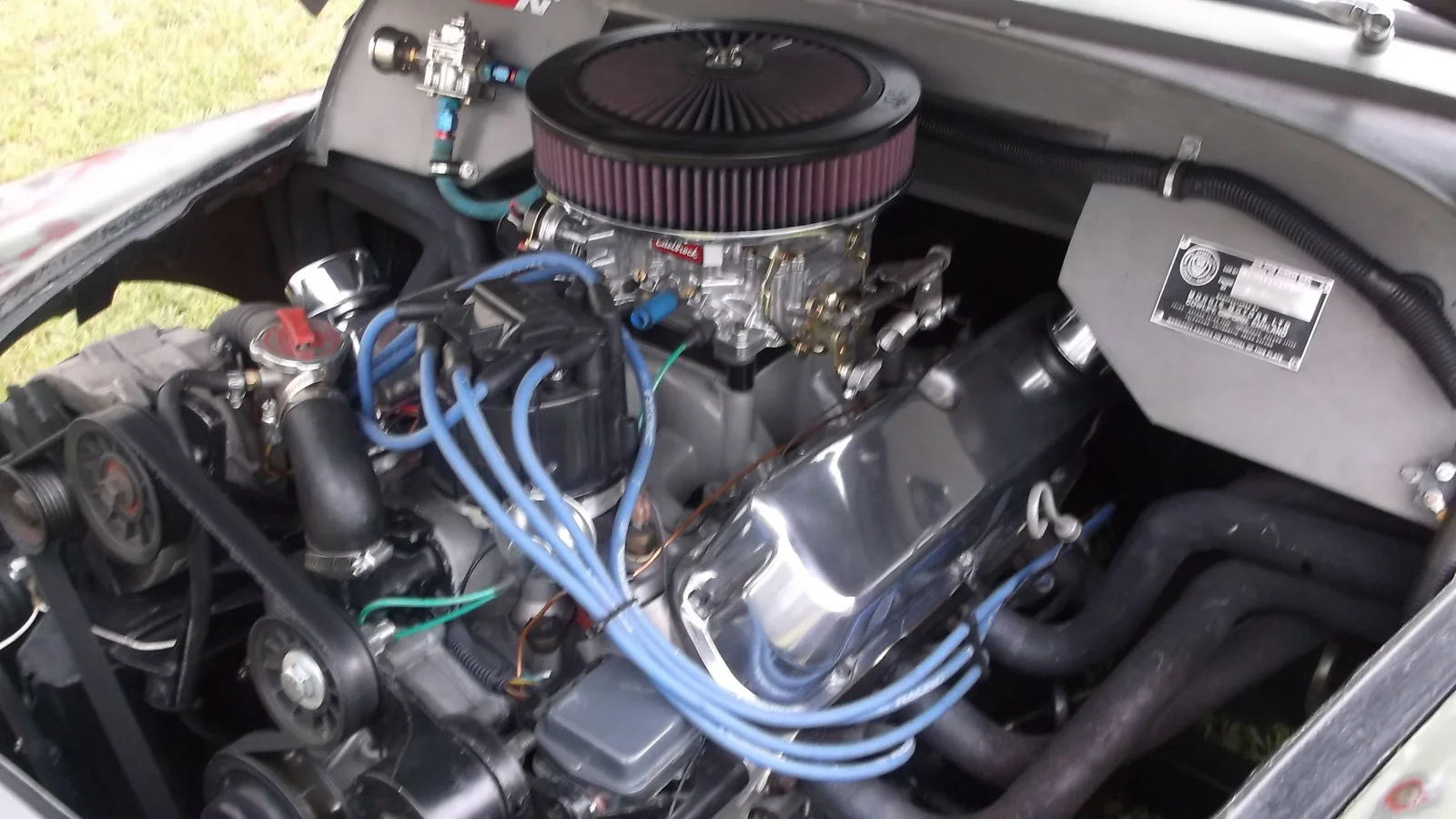

I am in the process of getting ready for the 2020 season with a new 12.0 to 1 333 inch stroker and a new cam. Should give me close to a 100 hp more than the 307 that I ran in 2019. Also rebuilding my top loader with a new product from Liberty that they are developing for guys with small input shaft transmission's.
The new input shaft will be made of 300M steel which will resist twisting . A common problem with small block top loaders in cars that hook up on slicks. Mine lasted 3 passes before it twisted.

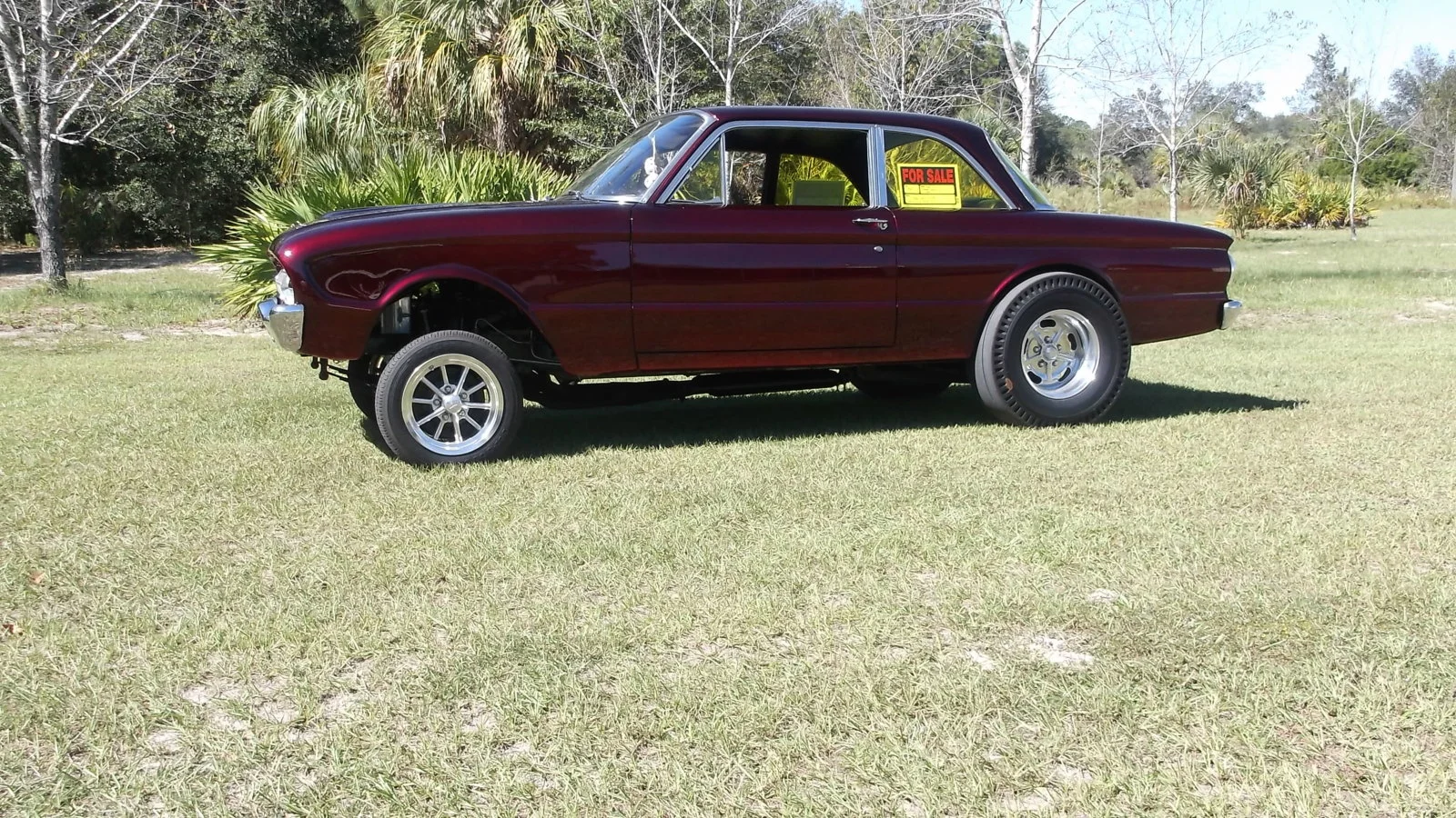

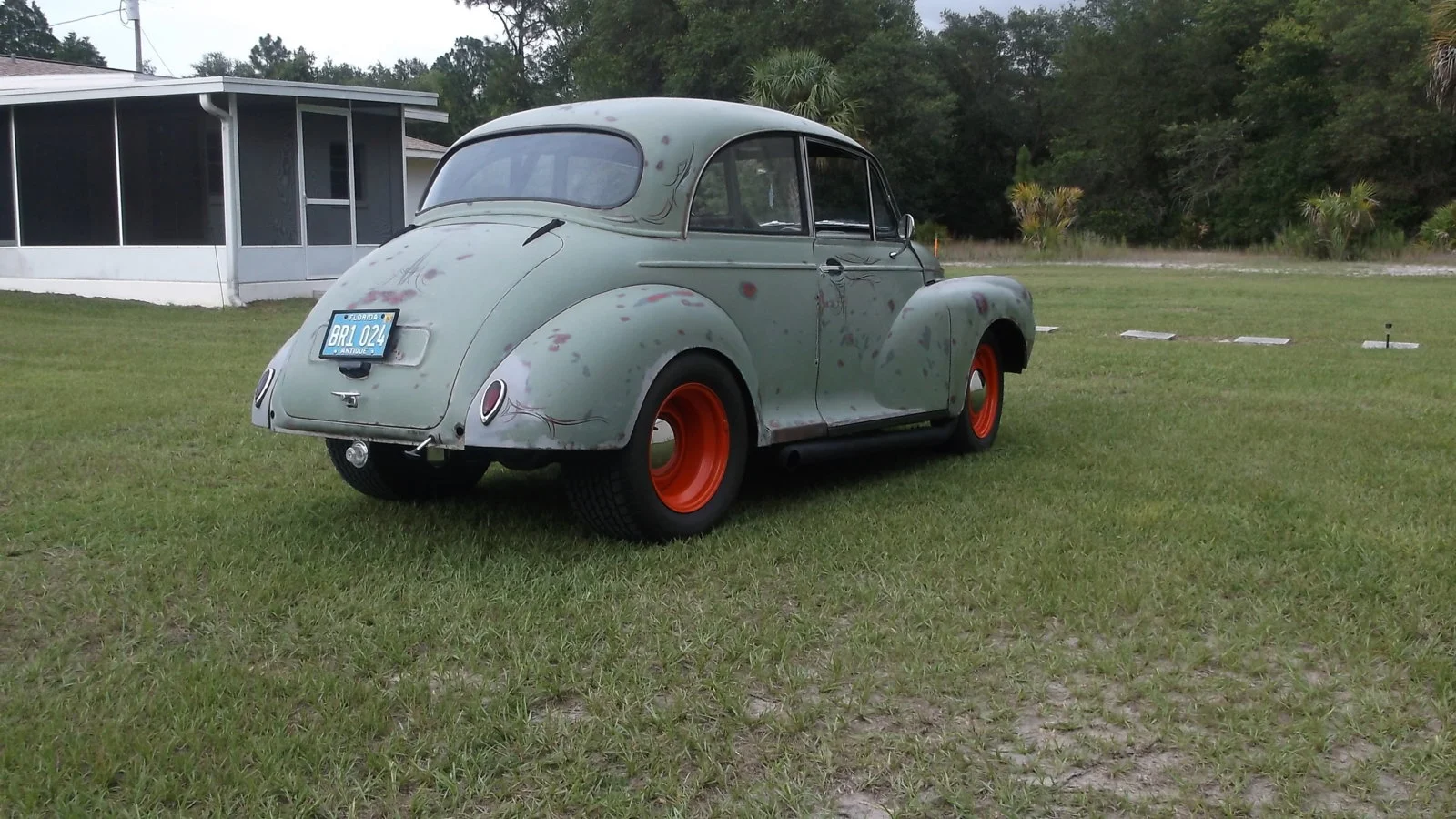

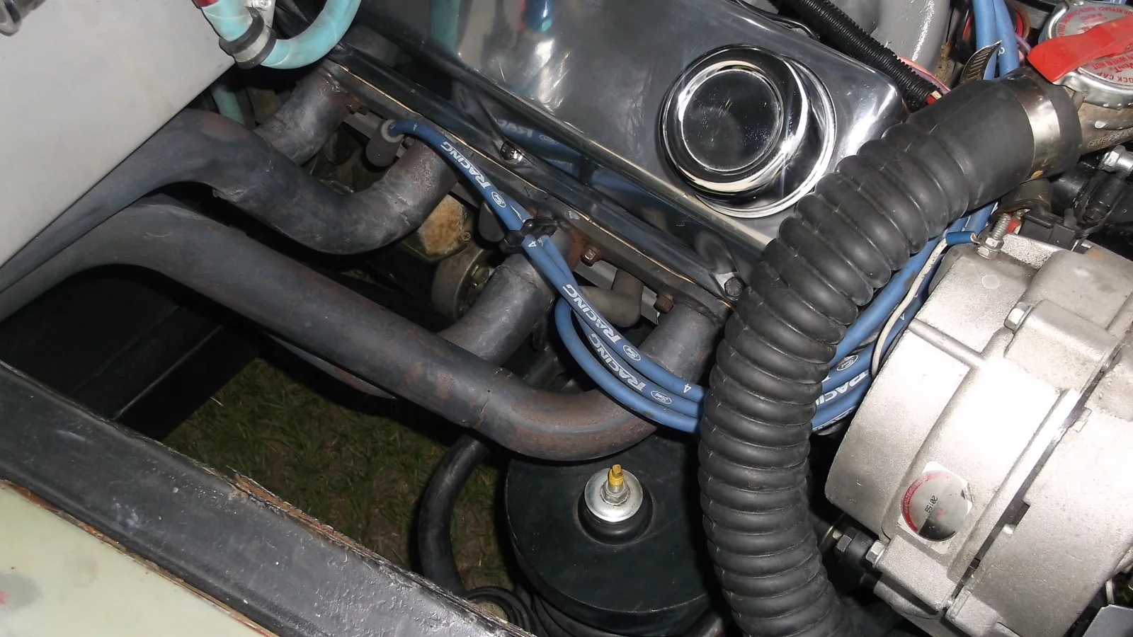

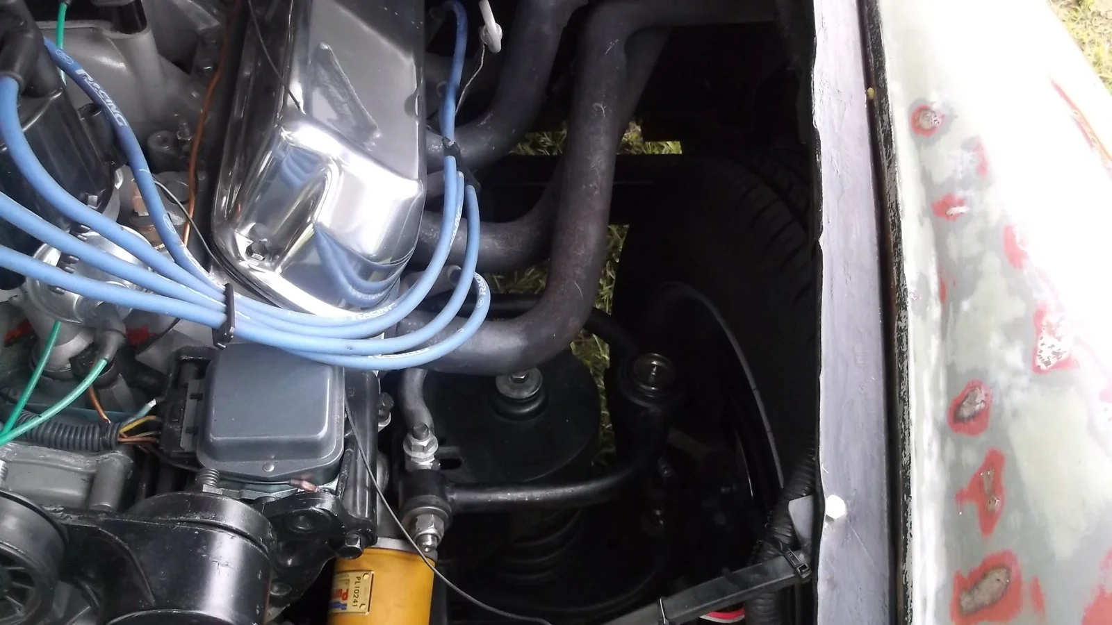

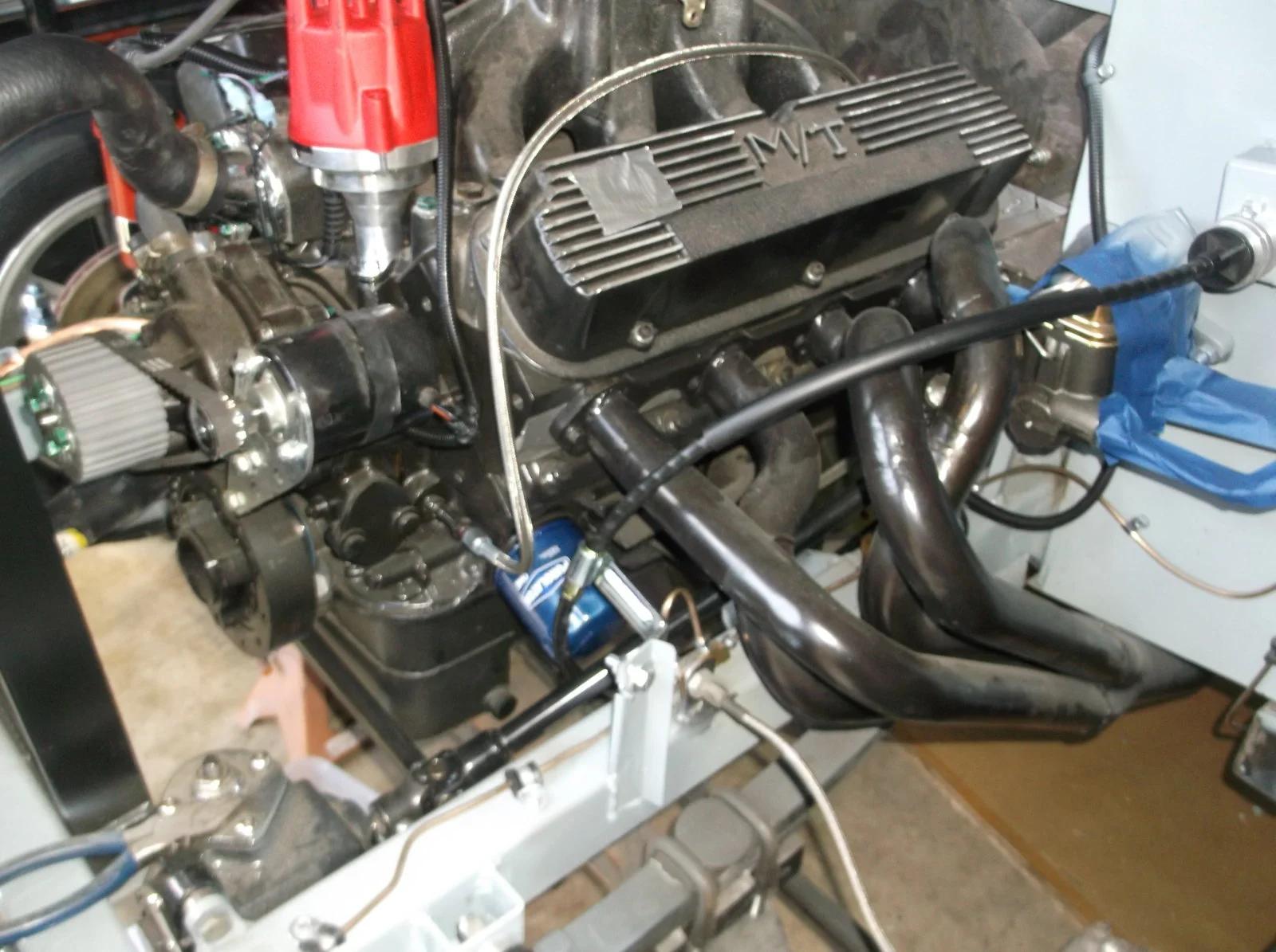

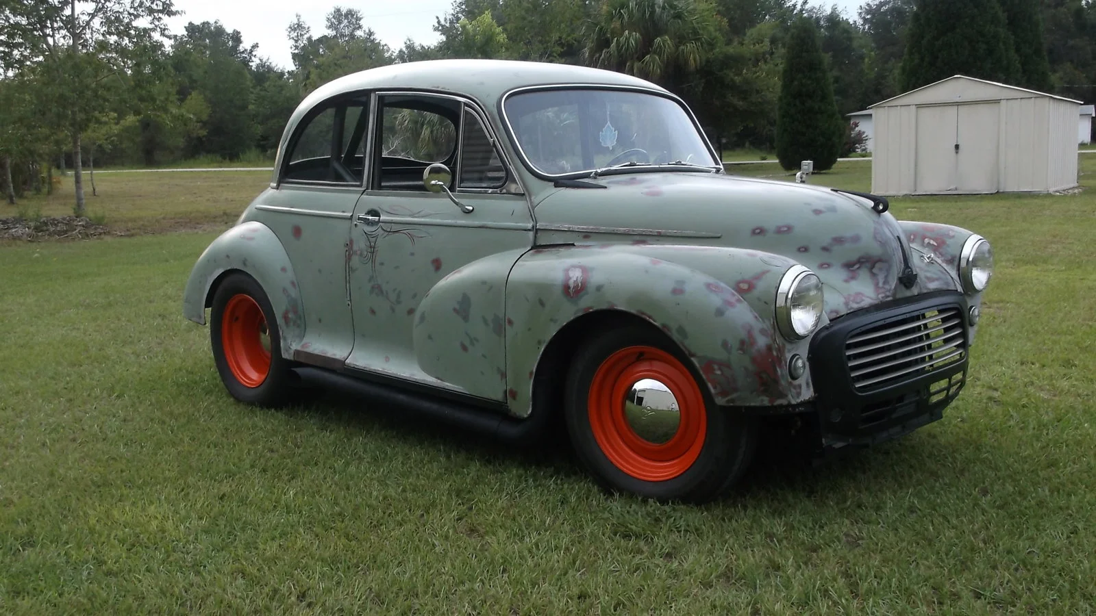

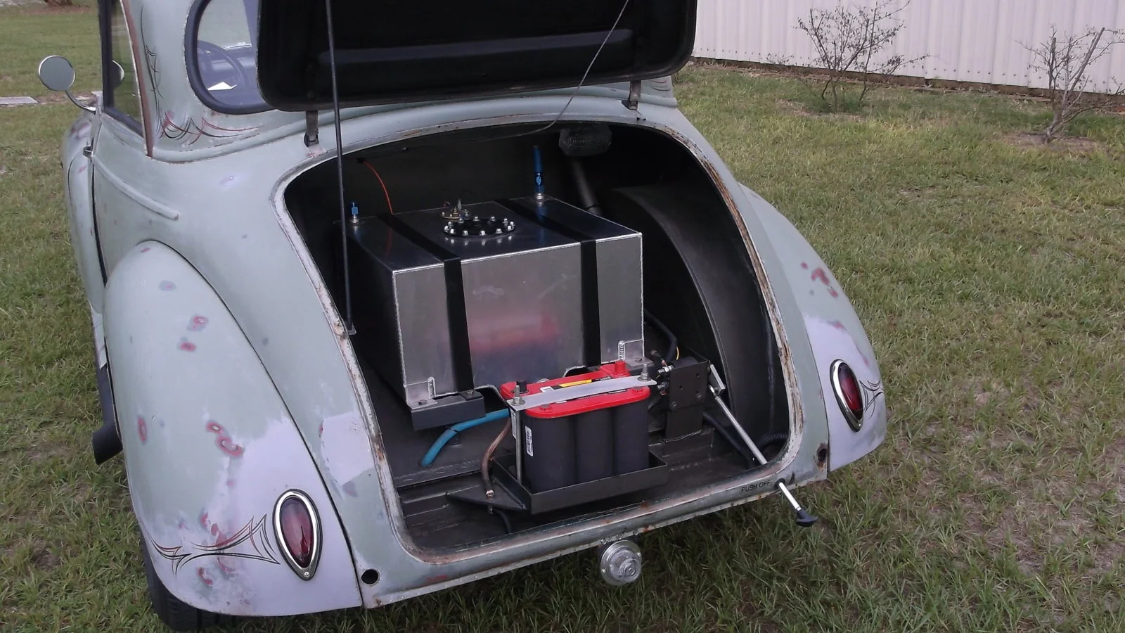

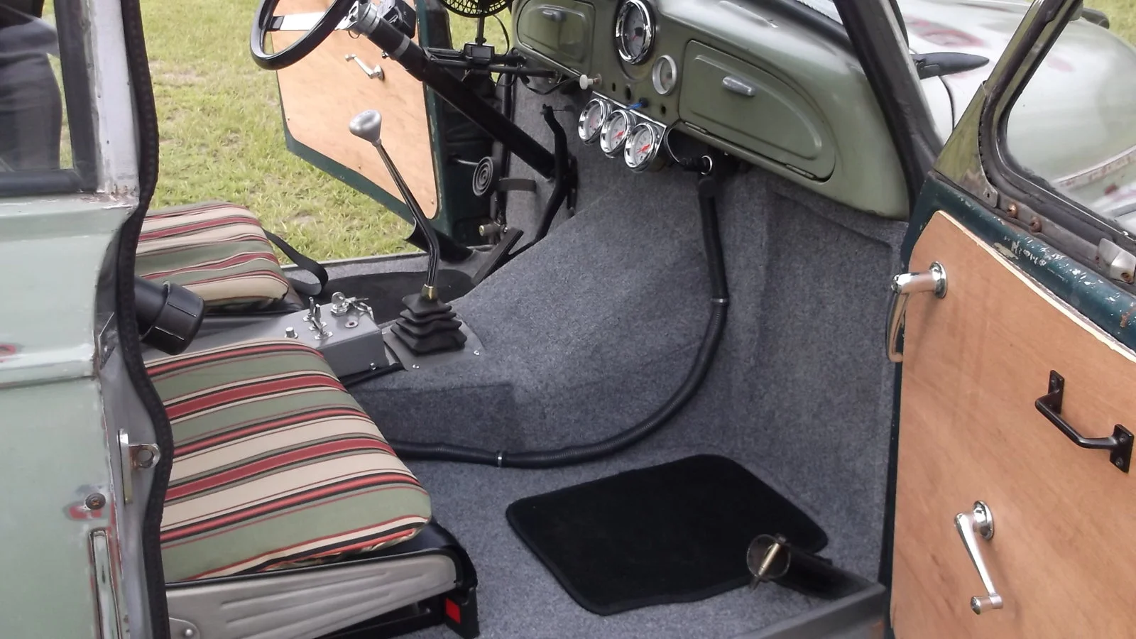

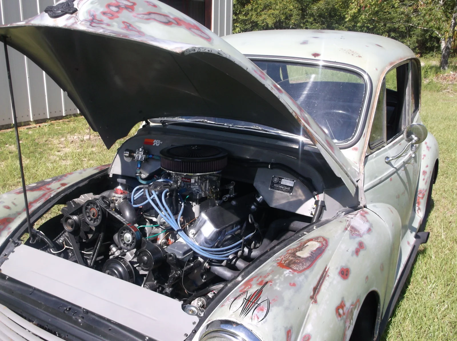

Here are a few photo of my old pro street Morris Minor that ran a 5.0 with an AOD .4.11 gears with a 9 inch. 2300 lb street car. Mustang 2 front suspension.

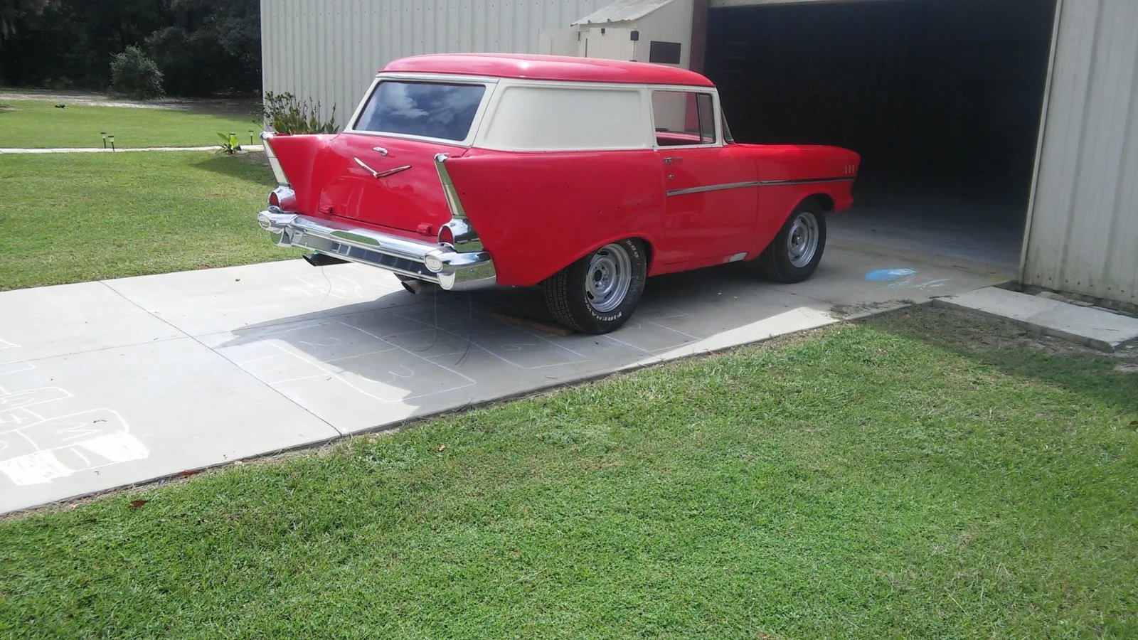

Speaking of Tri-Five wagons, what's with the shorty 57? A 4 door that the doors got cut out or was it a 2 door that got shortened? My dad left that old 55 to me, I'm hoping to finally start working on it sometime in the next few years - it's a 150 Handyman....
The pro street Morris used the auger mufflers from Speedway . They weigh less than 2 lbs. and slide into the 3 inch pipes that I ran down the side the car and turned them out in front of the back tire. It sounded like an original Cobra with the side pipes until you went wide open and then it sounded awesome.
you could cruise at 65 down the highway and carry on a conversation with the windows open. It was turning about 2200 rpms at 60 with the AOD and 4.11 gears.

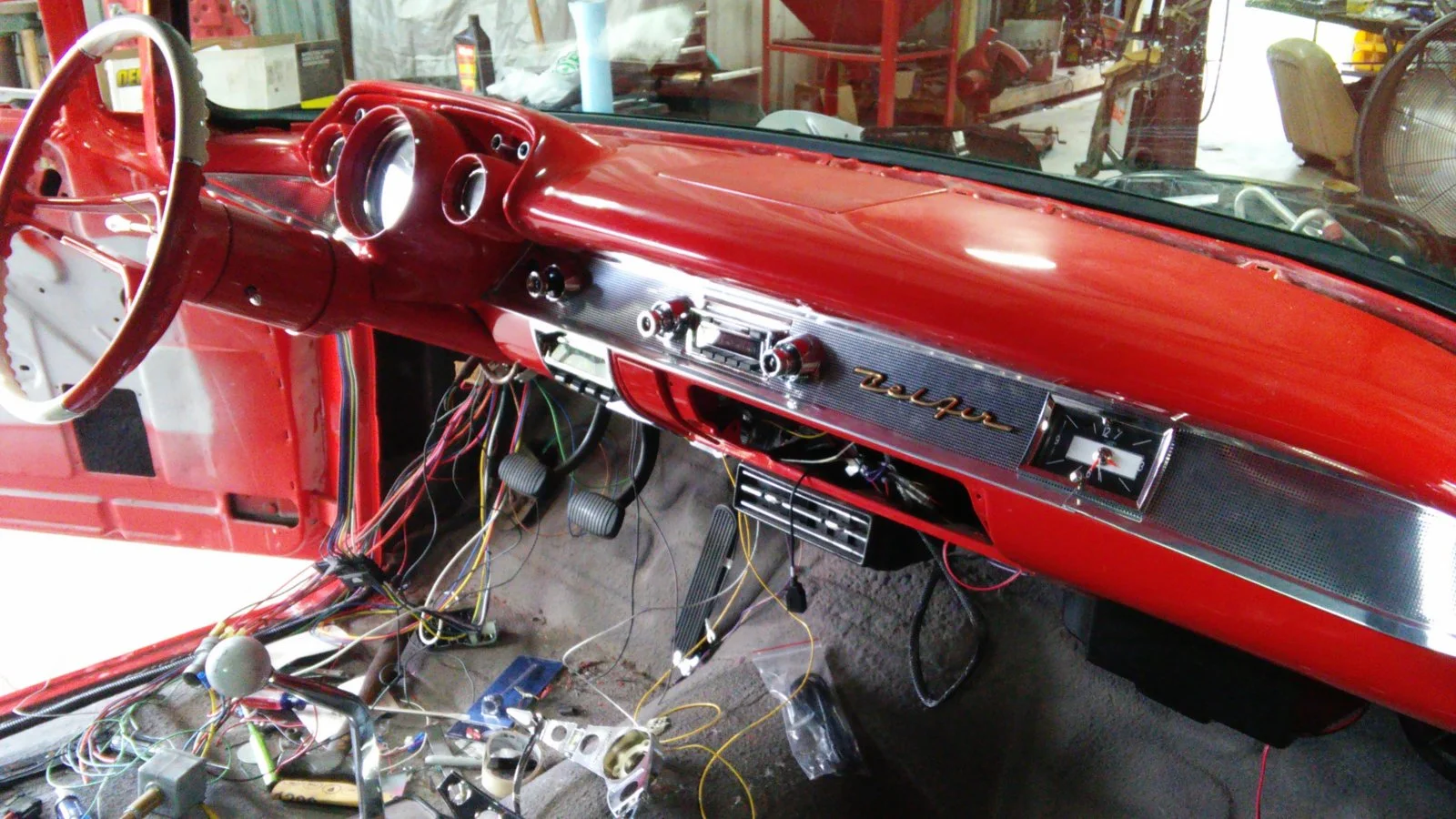

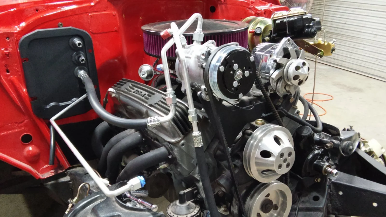

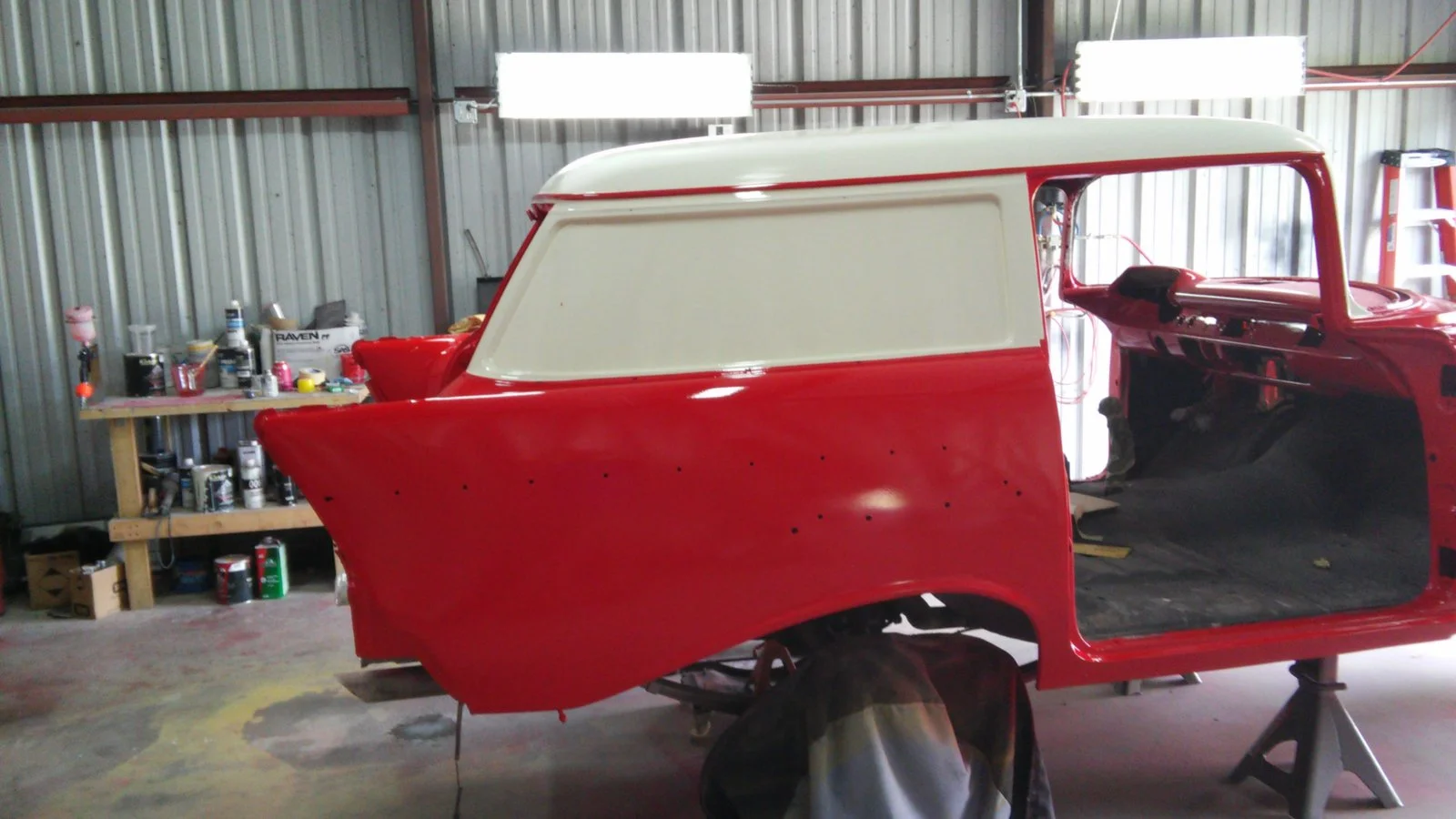

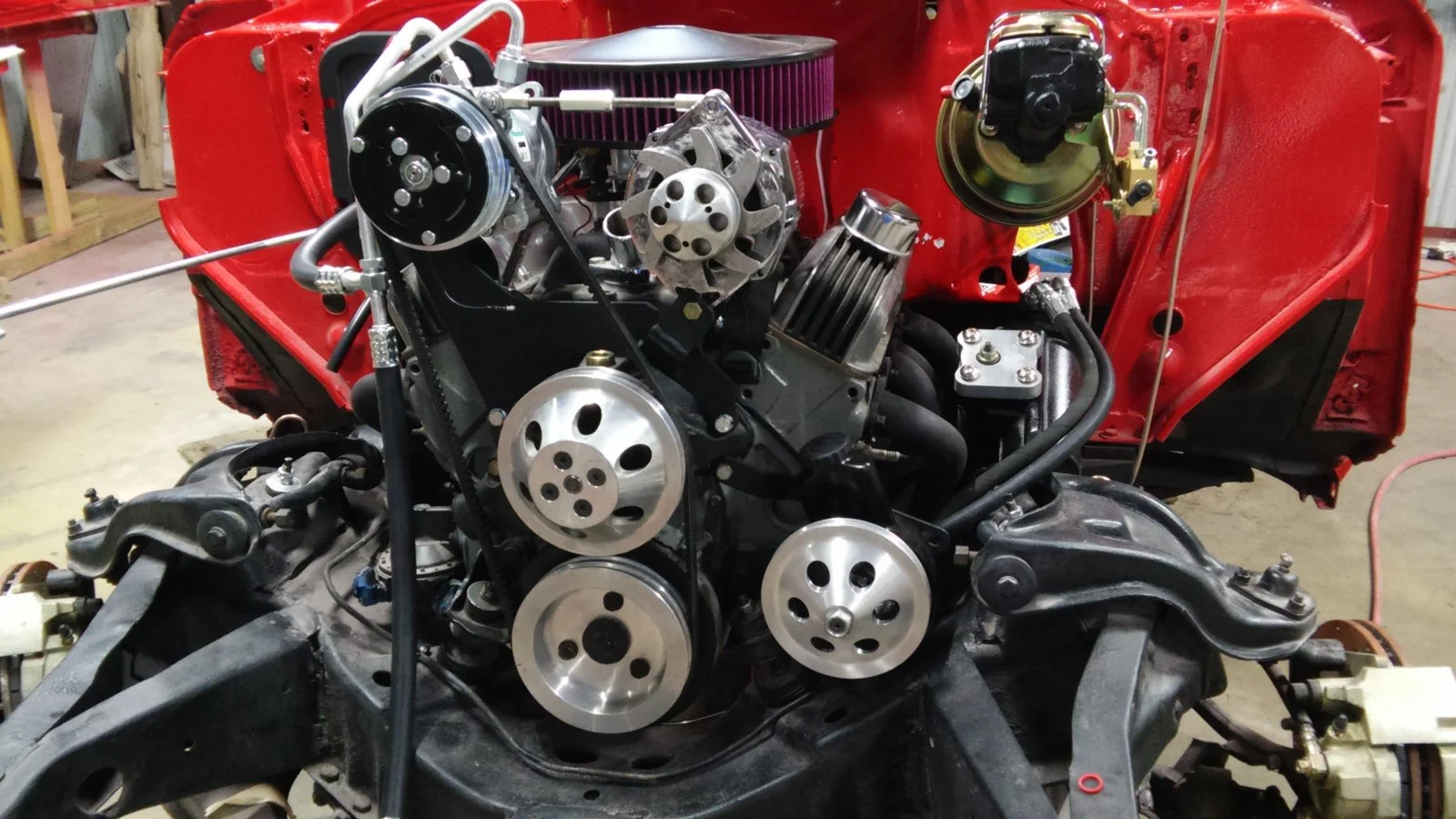

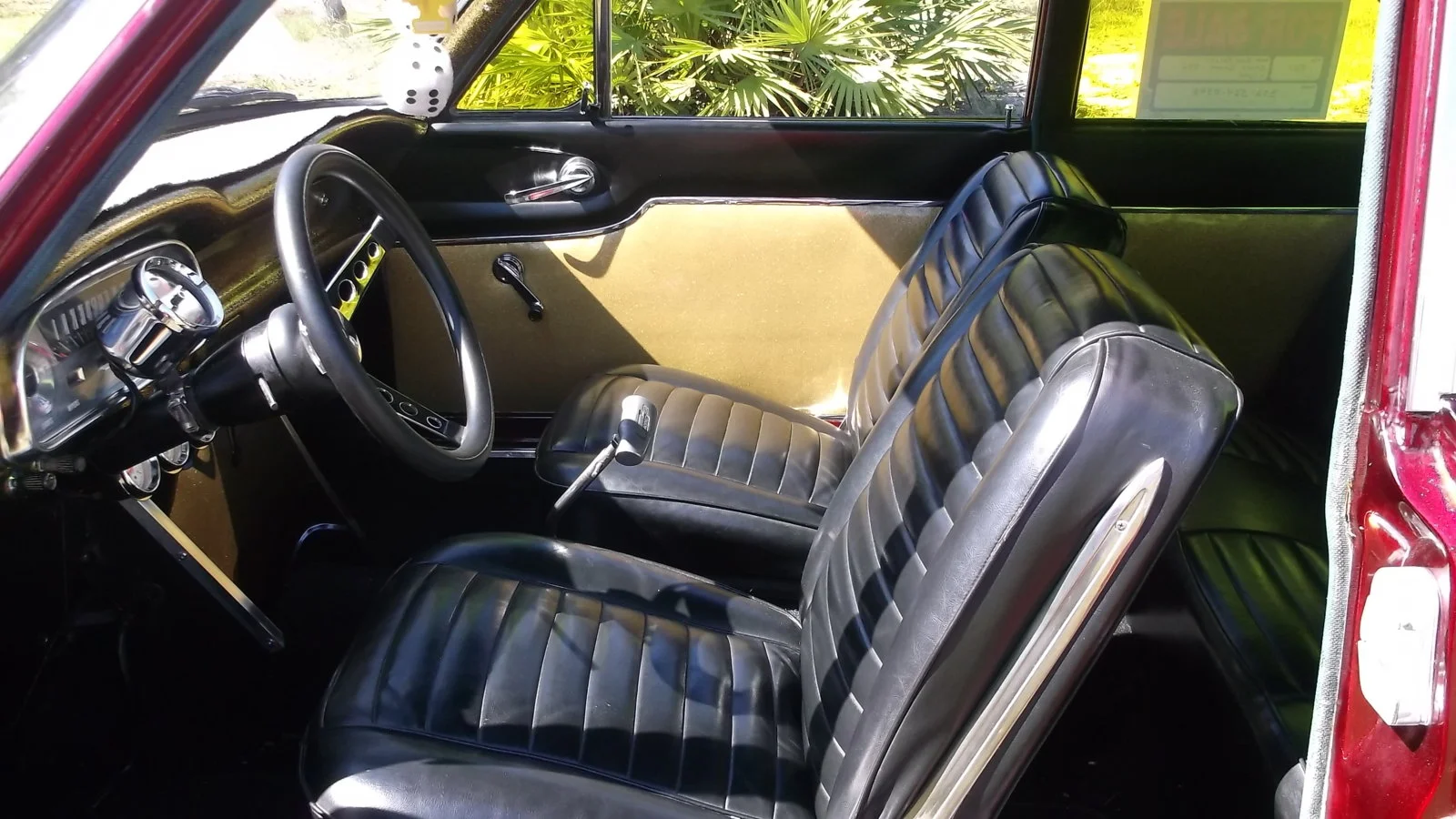

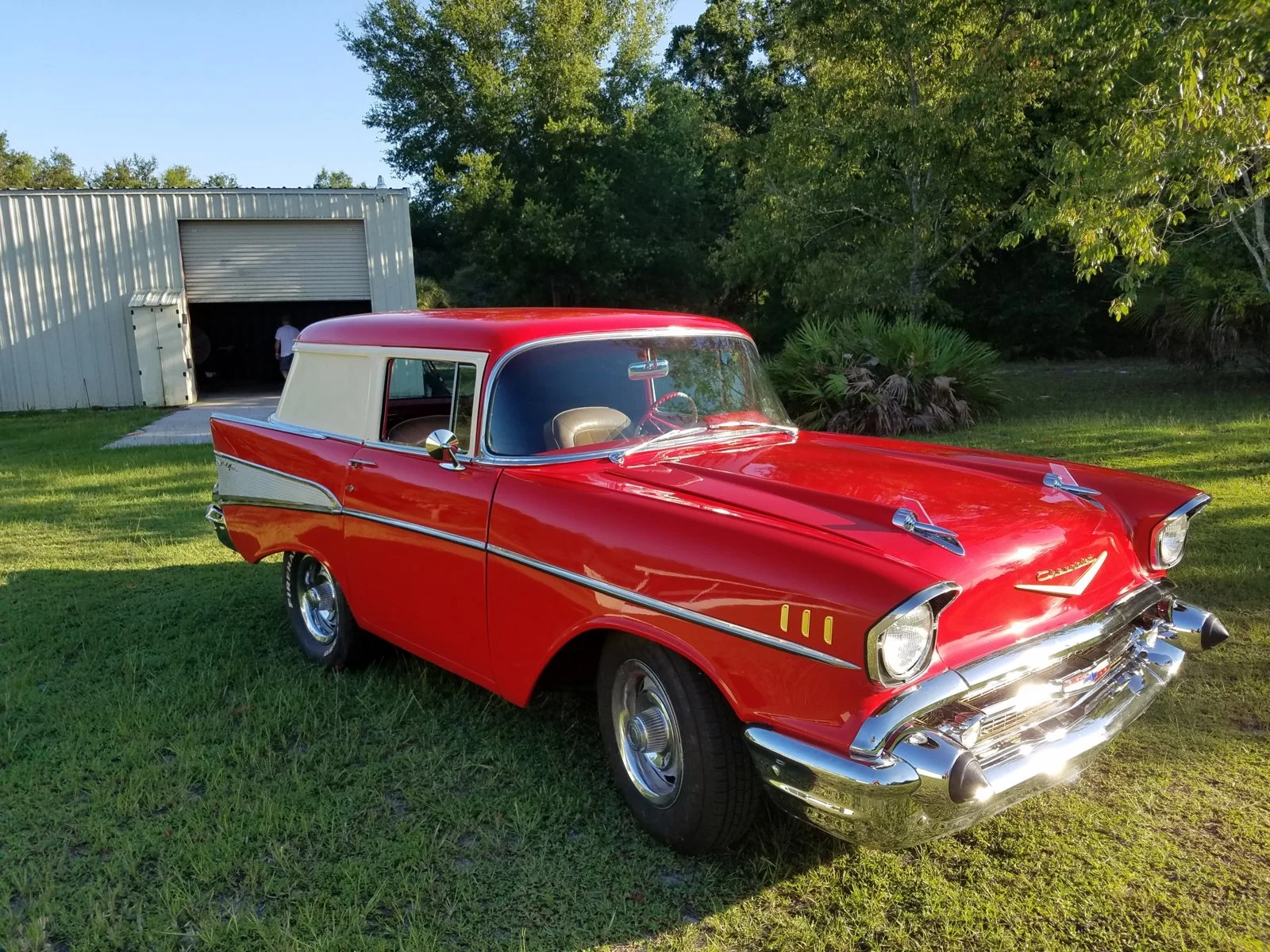

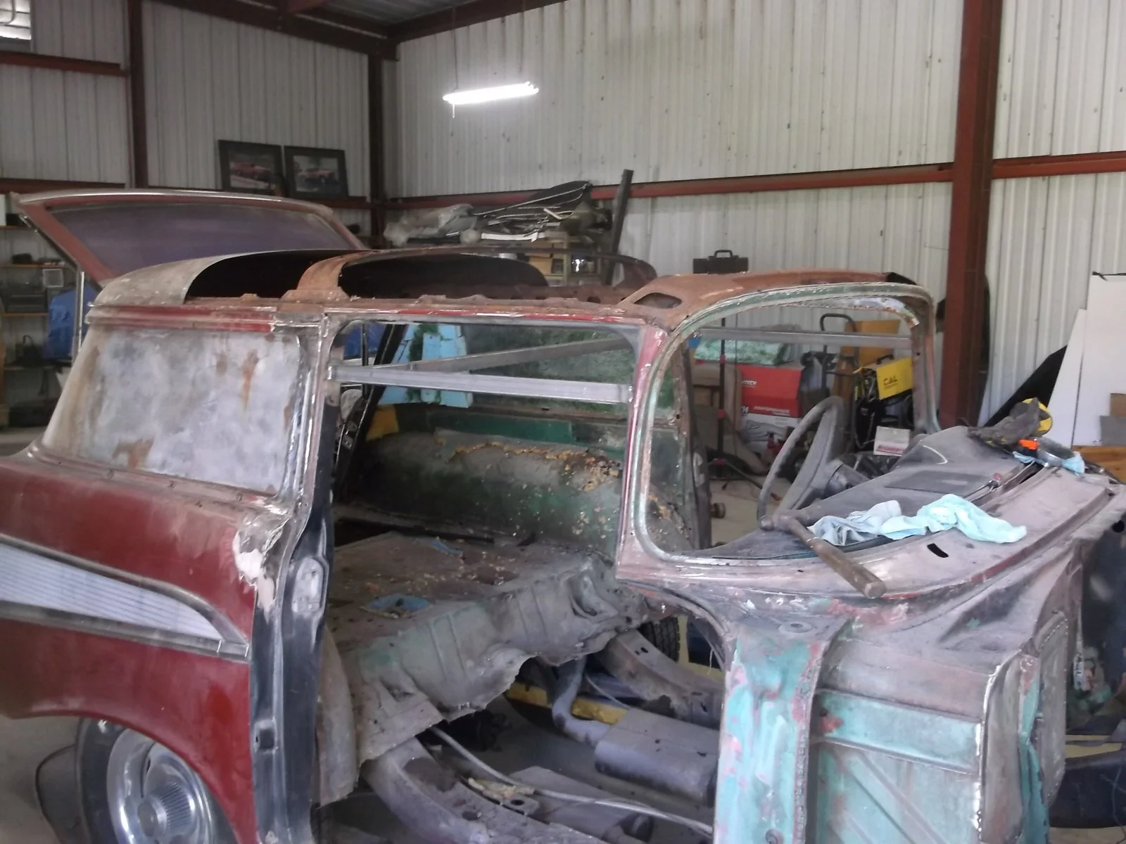

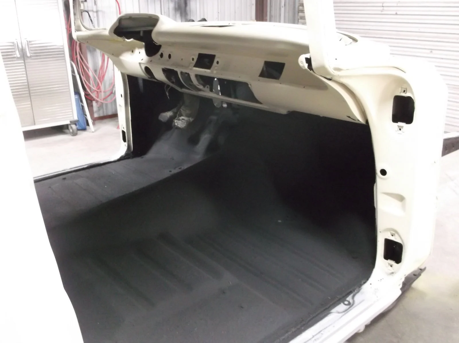

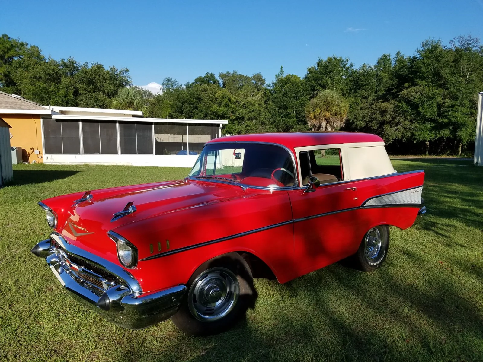

The shorty came to me as a rusted out 4 door wagon and a dream from a customer who's friend had one in high school. The guy was in his fifty's and had hung on to the dream of owning a shorty wagon to use as advertising for his vending company. So I spent 2 years and too much of his money to give him that wagon with tilt wheel, A/C ,power windows, sound system, power steering, disc brakes, bucket seats, 4 speed. With a mild built 350 4 bolt main Chevy.

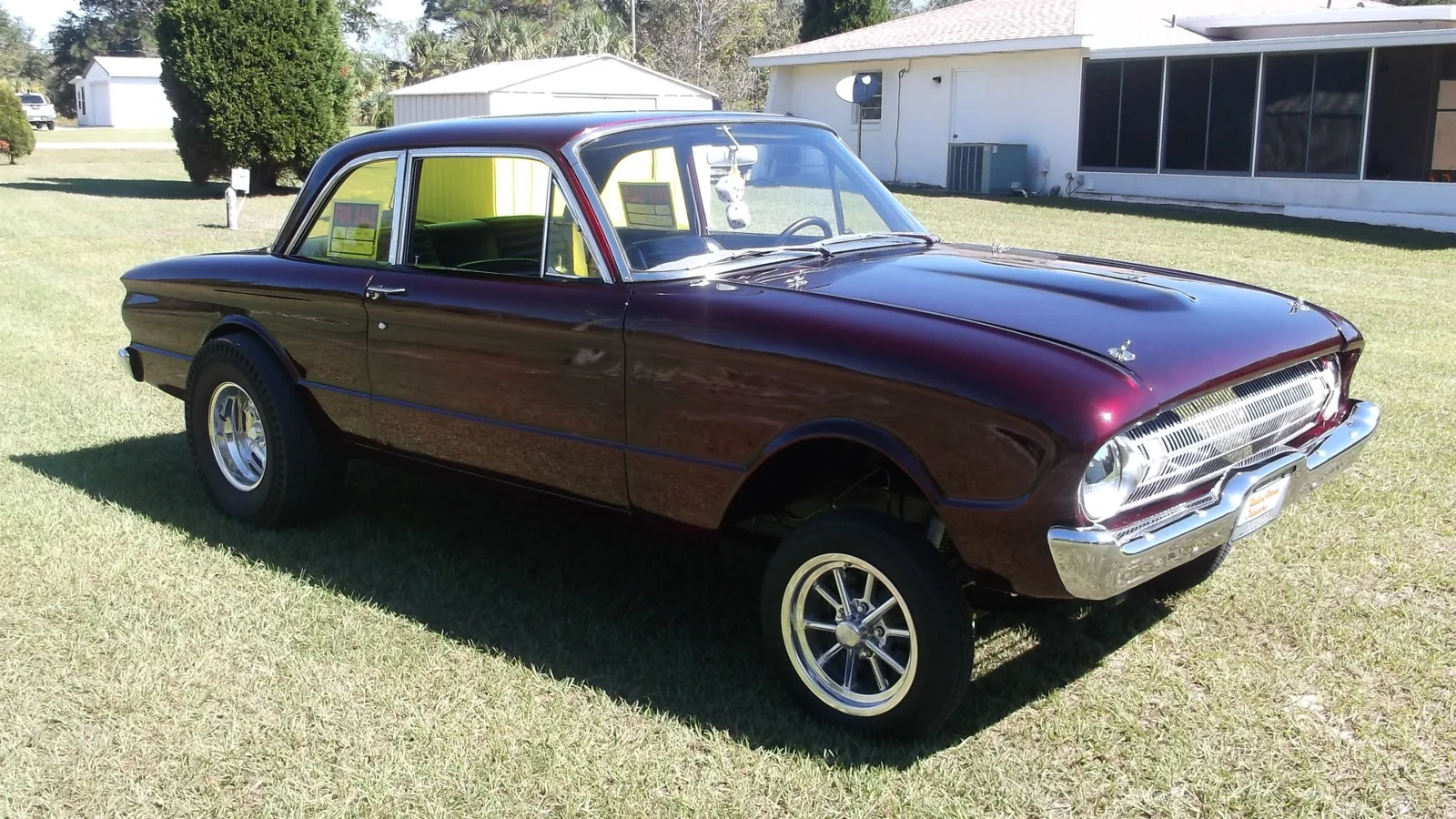

Here are a few more pictures of the shorty and a few of my Morris street car.

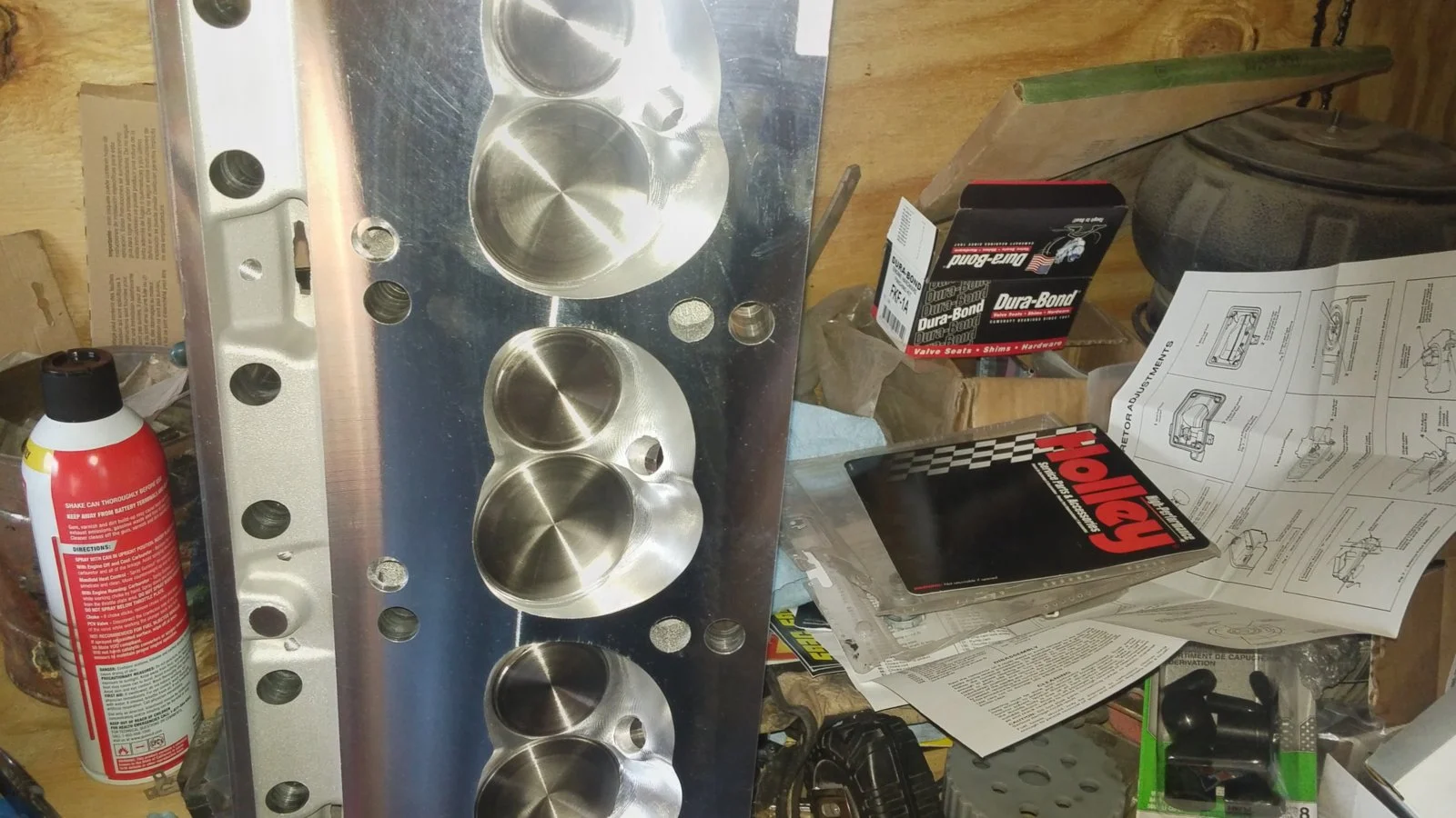

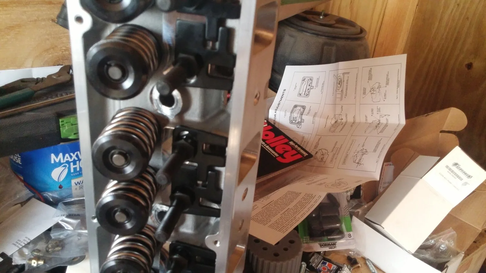

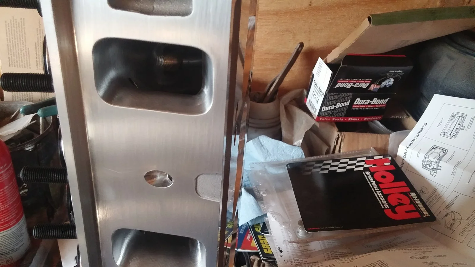

The Pro Maxx heads are great. The machine work is spot on. My car went 7.00 in the 1/8th with a broken rear main cap. after I twisted the input shaft on my top loader and put the crank in a bind.

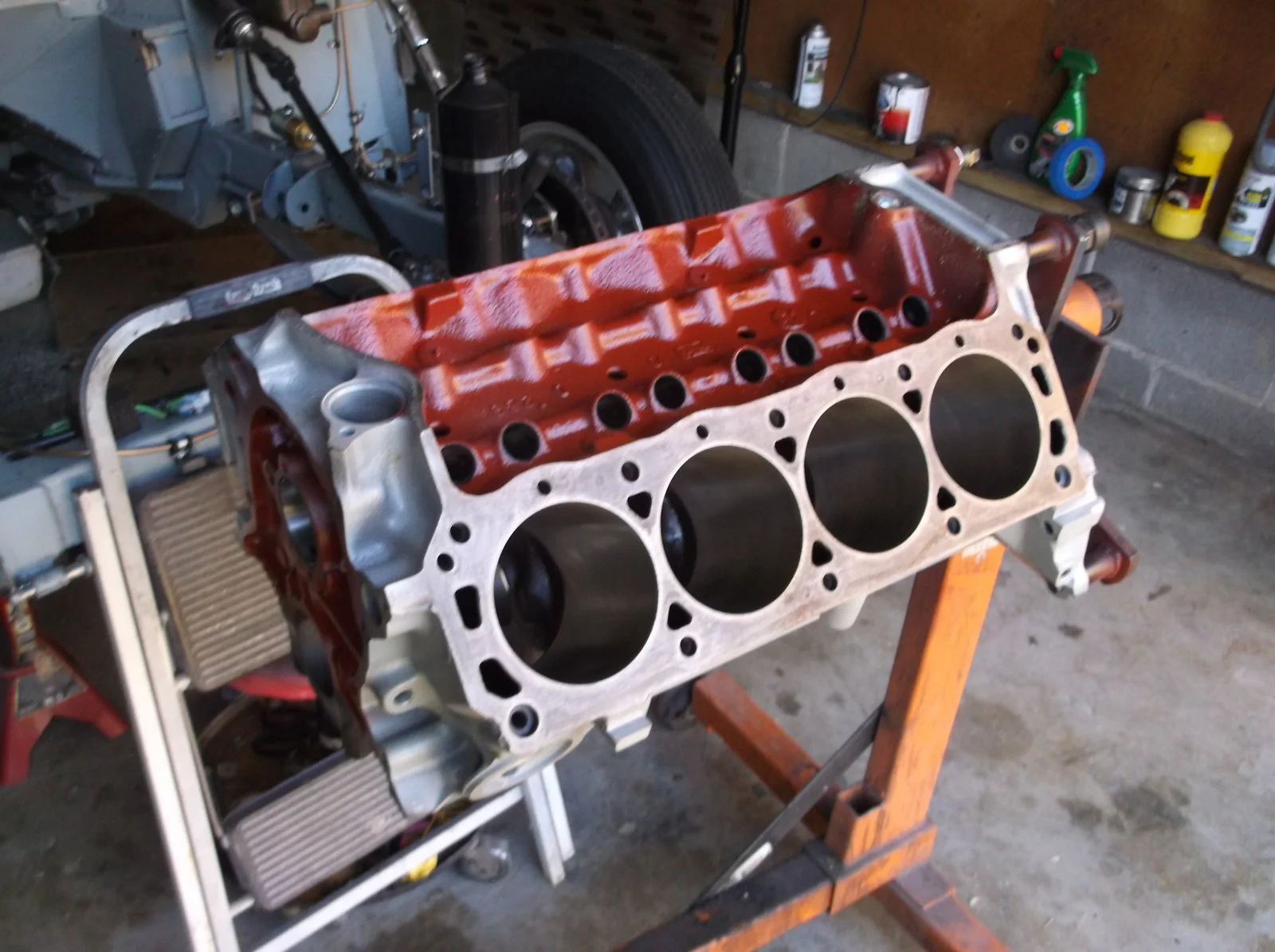

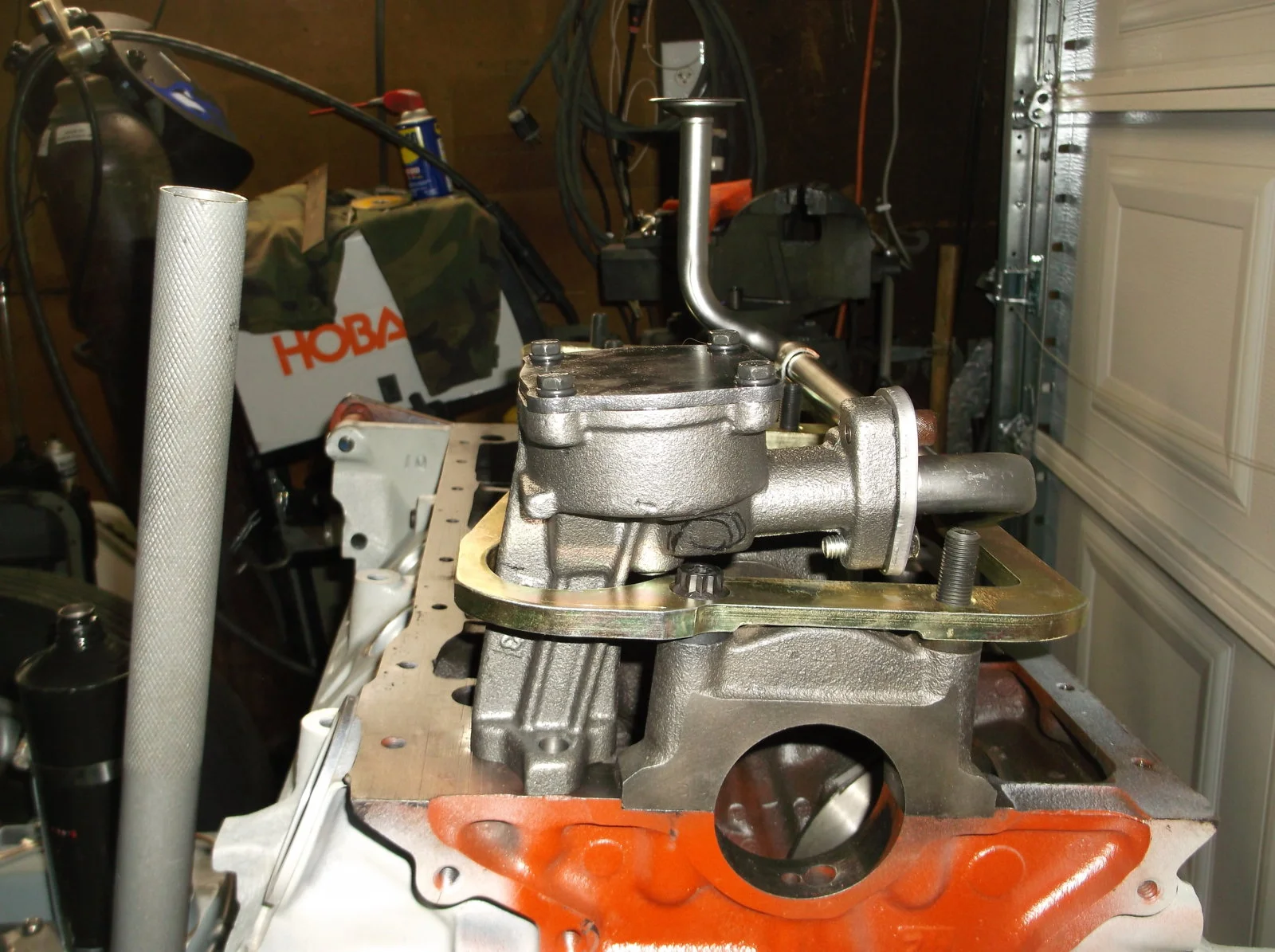

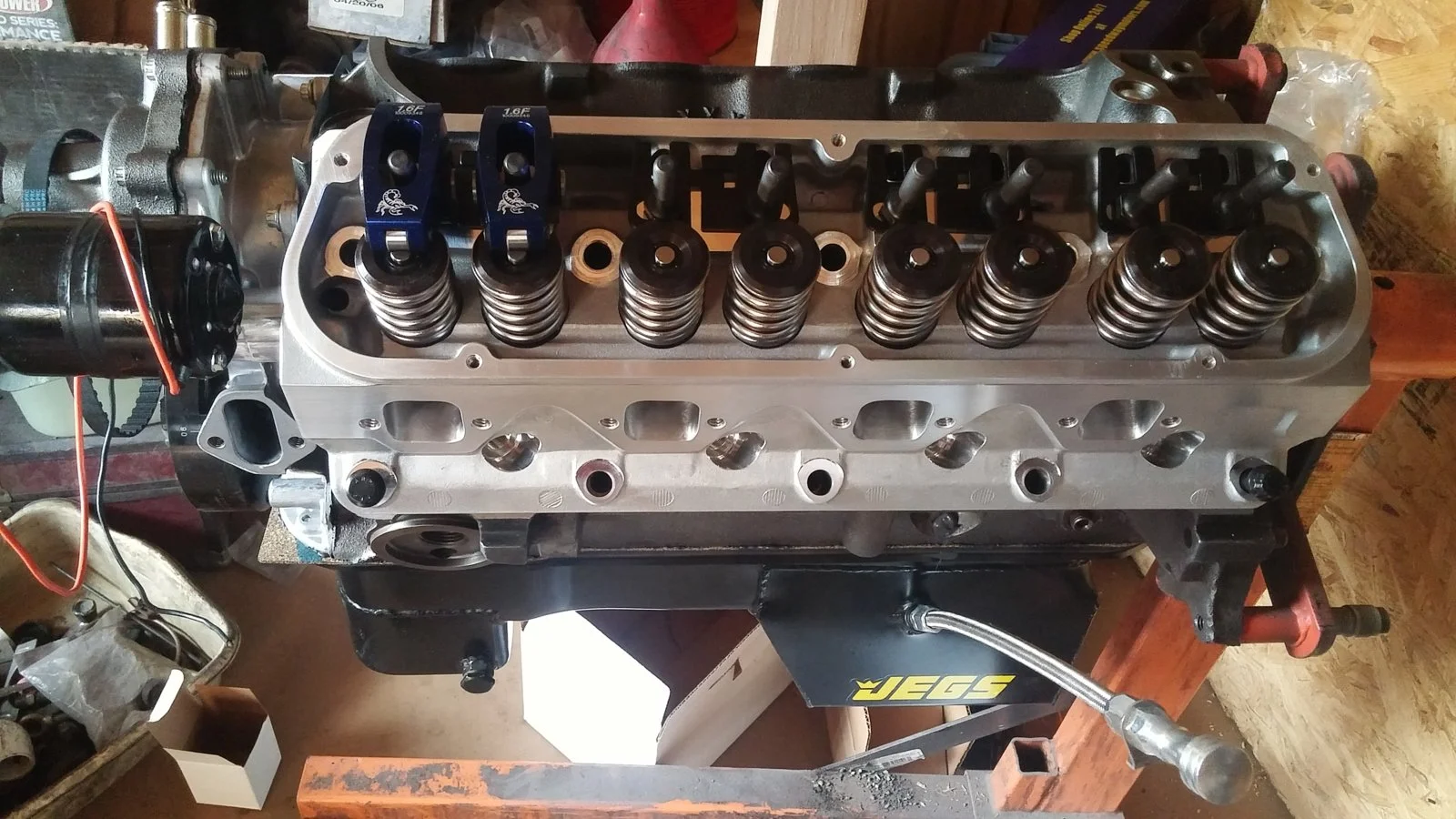

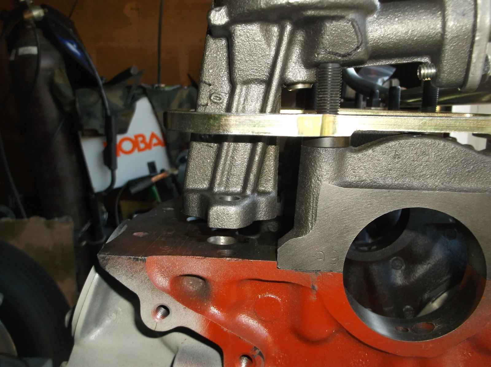

Enough memory lane. Back to my Morris Minor Gasser. Getting ready to test fit my new 333 short block so I can take it to the machine shop to get it balanced.
First issue I found was that PRW didn't send a short stud so that it would clear the oil pump on the main girdle. Using a late 65 289 block bored .040.
. after contacting them and telling them how long a stud that should be in the kit. They 2 day shipped a shorter one that I still had to cut off and rethread to get the clearance I needed to get the oil pump to set down on the block and still clear the main girdle
