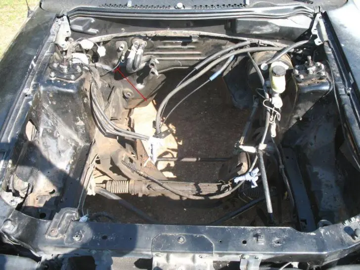

well i cracked it. where can i find another or at least a something that can connect the 2 pieces?

Which line did you break?
I generally use a hose union if it's a rubber line.
If it's a hard plastic line, I use a rubber line with an ID that's the same as the OD of the hard line. The rubber slides over the plastic lines to marry them back together.
