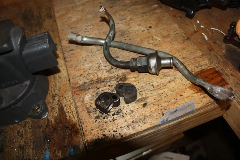

you can buy thermactor plugs from summit. Trick Flow Specialties TFS-51400265 - Trick Flow® Small Block Ford Thermactor Plugs
or just take that pipe off cut off the pipe part and switch around the mounting plates. smear some sealant on there and be done with it.

Aka....

i just cut the pipe off the plates and turned them around and put back up there
