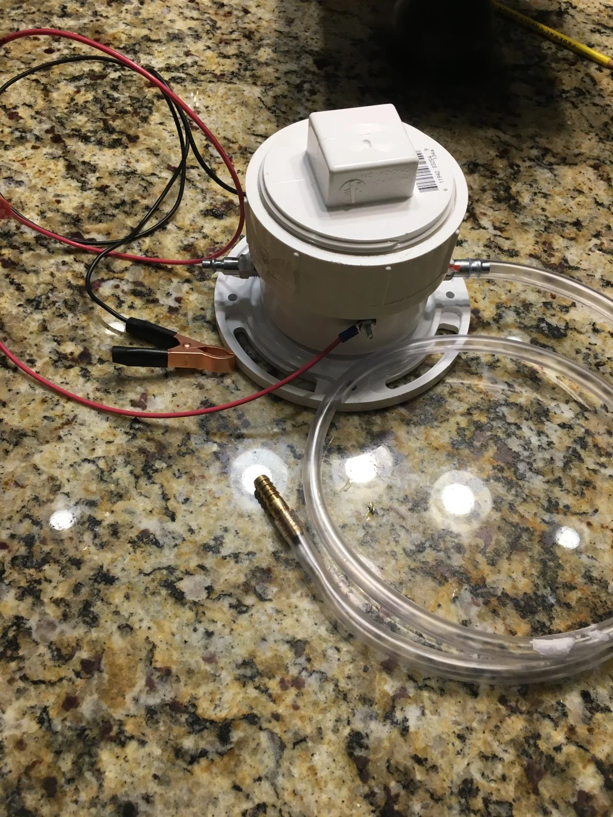

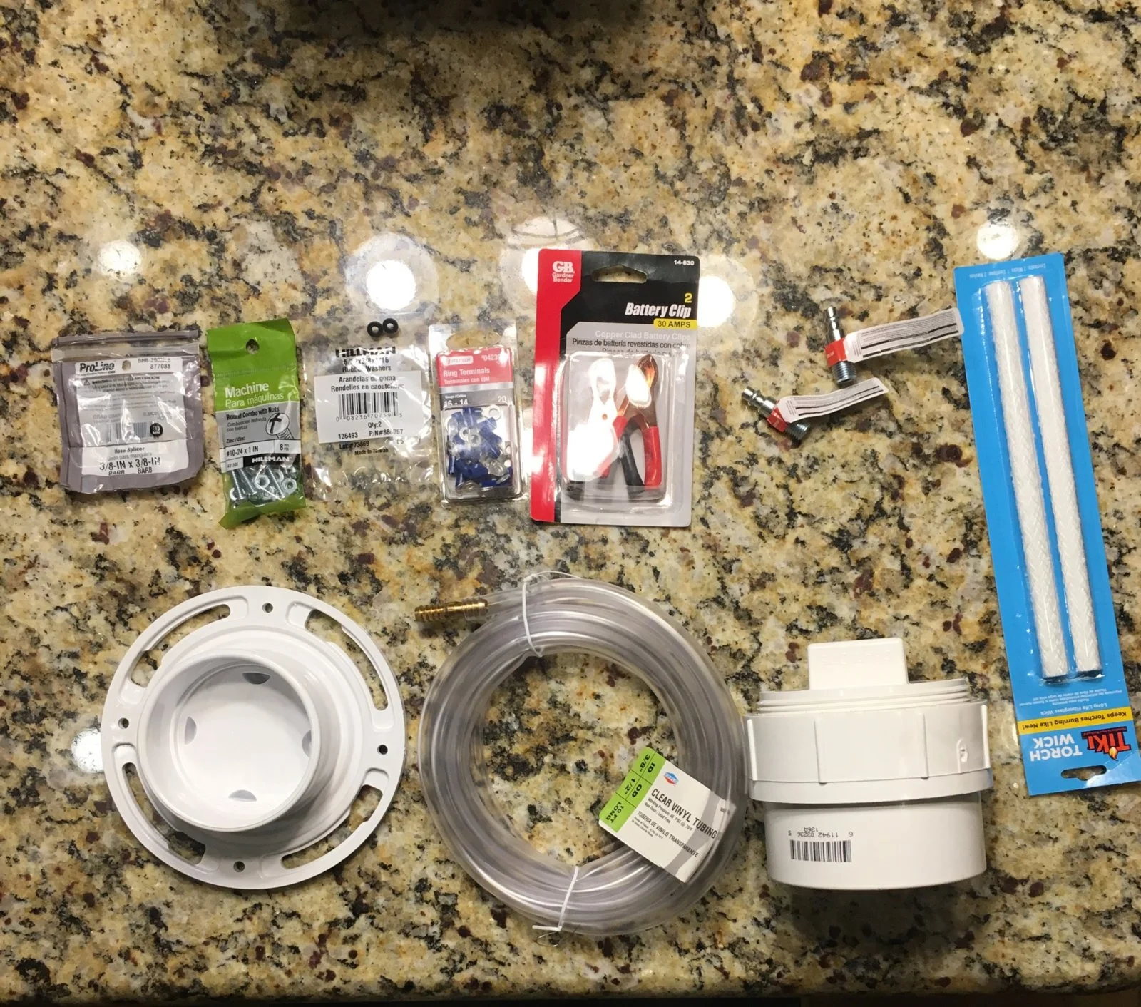

I built a smoke machine this evening to check for any leaks. Figured I would pass the build along. I got all the parts from Lowe’s except the wire. Had to order it from Amazon. Below is the parts list
1 PVC closet flange (Get the one with the cap on the bottom) $3.98
1 PVC 4 inch Cleanout adapter $8.58
1 PVC 4 inch Cleanout plug $4.08
1 2-pk 5/32 x 3/8 x 1/16 rubber washers $1.02
1 pk #10-24x1 Roundhead bolts with nuts $1.28
2 1/4 inch threaded air fittings 2 @ $1.99
1 pk of 16-14 gauge ring terminals $3.58
1 pk of 30 amp battery clamps $4.18
1 2 pk of Tiki torch replacement wicks $2.47
1 10ft roll of 3/8 ID clear vinyl hose $4.38
1 hose splice brass bard 3/8 ID to 3/8 ID barb $2.99
Kanthal A1 26ga resistance wire (from Amazon) $6.89
Total $50.46
Here is the video on YouTube of how to put it together and how it works. All credit goes to Brew2l on YouTube
View: https://youtu.be/crc6CJ_ni2w
And I found my leak
