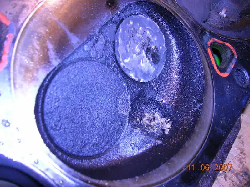

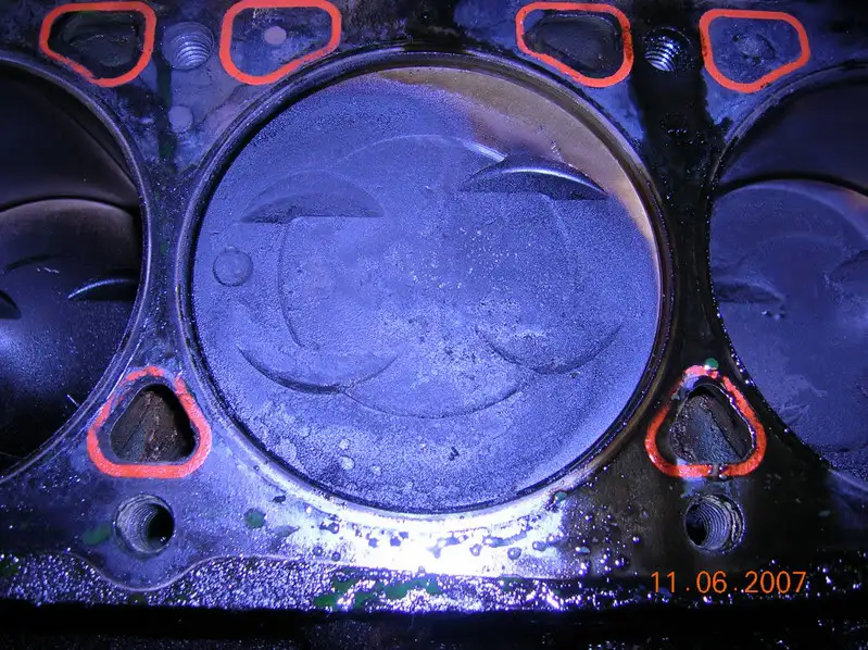

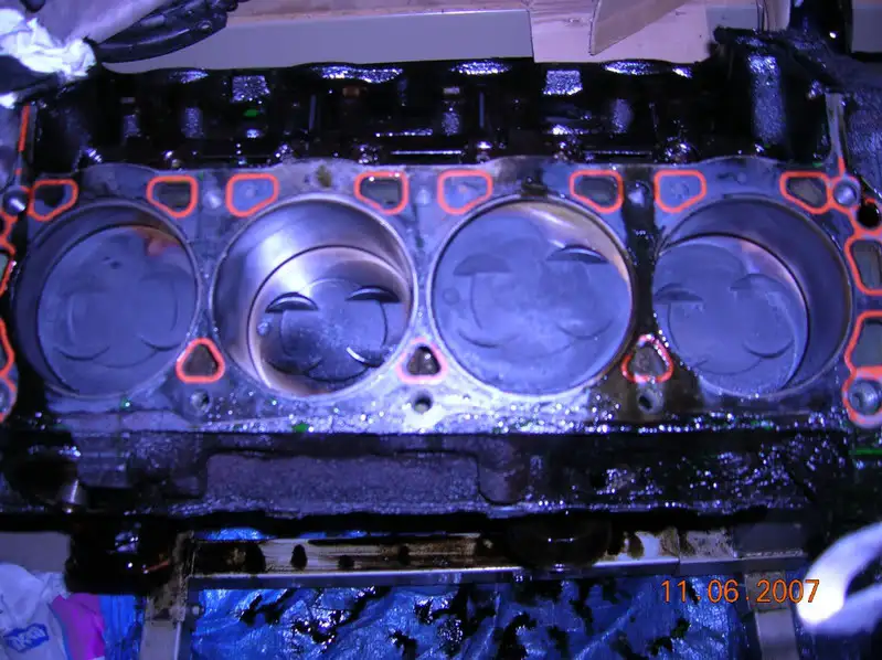

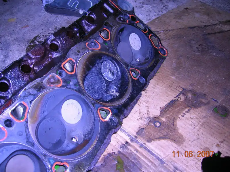

my car was doing this last year, when i tore it all down, this is what i found on my number 6 spark plug. i could tell it was ****ed before the teardown b/c i had oil all over the plug when i pulled it out. you prolly have a bad ring or the cylinder wall is bad, mine had a nice groove in it i had to go .30 over.
top of piston
head
hope this helped.
