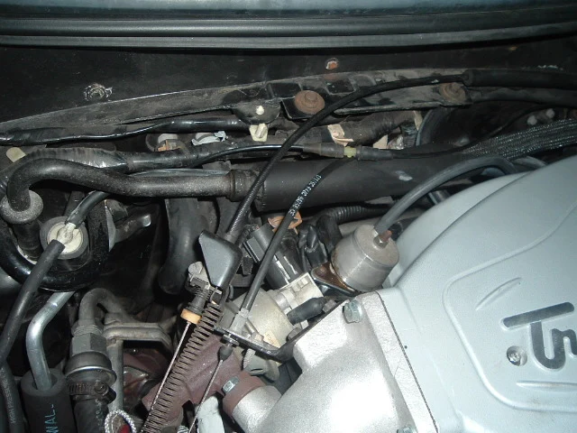

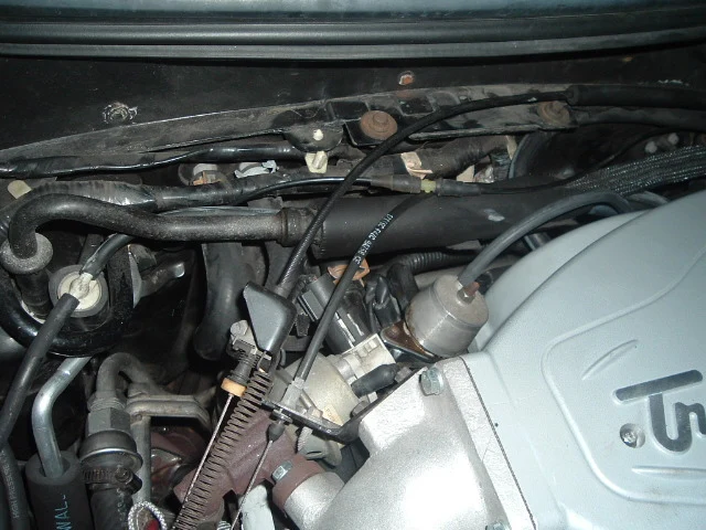

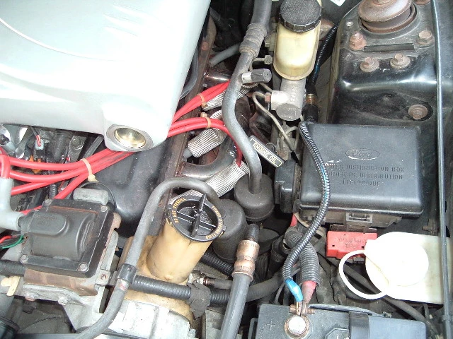

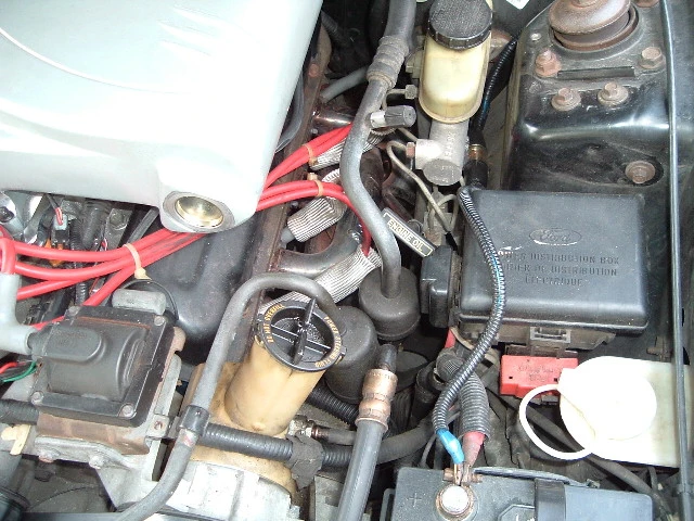

i have a street heat, my mechanic installed it.
it is taller, the stock strut tower brace did not fit over it.
it fits under my hood, but i have a cobra hood from a 1996. i believe it fits under the stock hood too though.
i believe there were no problems with other clearances (a/c, valve covers, 45 degree bend, t/b, or alternator).
- chris

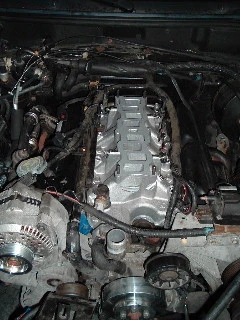

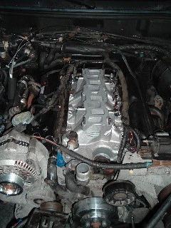

here are some various pics that include parts of it:
