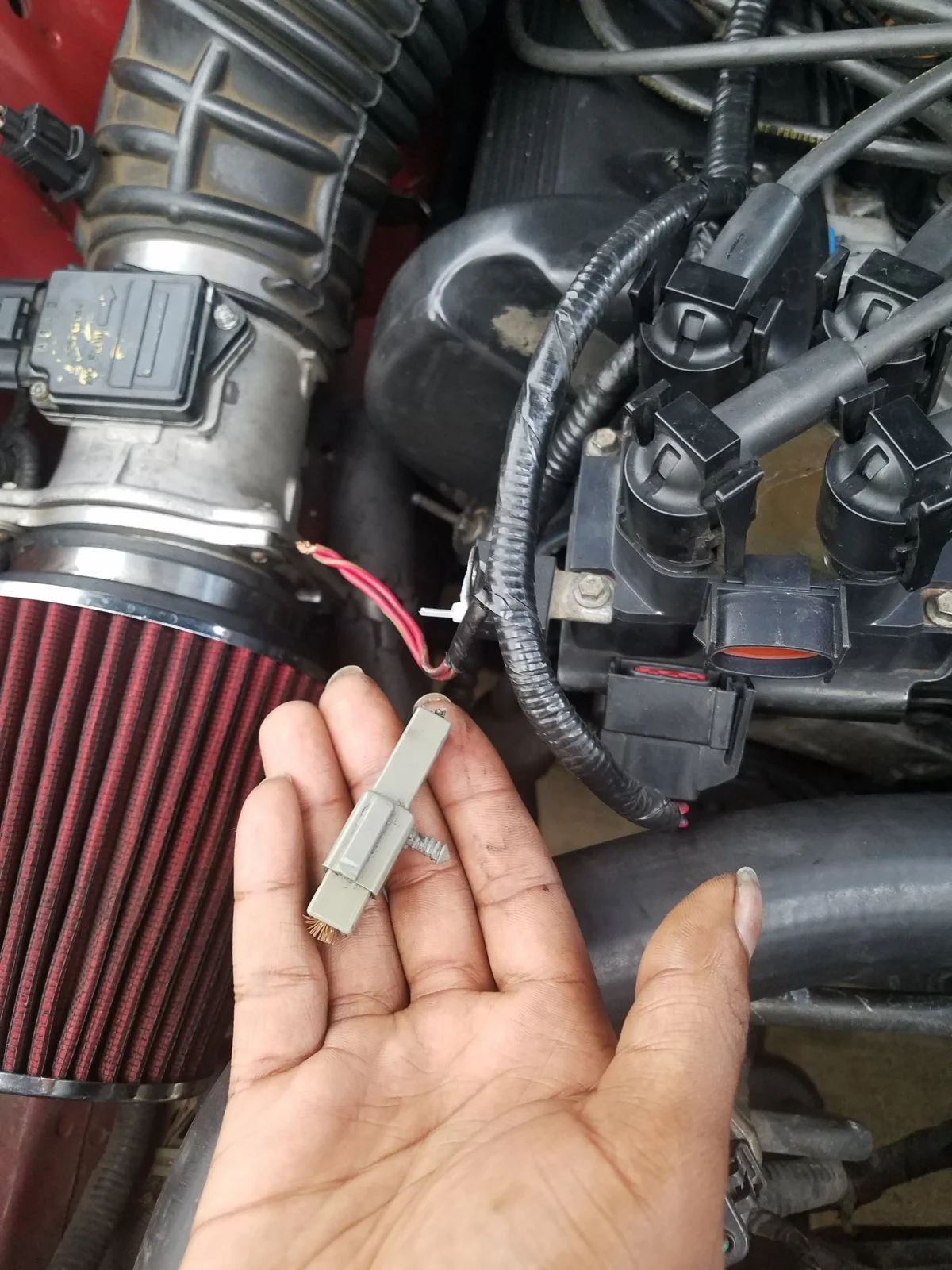

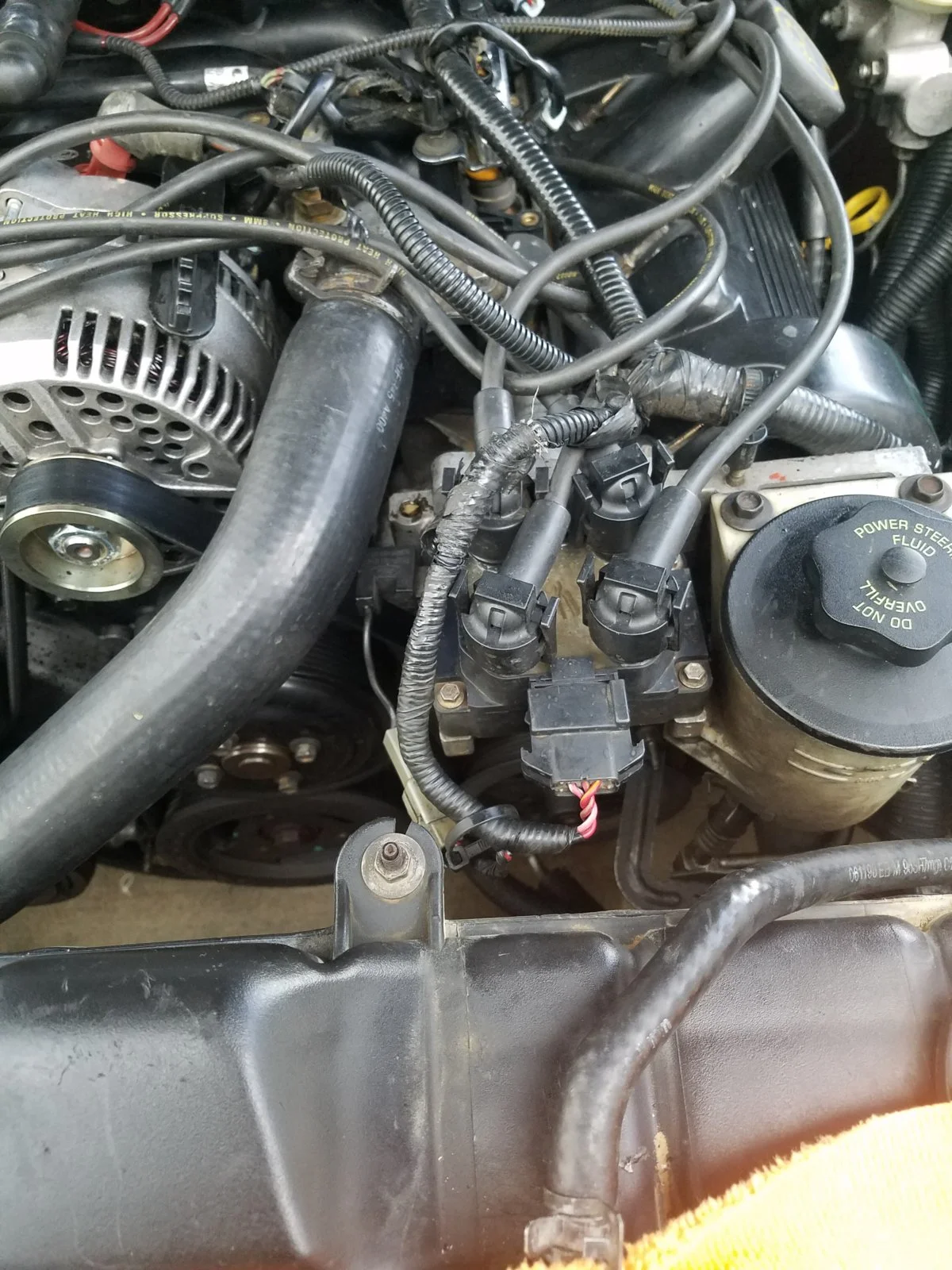

I was inspecting my coil back because I was having a weird misfire I checked all plugs & wires everything looked fine I stumble across my coil realized that part of this negative wire was hanging off so I tried twisting it an poking it back in hole an the negative side breaks on me. The car will not start. I've tried solving the issue for 3 days. I give up an need help please. Pictures posted below. Please tell me what the clip does an what it goes to an we're i can find replacement thank you so much second picture is how it should be connected
The part in question goes to the ignition radio interference capacitor. It's purpose is to cut down on radio static caused by spark ignition. A missing radio interference capacitor will not prevent the motor from starting.
But here's what I think happened. The other side of the interference capacitor is directly attached to the motor's ignition VPWR source. I think the circuit has been shorted out to ground and the ignition fuse is blown. This can be confirmed by testing for key on +12 volts at the red power supply wire. Use a KNOWN good ground. If no voltage, the diagnosis is confirmed.
I'm also suspecting that once the ground fault has been repaired and the fuse replaced it will start and you can restart the trouble shooting.
