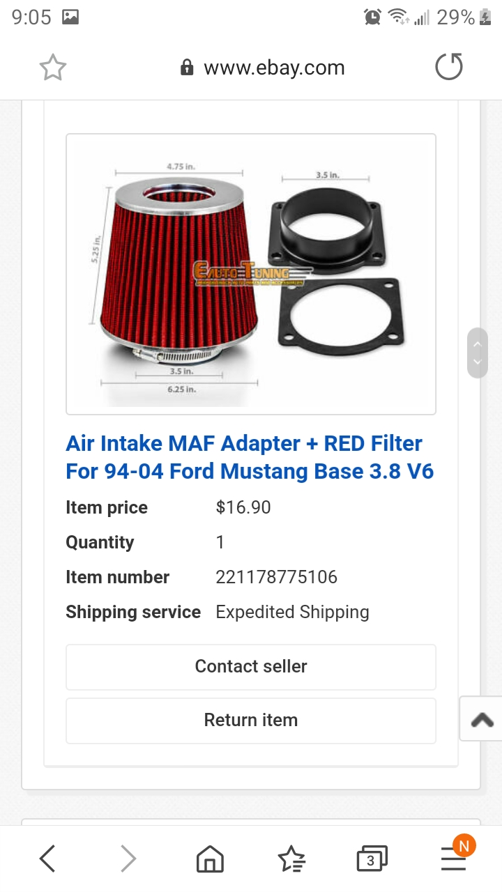

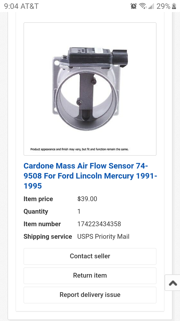

Ordered the MAF and adapter. The filter was only 5.00 more vs. Adapter by itself (i love ebay lol). I needed one bad anyways. I wanted a "race" filter that was $70. But this will work. Lol.

Went and checked my filter and intake tube size before ordering to make sure. Thought i remember it being odd at 3.25, but it wasnt. 3.5". But dang, stock fox MAF is soo small.
Edit: i got a fenderwell intake, not running it direct.
