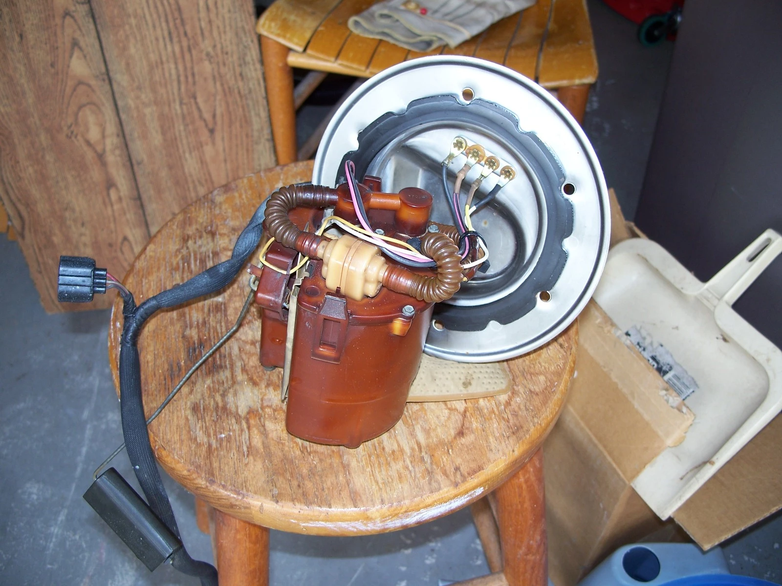

Finally got around to taking a "post mortem" pic of the old fuel pump. Here is what it looked like after 14 years and 124K miles. I was really pro-active into replacing fuel filters, BTW. The tank's insides were "pristine". New filler neck grommet installed as well. Now I understand what "wmburns" was saying about the fragility of the check valve.
