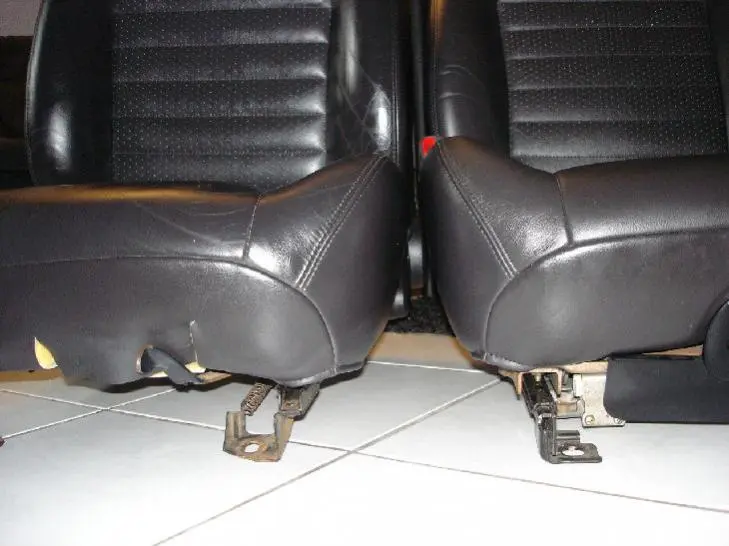

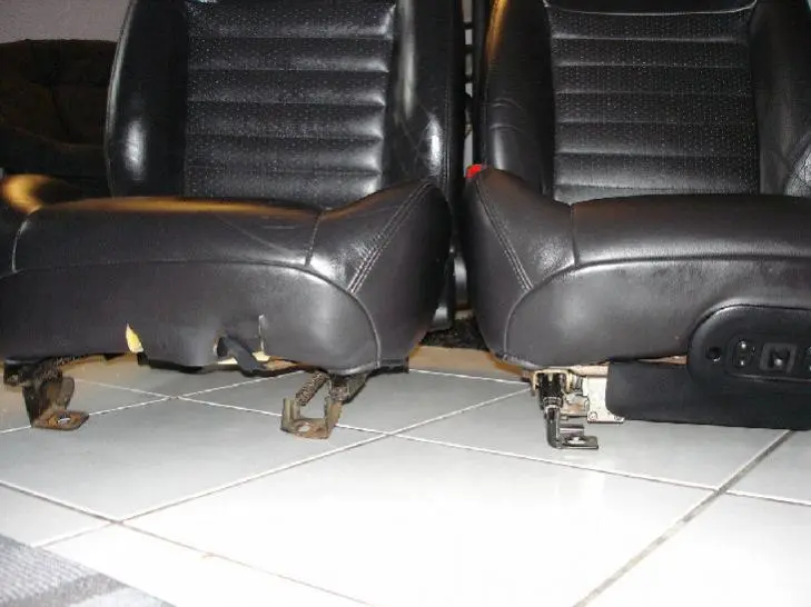

If you've ever wanted to see the difference, here it is.
Both driver's seats out of a 99+ car.
Seat on right has stock 99-04 power tracks (out of my '03 GT)
Seat on left is 99+ seat bolted to Fox tracks (going into my 5.0)
It's about a 1" difference in height.
So, if you are tall, you might want to swap fox seat tracks on
