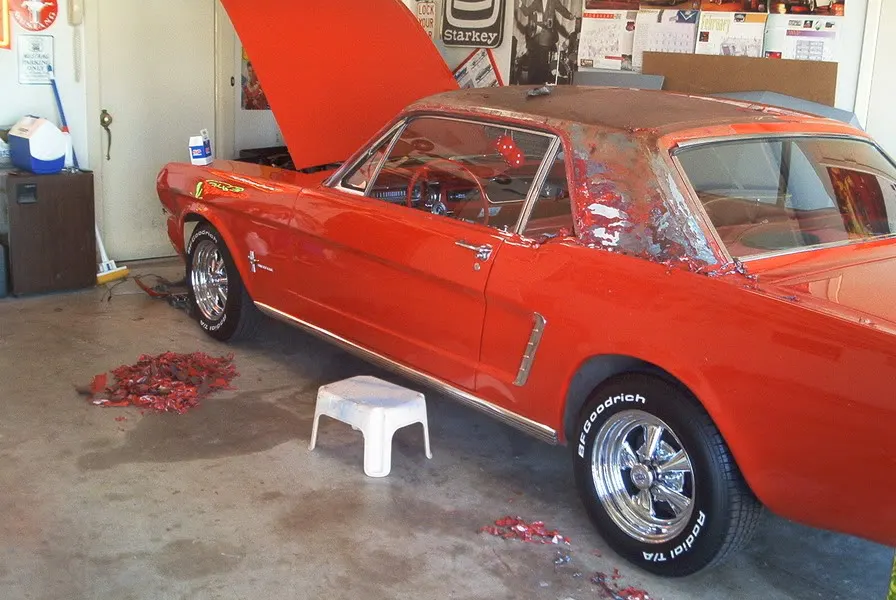

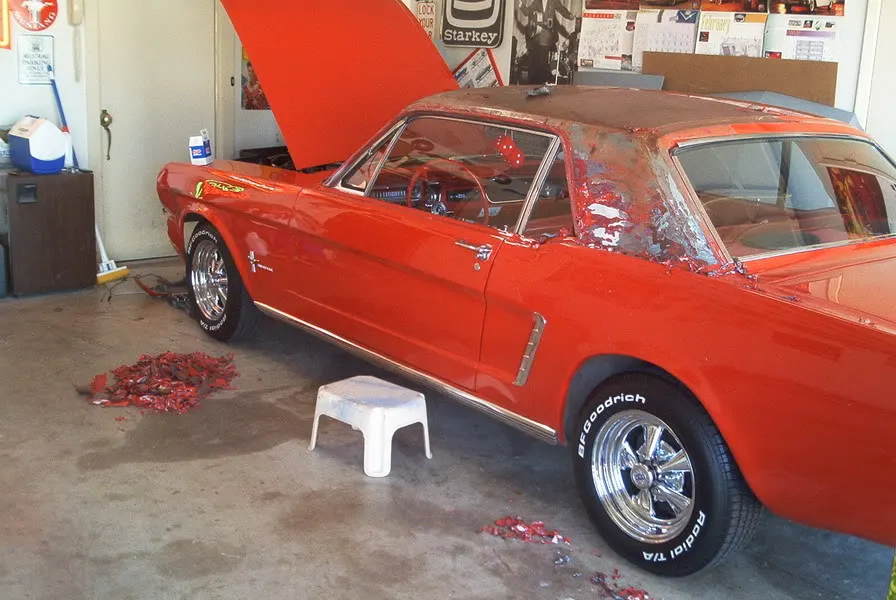

Old picture, the day I started stripping 5 coats of paint off. I detailed it first, so it is a really cool picture.
