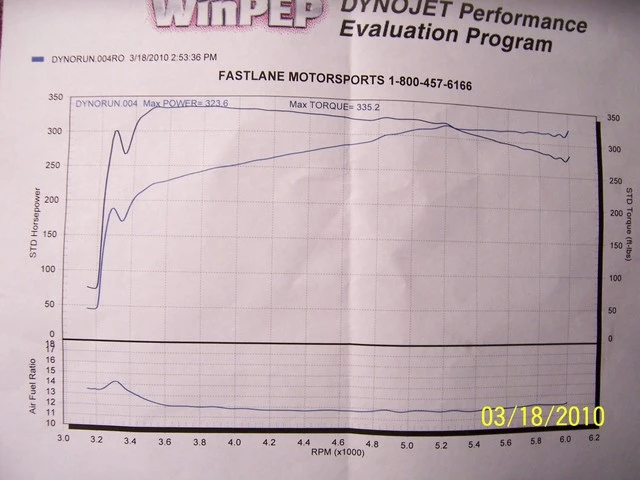

car made some good numbers. i'm sure he'll post up in a few min.
Will, it was good to meet you today maybe you can make it out to the track or some dyno days sometime soon!
Thanks man! Good meeting you too. I'd love to go out with y'all to the track one night. I really want to see your car, and I REALLY want to see Fastlane's car.
98COBRA281 said:
good numbers man, especially with a auto!!!!
now go get some track times
Thanks! I was definitely surprised at the numbers. I mean, with those numbers through an auto, I'm probably close to 400 fwhp, probably a solid 375. That's what had me most surprised; I would have expected these numbers with a 5 speed, but never though the slush box.
I plan on going to the track sometime soon, hopefully before it warms way up. Probably not before I get some drag radials. Gonna use my tax refund for that.

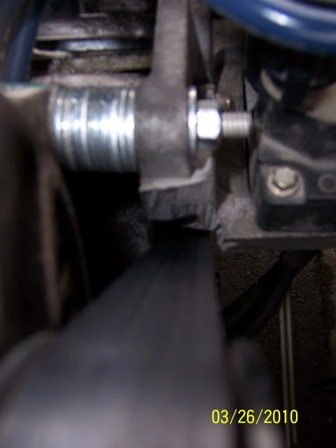

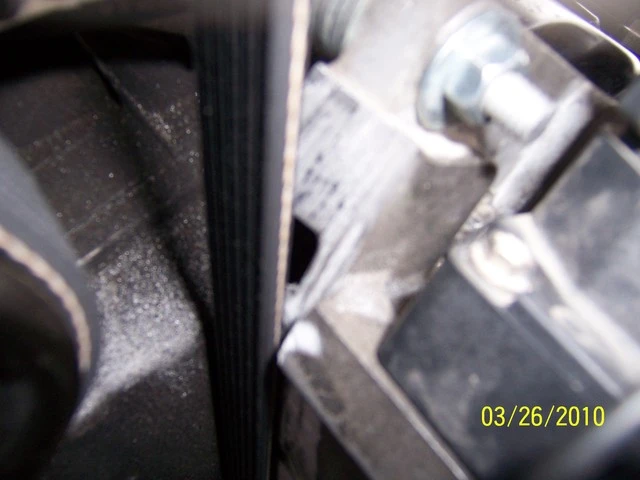

First off is the serpentine belt. I finally got one that would fit, and it is 111.5 inches. Also, the belt will hit the driver side coil pack mounting bracket. It just barely will hit, but a little modification is required. I marked the bracket where the belt was hitting it, and just used a bench grinder to grind it down till the belt will no longer hit it. Also used a sawzaw to cut the little ear off the top corner of the bracket; it isn't used for anything. Not a big deal, but has to be done.
Here is the ear cut off. Sorry for the bad picture quality.
Here is a picture of the belt and bracket after I ground it down.

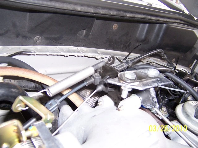

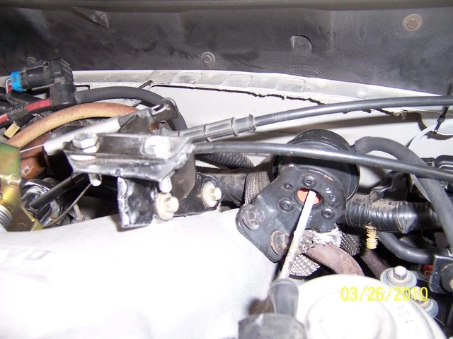

Also had to make a throttle cable bracket. It was a very ugly and aggravating piece to make, but I finally did it. Hard to explain, but here are a couple of pictures so that you get the idea.

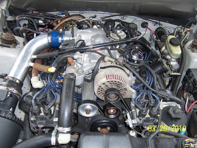

A picture of everything completely done.
Feel free to ask any questions about this that you need.
