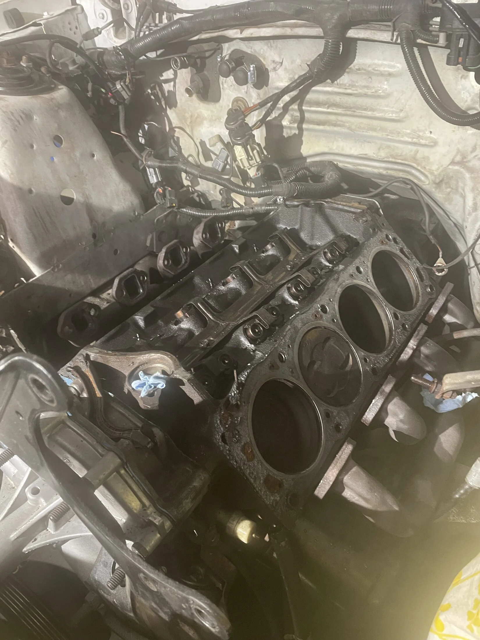

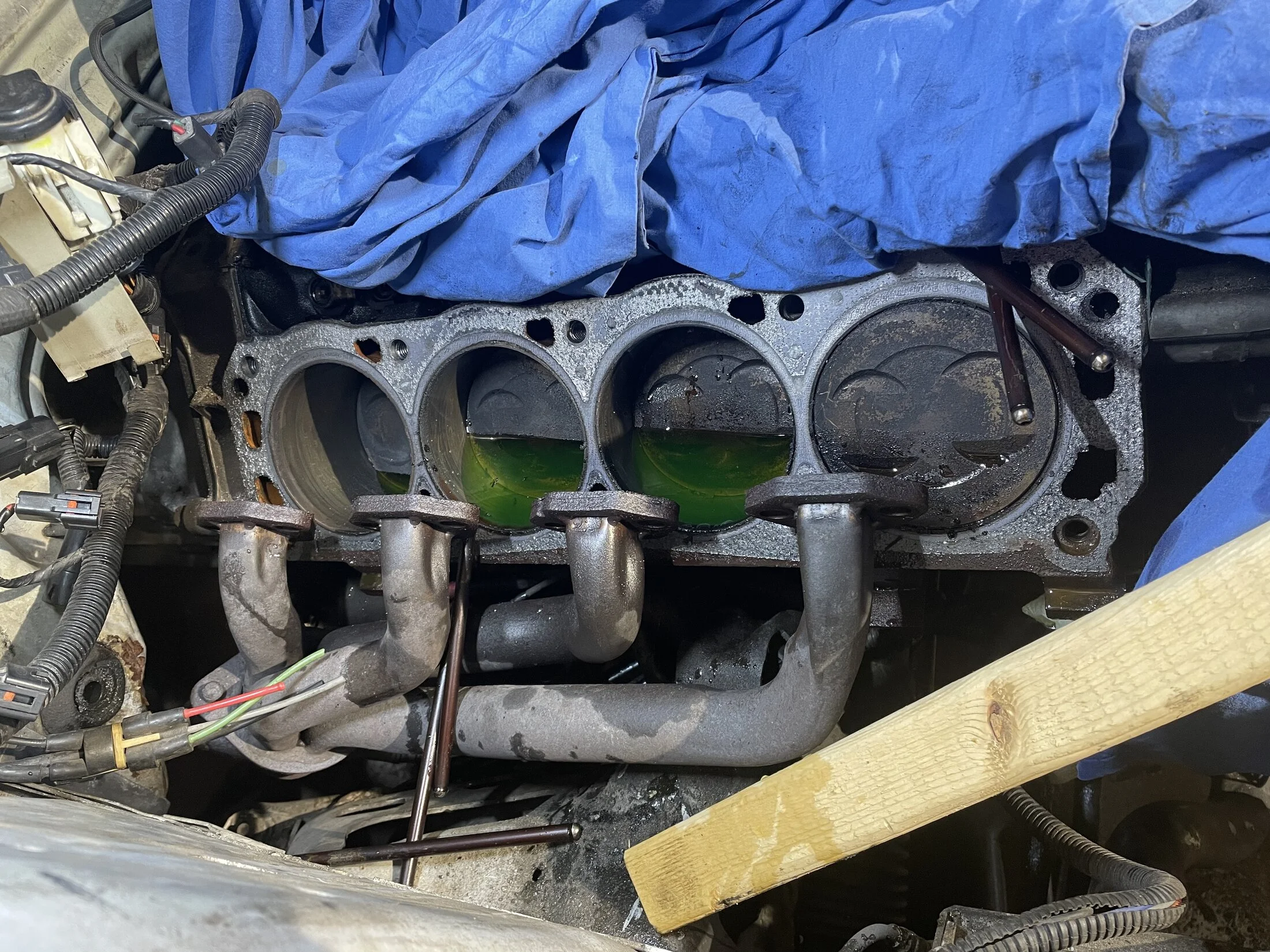

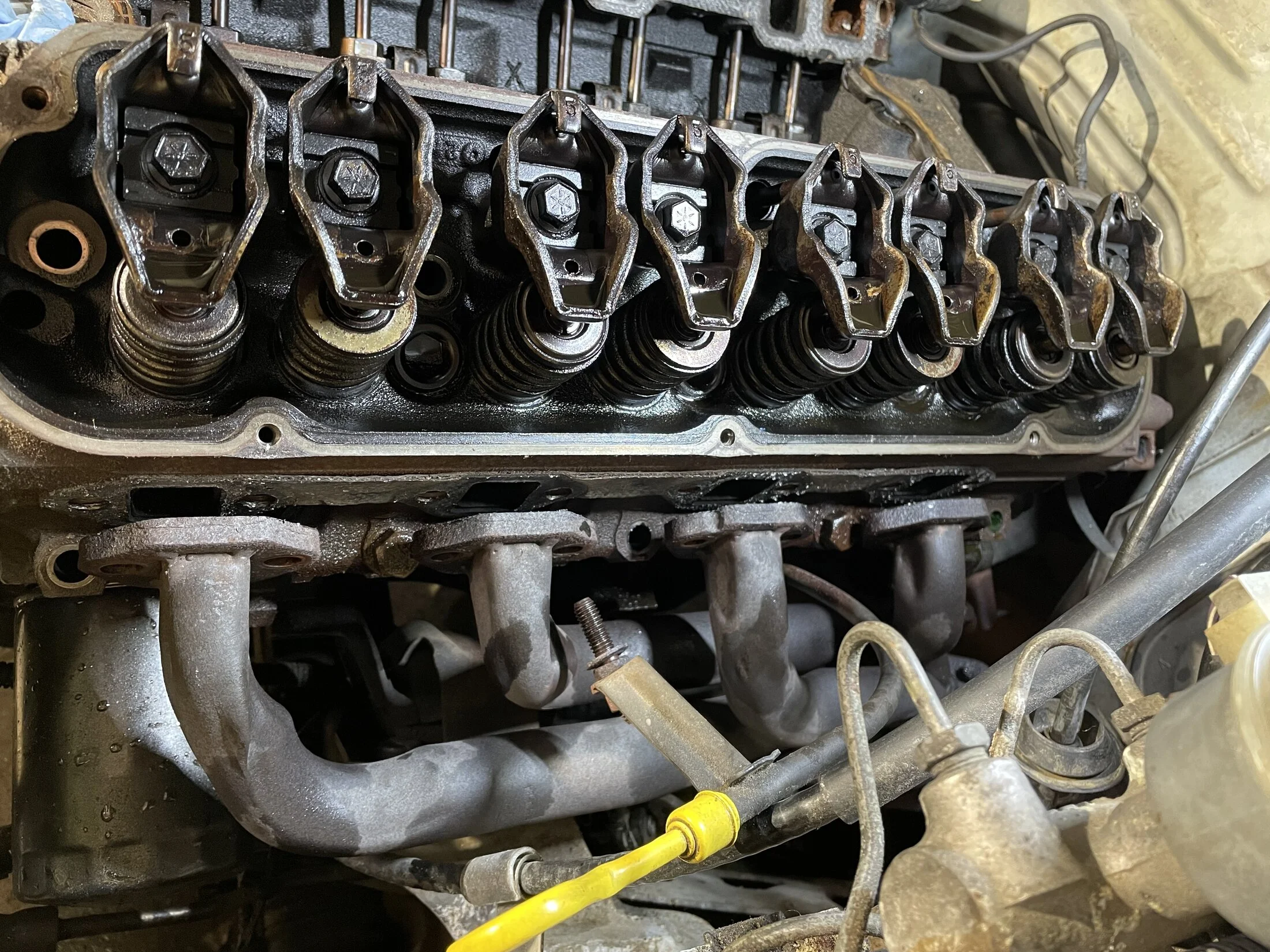

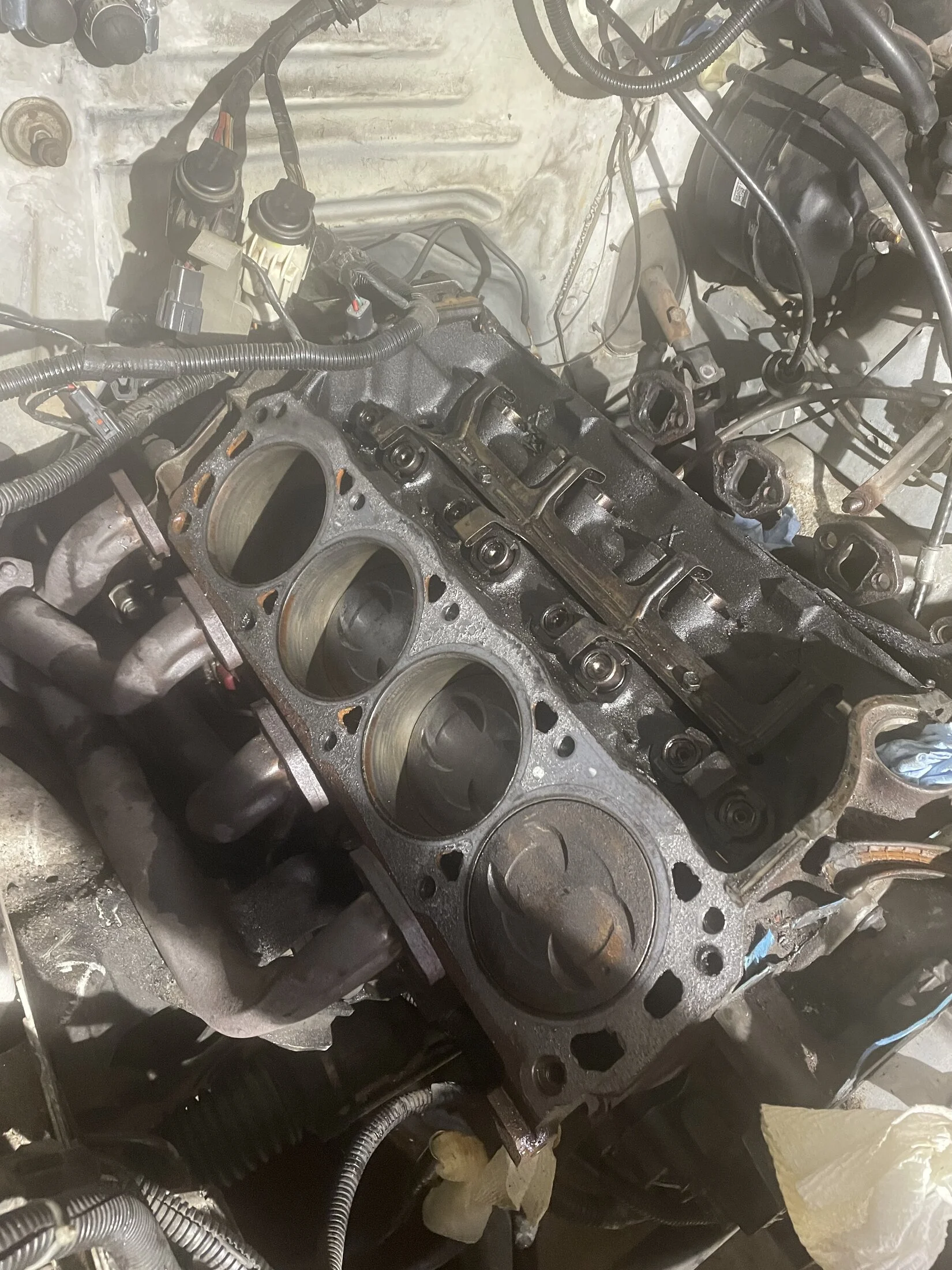

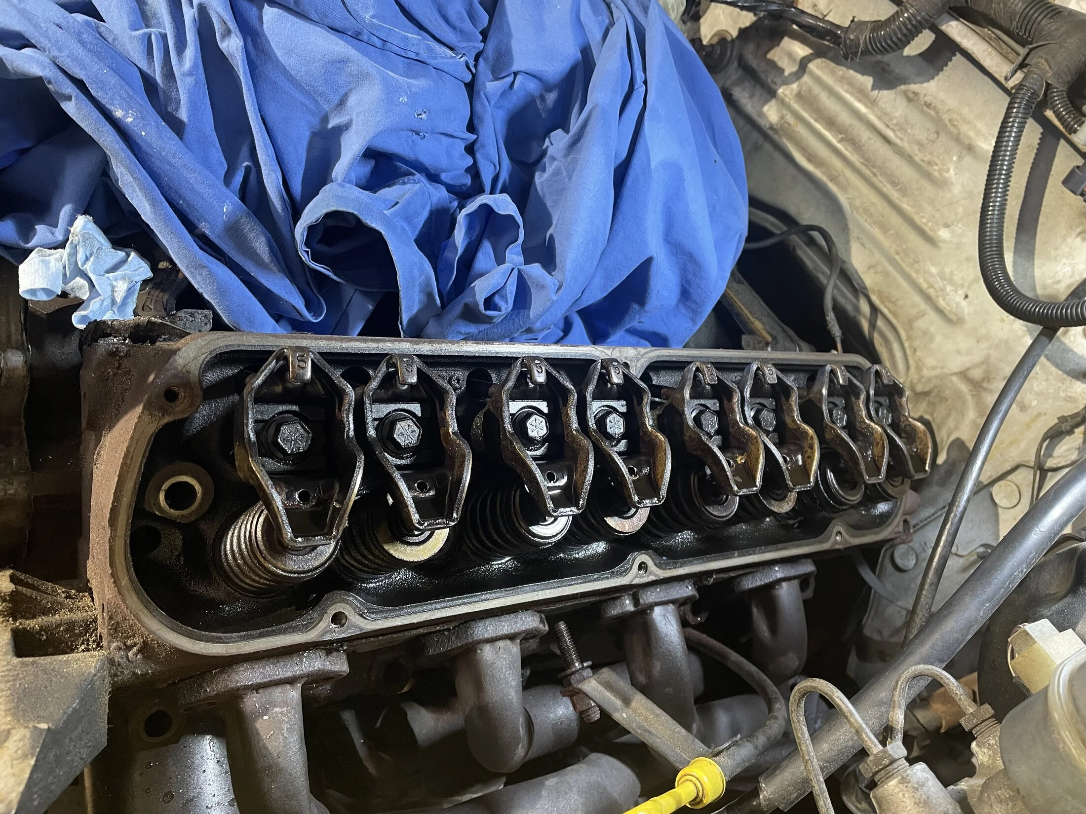

2 pesky bolts remaining drivers side on the exhaust. Trying to take it slow

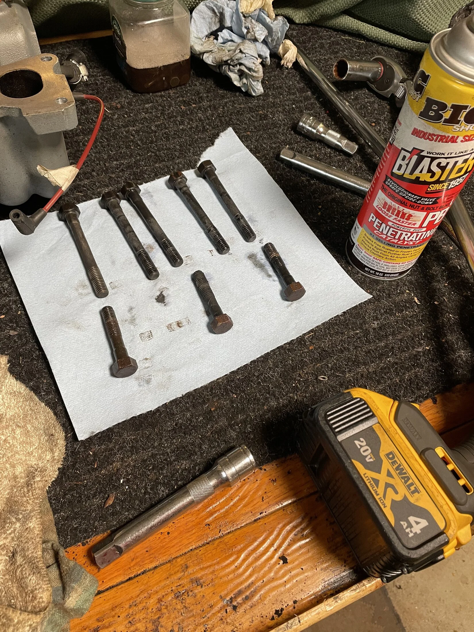

Also,and impact driver will be your friend here. Since you already removed the heads,the headers are probably going to fight you if you try a regular socket wrench setup. The "impact" motion should knock those nuts right off.
Thanks. Best purchase I ever made was my 1/2 Dewalt impact. I wouldn’t even be trying this in New England without it.
