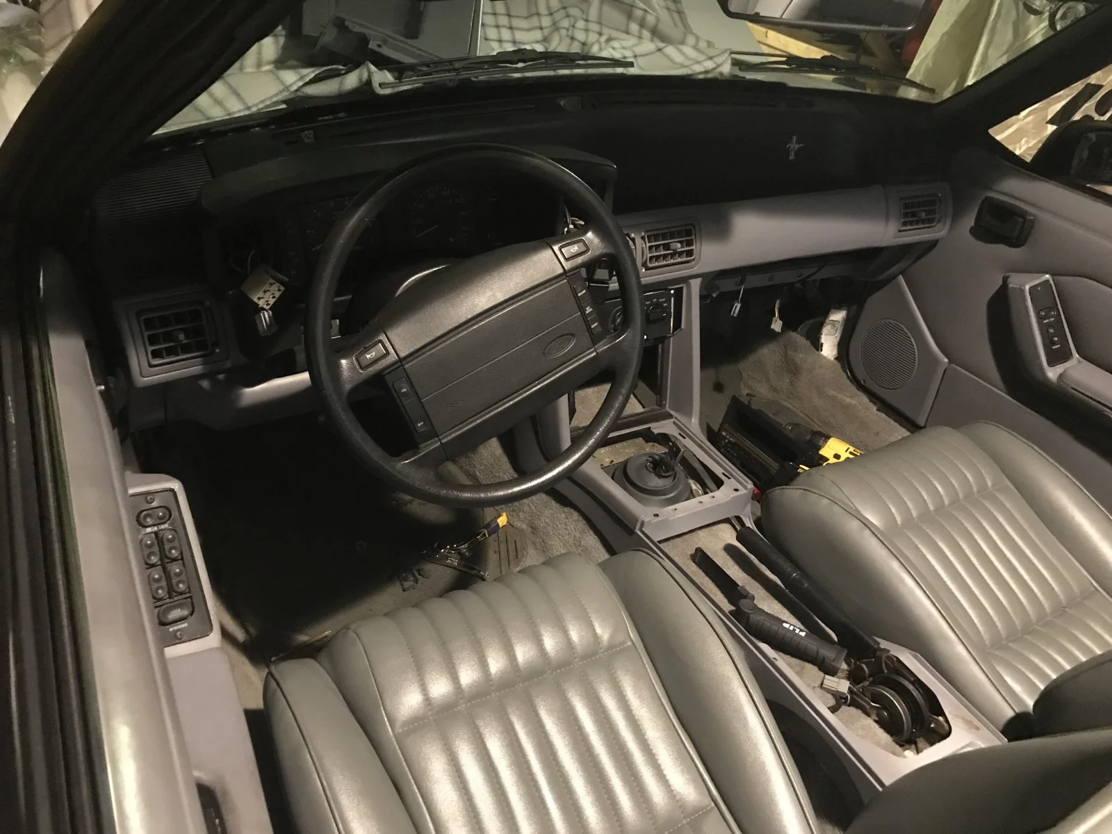

Going back together pretty good so far. It’s just like a damn LEGO set.
That said, I swear I’ve done the steering wheel console, jacket, and metal plate thingy like 5 times as I did things in the wrong order and had to undo it.

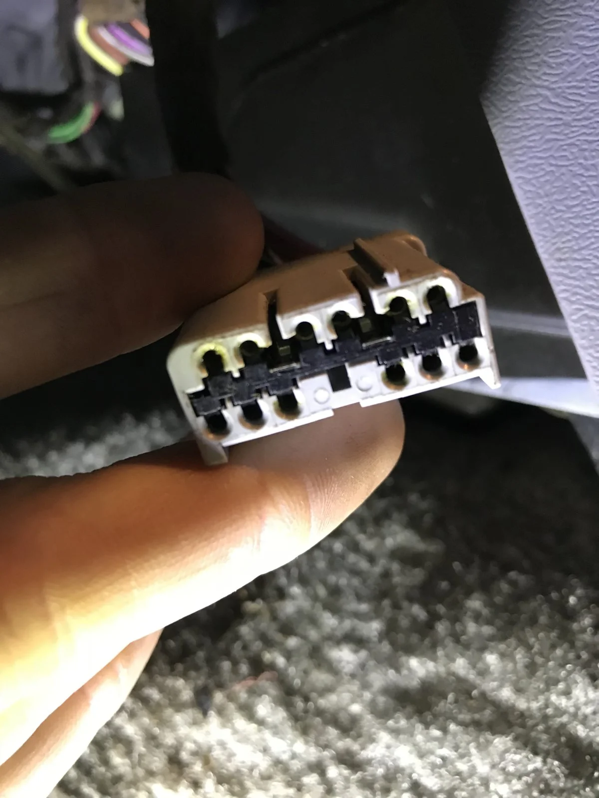

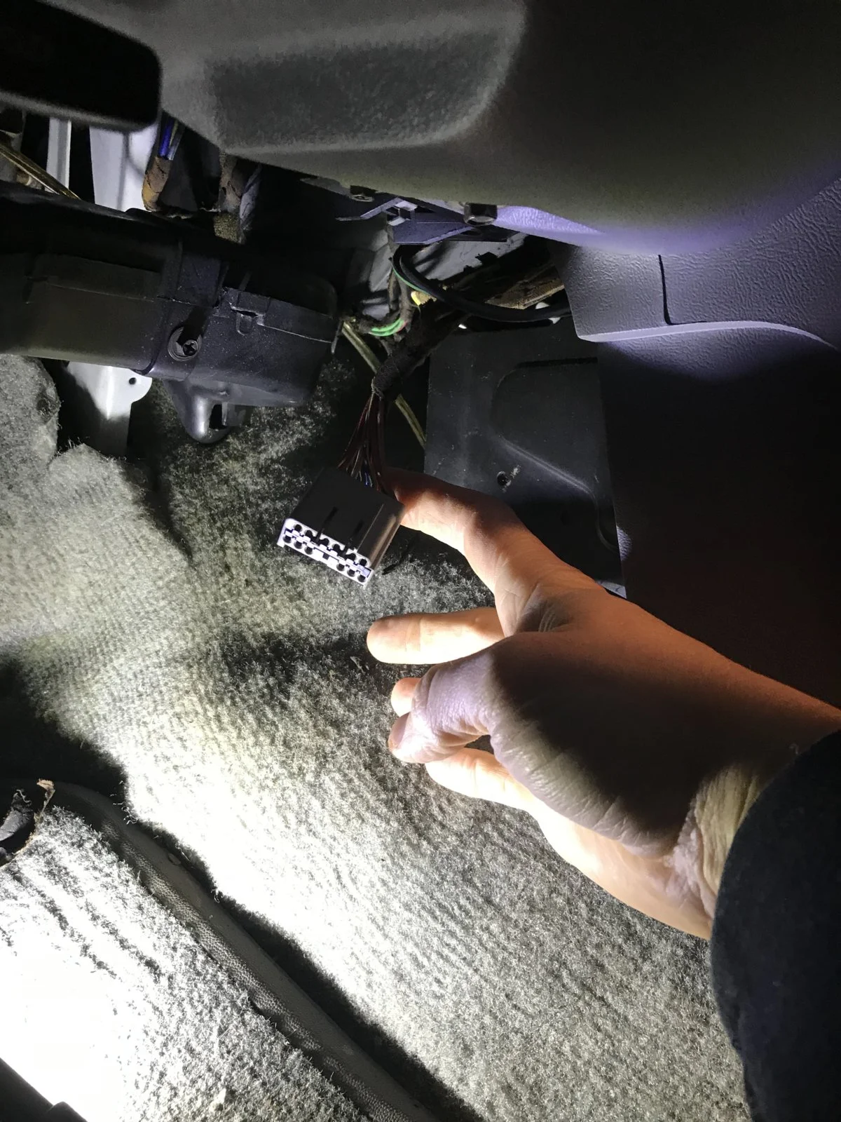

Silly question I think, but does anyone know what this is for?
I don’t think I missed any connections. I’m pretty sure I reconnected all HVAC connections and it’s working. It looks like it goes in the direction of the HVAC.
Any ideas?
If I remember correctly there are two connectors, one gray and one black?
after some searching I found pics of the stereo connectors and they are different than what you have pictured, so it is still a mystery, sorry.
