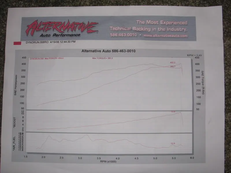

i have one.....
i went with the stage 2 kit with which you can adjust the starting point of the meth then it increases the amount of meth injected until whatever point you say on the controller is full boost...
it definatly works, when it kicks in you can see the A/F ratio drop while your boost/rpms increase
take a look at my dyno graph..... at about 3200 rpms is where i introduced the meth as you can see....
You might think my a/f ratio looks a little funny/wavey well it does i was having issues with my MAF and the increments on the side of the graph are very small so you will notice any changes
but yeah it worked out well for me i guess....
any other questions just ask

i think you are talking about a boost cooler, not a boost controller, right?
i've had one of the snow kits for about 2 months now ... still not installed!
i'm getting closer tho; i finally ordered the egr delete plate from wazzee and i'm having a threaded hole machined in it. i'm using the egr opening in the elbow as the injection point ...
Worked great on my car when I ran it.
Dropped my A/F a entire point, I was then able to add timing for more power.
Also these kits wont help for nuthin if you dont add timing (a dyno is def needed for tuning)
If not you will actually loose power

I was just gonna say that "eades" had one...that I saw your post.
You want the Stage 2 if youre making any decent power.
RC
The cooling affect is only apart of methanol....it drops a/f, allows you to run more boost safely and allows for serious timing increase.
Theres guys on this board with simple blower combos running 30* total timing with 12-15psi on pump gas.
Methanol is mainly used for that reason where N20 is cooling.
Hope that clears some confusion up
Chris
Also
Methanol is a raw fuel you are spraying into your motor, you then add water to the mix and theres your perfect mixture of cooling/detoantion control.
PM M.Plummer for any details hes a brain with these kits and also a Snow dealer
