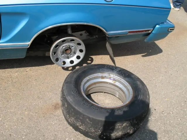

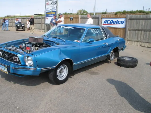

I had high hopes of running what I set out to run, I was so desperately seeking a 6.6x in the 1/8th mile. The night before I ran a 6.83 getting in and out of the throttle trying to keep things under control (18 mb vid is: http://s167.photobucket.com/albums/u154/mrpowderkeg/?action=view&current=MVI_0486.flv) . Today I made one run, it went arrow straight, got a 6.703 @102mph, not bad for a warm up run. The next run I brought the car up on the converter, the last yellow comes on, I punch it, and next thing I know I'm hard on the breaks knowing I'm going to hit the guard rail. I ended up breaking my rim at the start. It just destroyed the welds and the outer part of the rim (and tire) came off. And here I thought the stock 8 inch 4 lug axles would give first. It makes me think this street/strip car (really sees way more street duty) needs a break, and I should build a different car for a bracket car.

What are you doing to get her in the 6.? range?:shrug: NOS? Anyway sorry about your misfortune but would it not be cheaper to buy some real rims ( 1 piece) as apposed to building another car? Hey look at the bright side , now you have an excuse to put a tilt 1 piece front end on:rolleyes:
Ouch!! I agree with itsaMustangtoo, Fix the damage, which looks cosmetic and grab a set of new rear wheels and race-on. Wow, I like steel wheels, I have always used them on my II. I work at a speed shop and I have seen the ugly side of aluminum, never saw a steel wheel failure before!! Looks like a Barts stock car wheel?? Never had much luck with that company (finish problems), never figured one would do that though!!!
! Time for some serious wheels.
Yeah, I won't be racing any more this year, not because I couldn't get it together, but I figure I need better axles, and I'm going to get some Drag lite rims for the thing. Dang all I wanted was a quick street car. Now it's getting ridiculous all the stuff needed to go fast. After this I'm leaving the car as is, and building a different "race car".
BTW, a few more pics of the scene can be seen at http://angellnet.com/DAP/racing/02Sep07/index_4.htm you can actually see the tire starting to come off.
