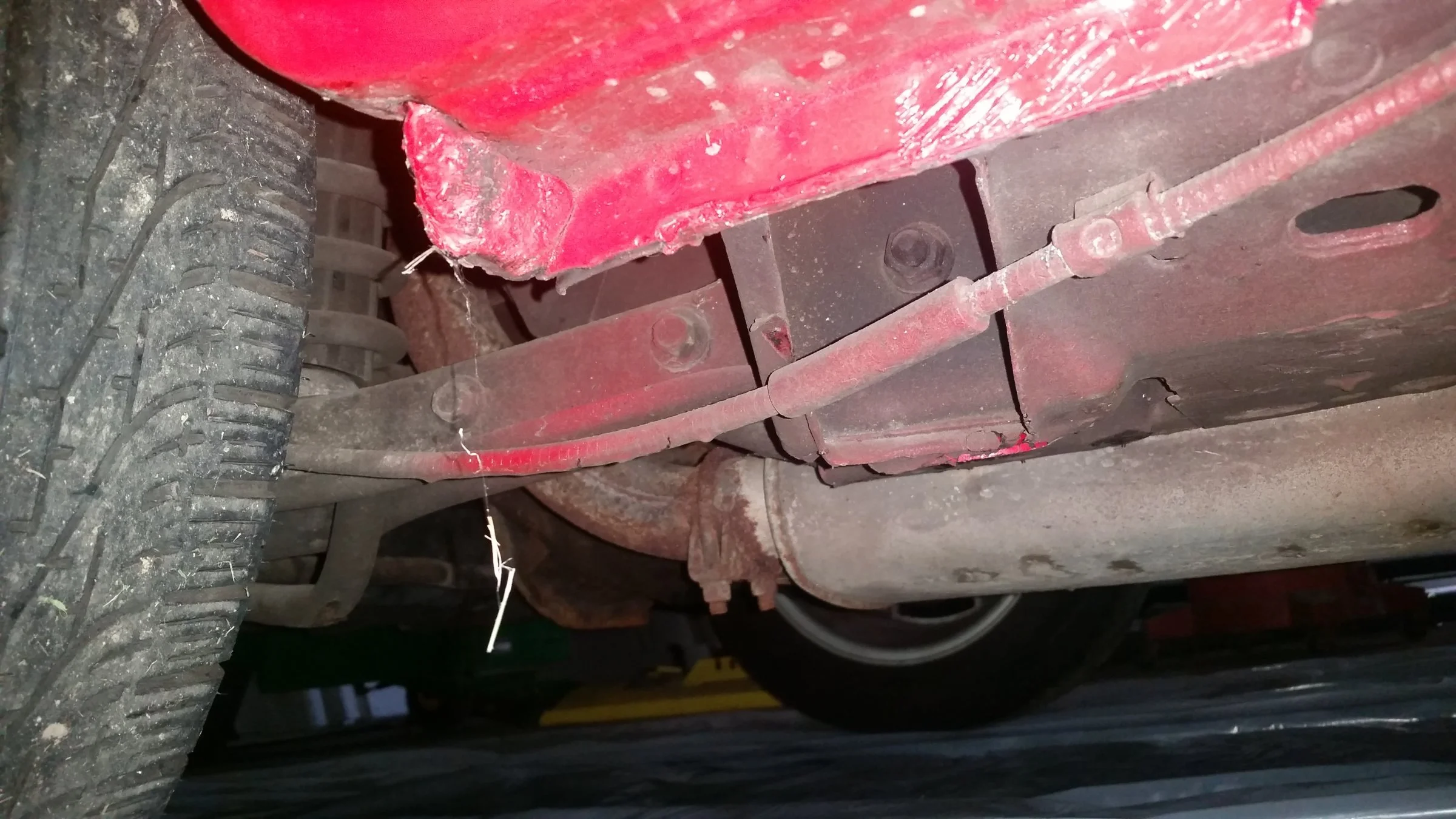

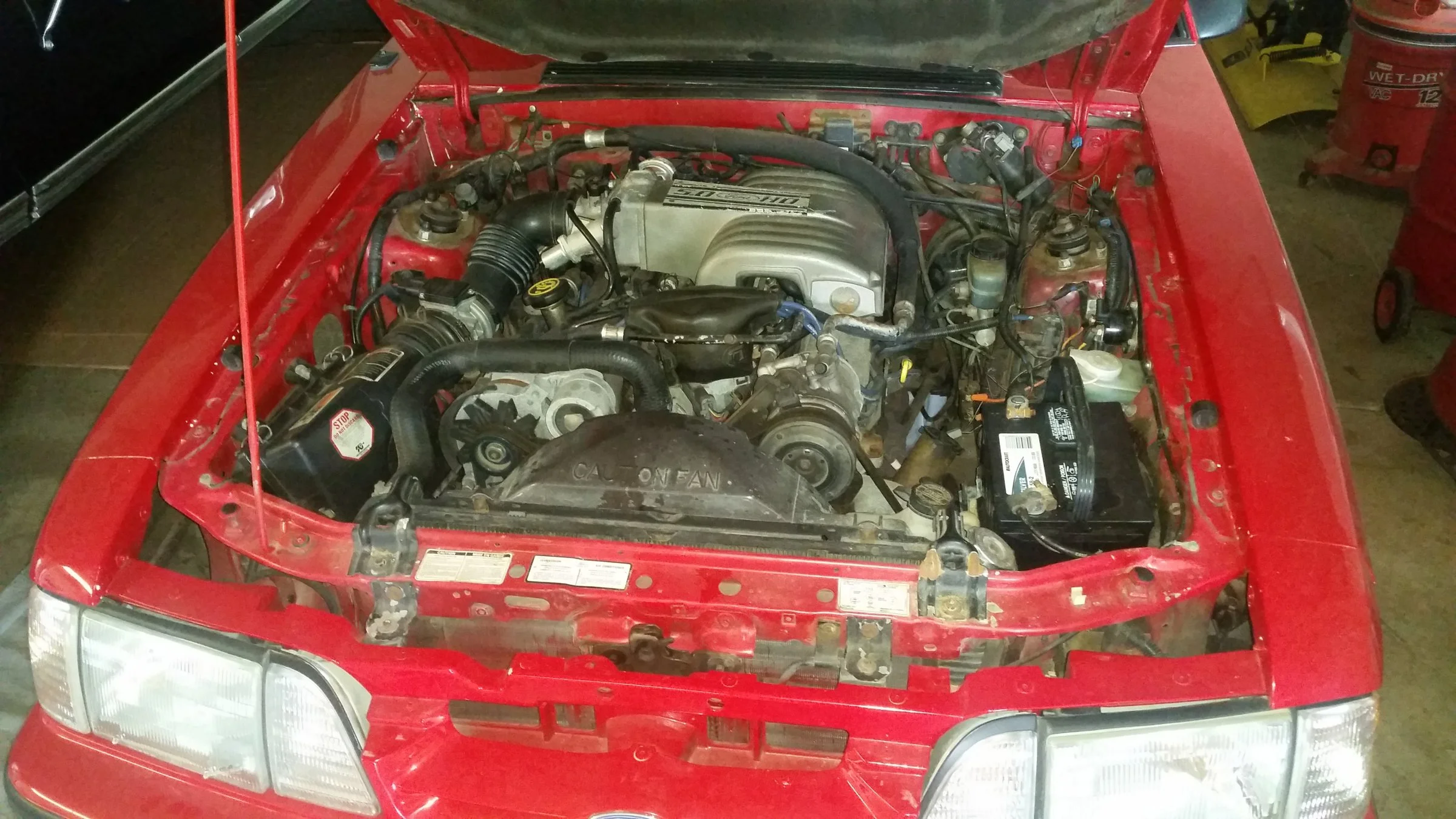

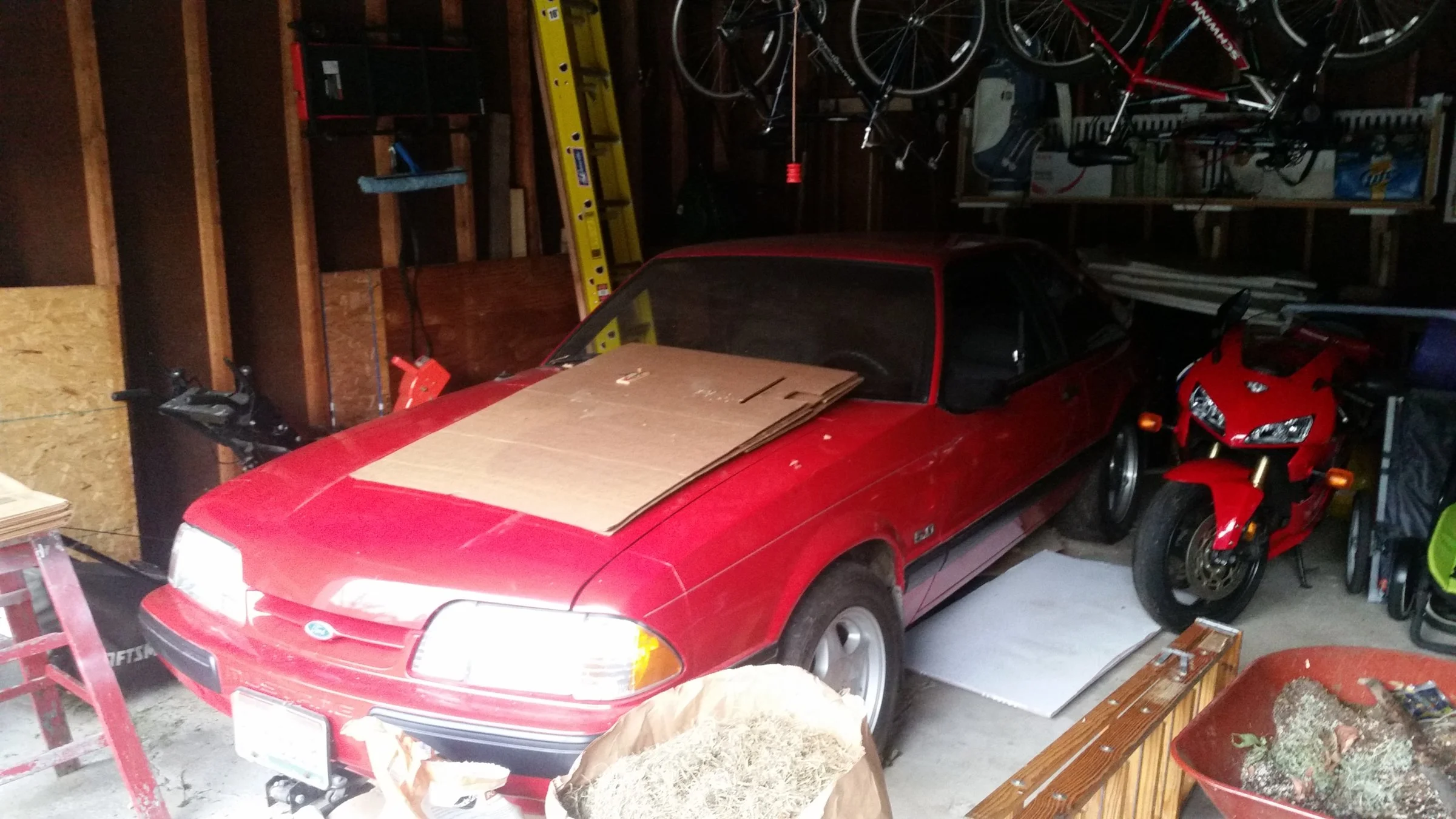

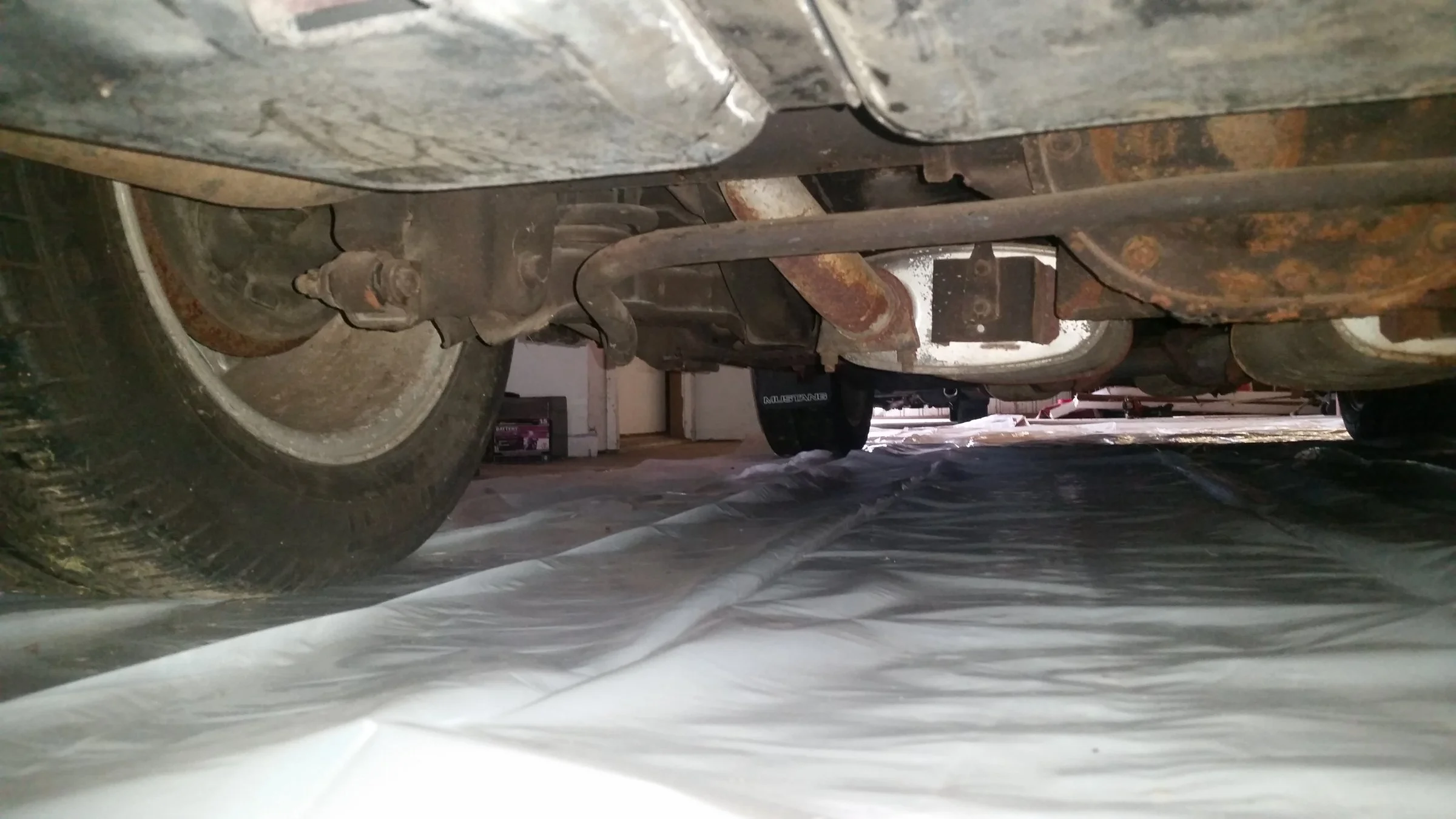

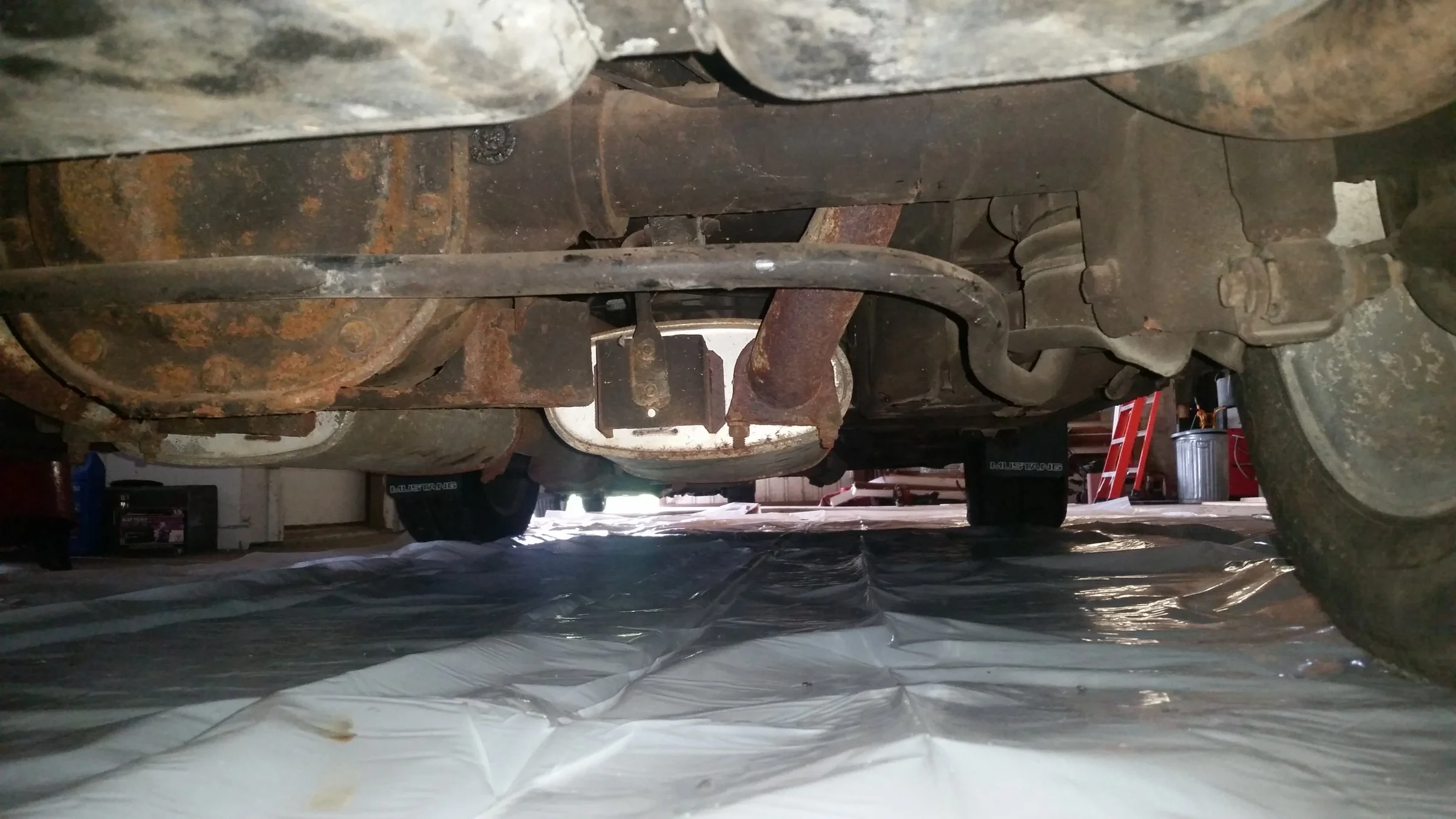

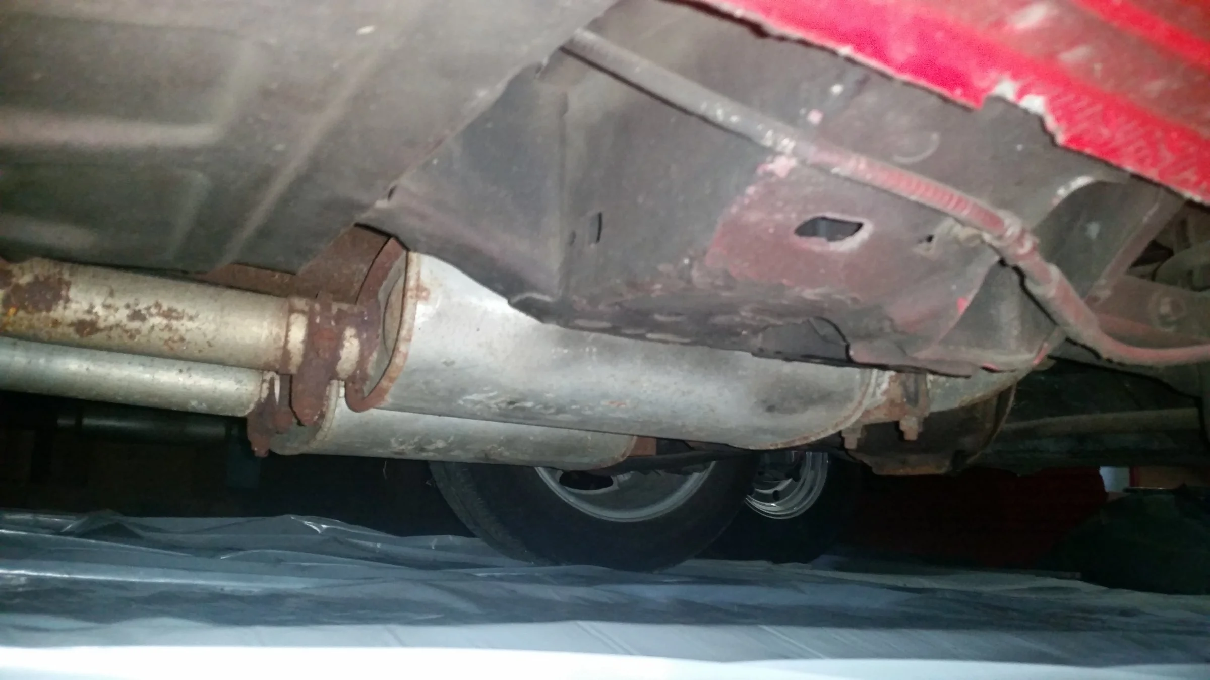

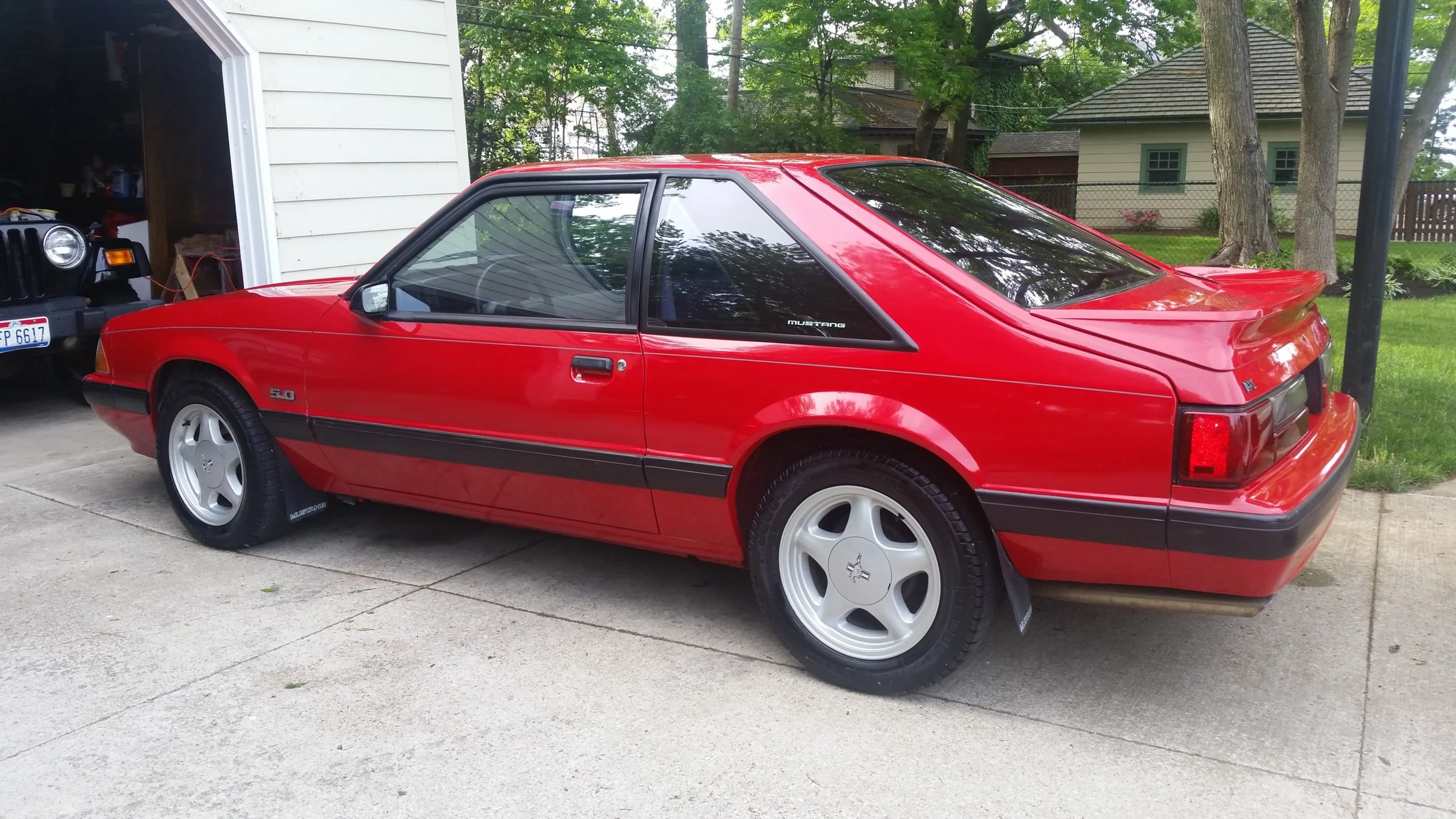

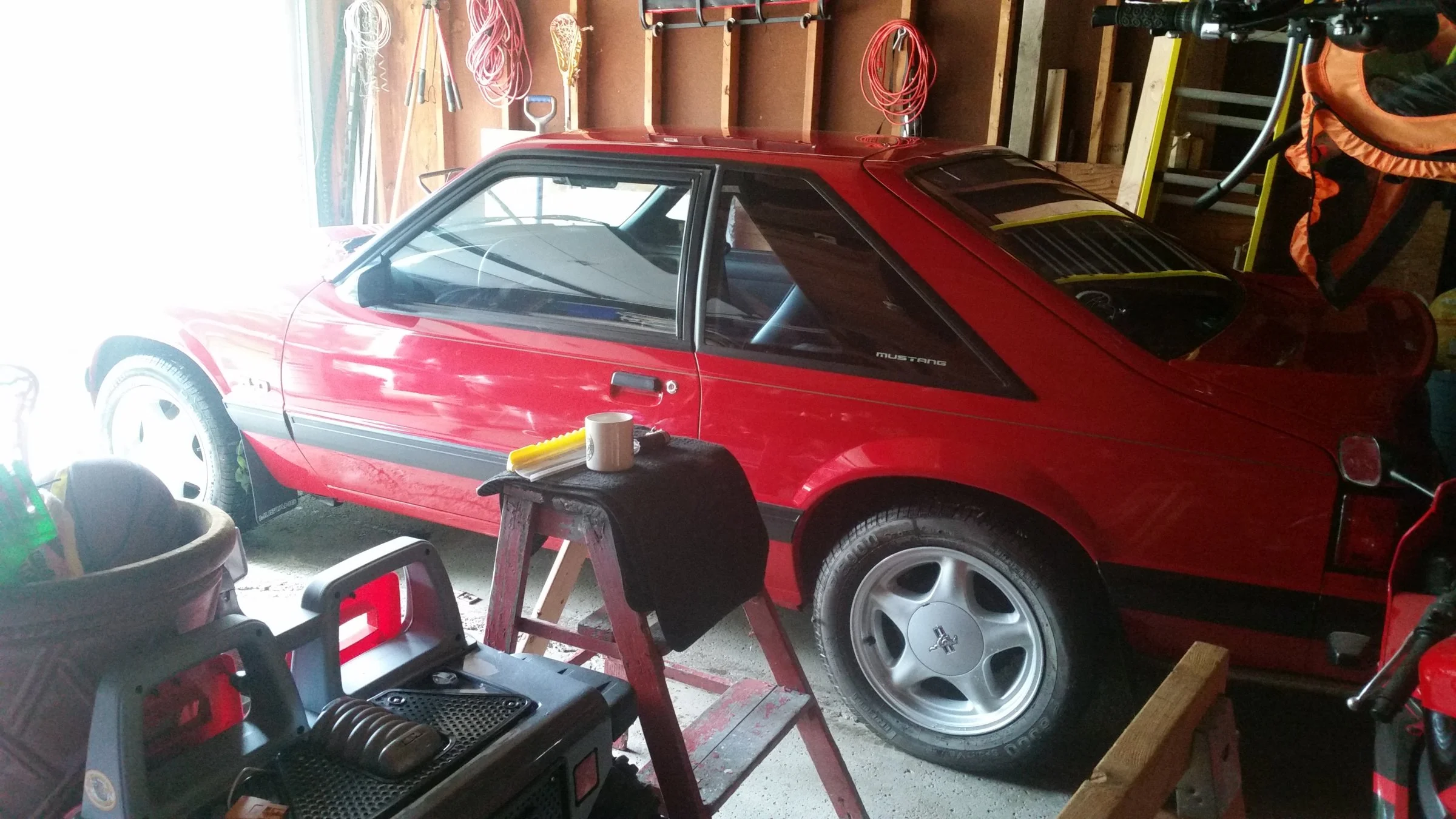

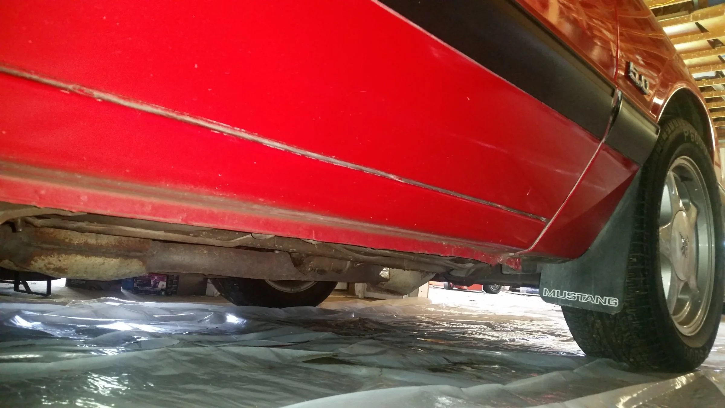

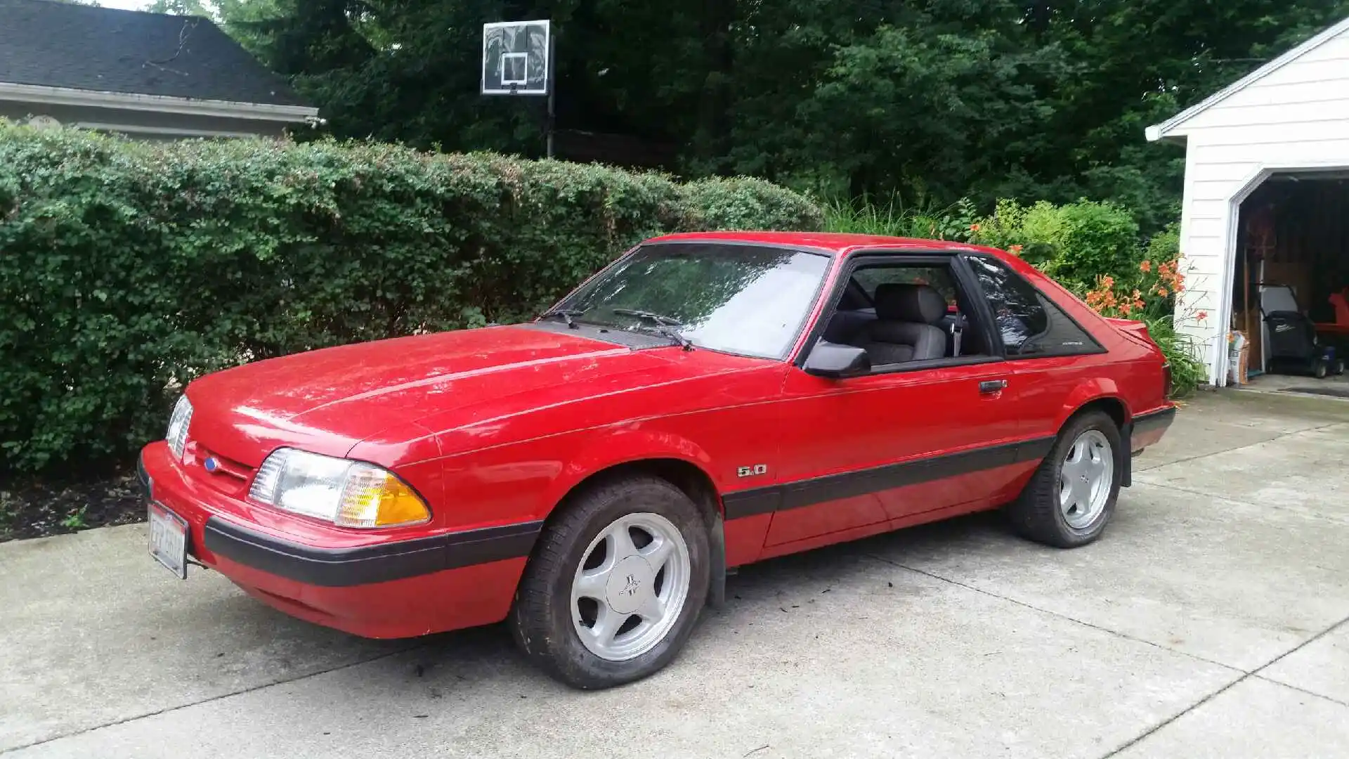

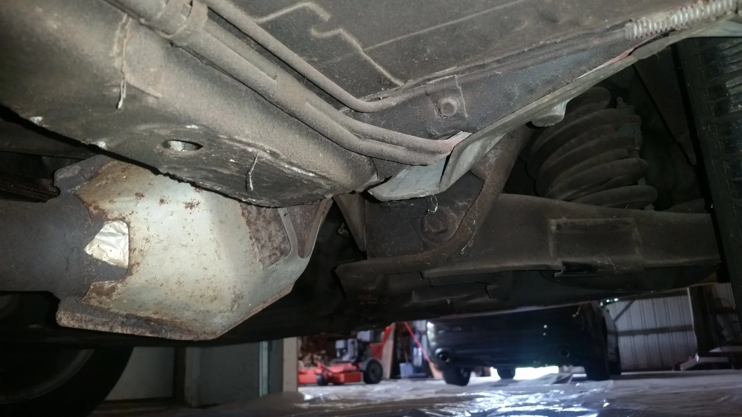

I posted my pics to the wrong thread somehow. This is not going to be a dedicated track car. At least not yet. I still want to have some fun with the 302 and make this a budget build rather than make a full blown race car. I have so many mods that I'm looking at. The things I listed in the initial post is just the tip of the iceberg. I'm looking to make a car that is fast and fun to drive. Mustangs power to weight ratio makes it a blast to drive. Reminds me of my go kart growing up. It just needs more power. I haven;'t driven it long enough to know everything that it needs but That will soon change this summer. I'm posting some pics of the car when it was up for sale in 2016. I am also posting pics of the car when it was sitting in my brothers garage right before we started the resurrection process by putting in a new fuel system. There is some pics of the job we did. The car has no rust and drives great. The guy that was going to buy it turned it down with a low ball offer and now I have it. So here we go!

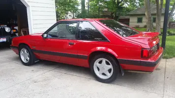

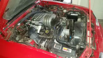

More pics for the potential buyer showing how clean the car is.

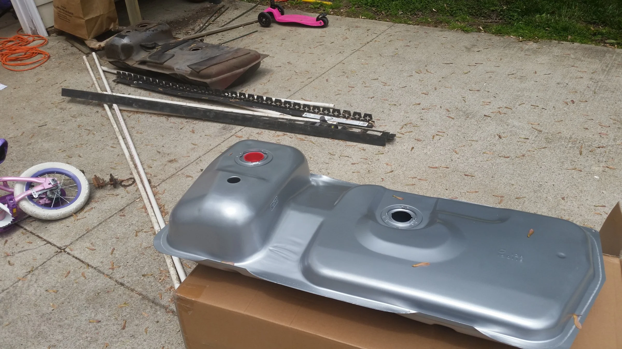

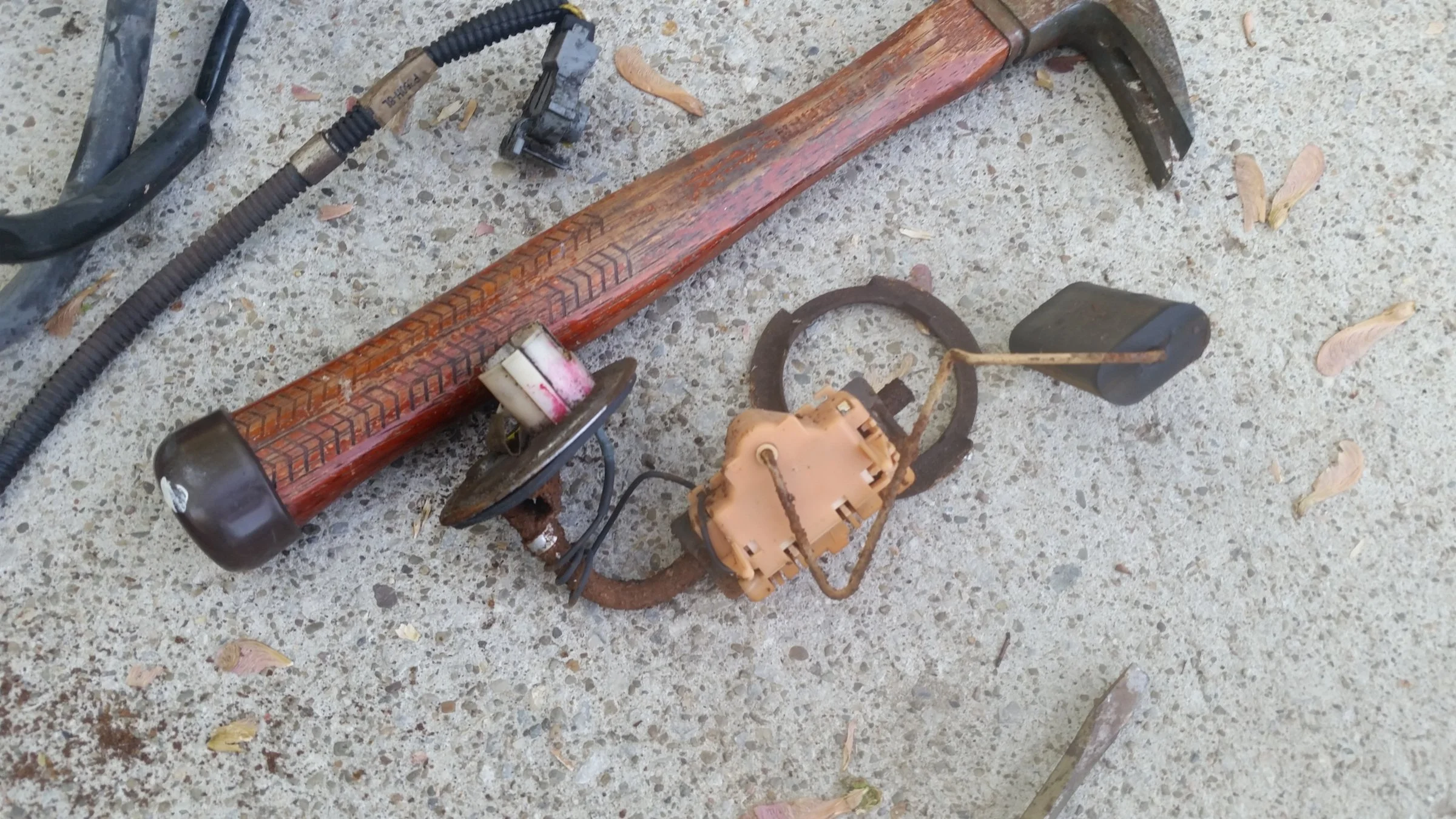

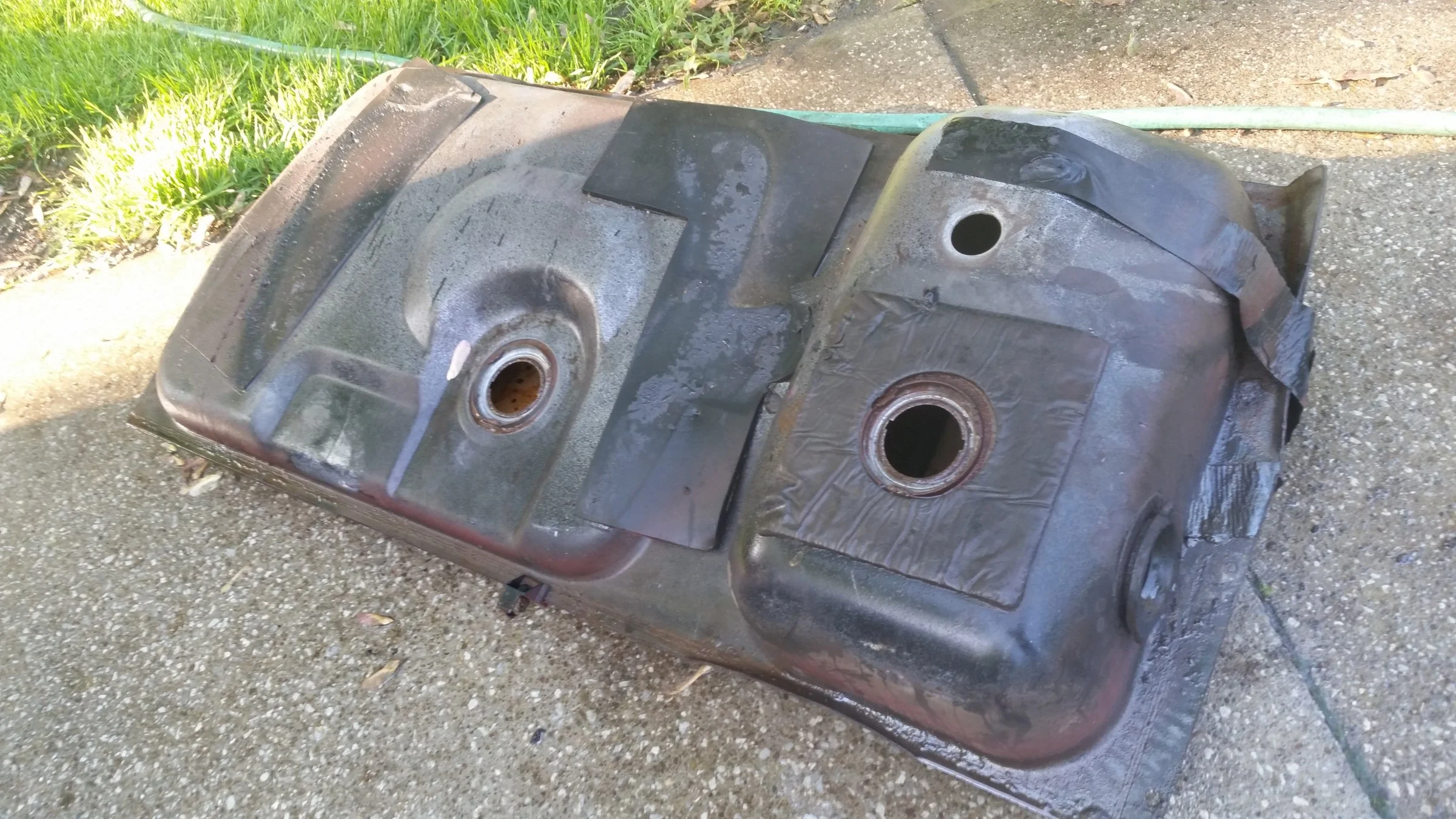

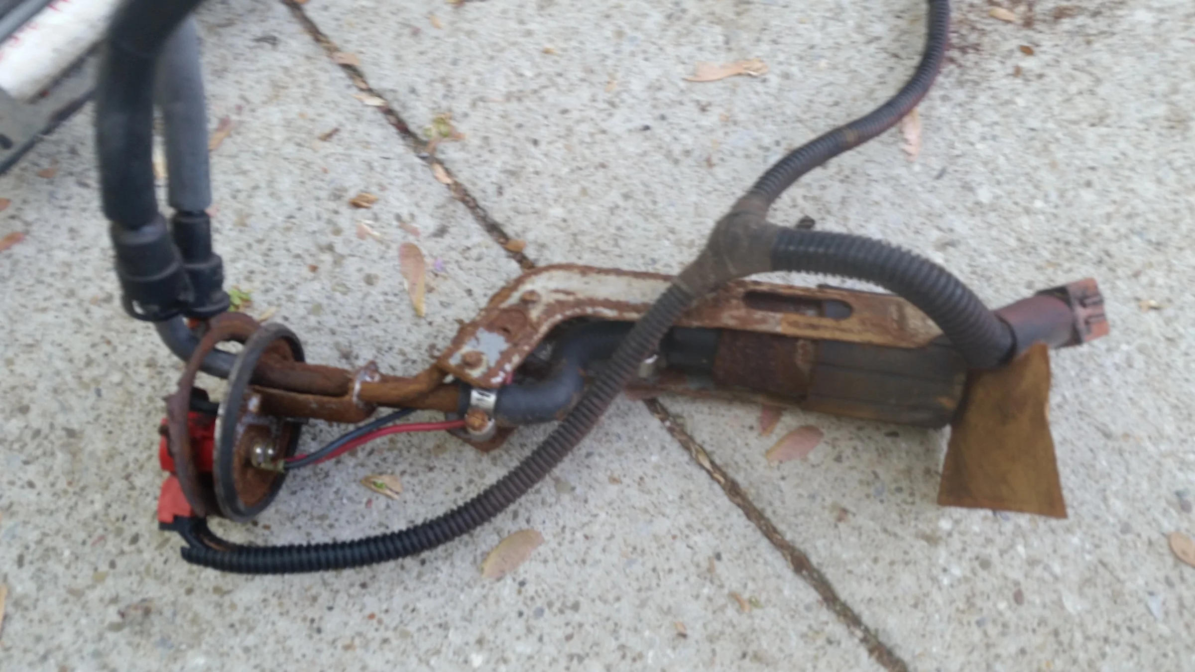

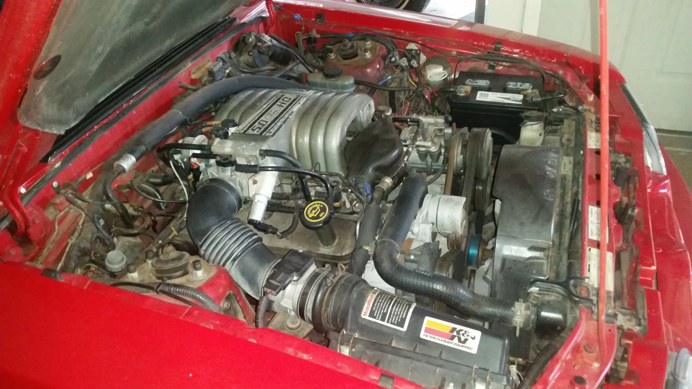

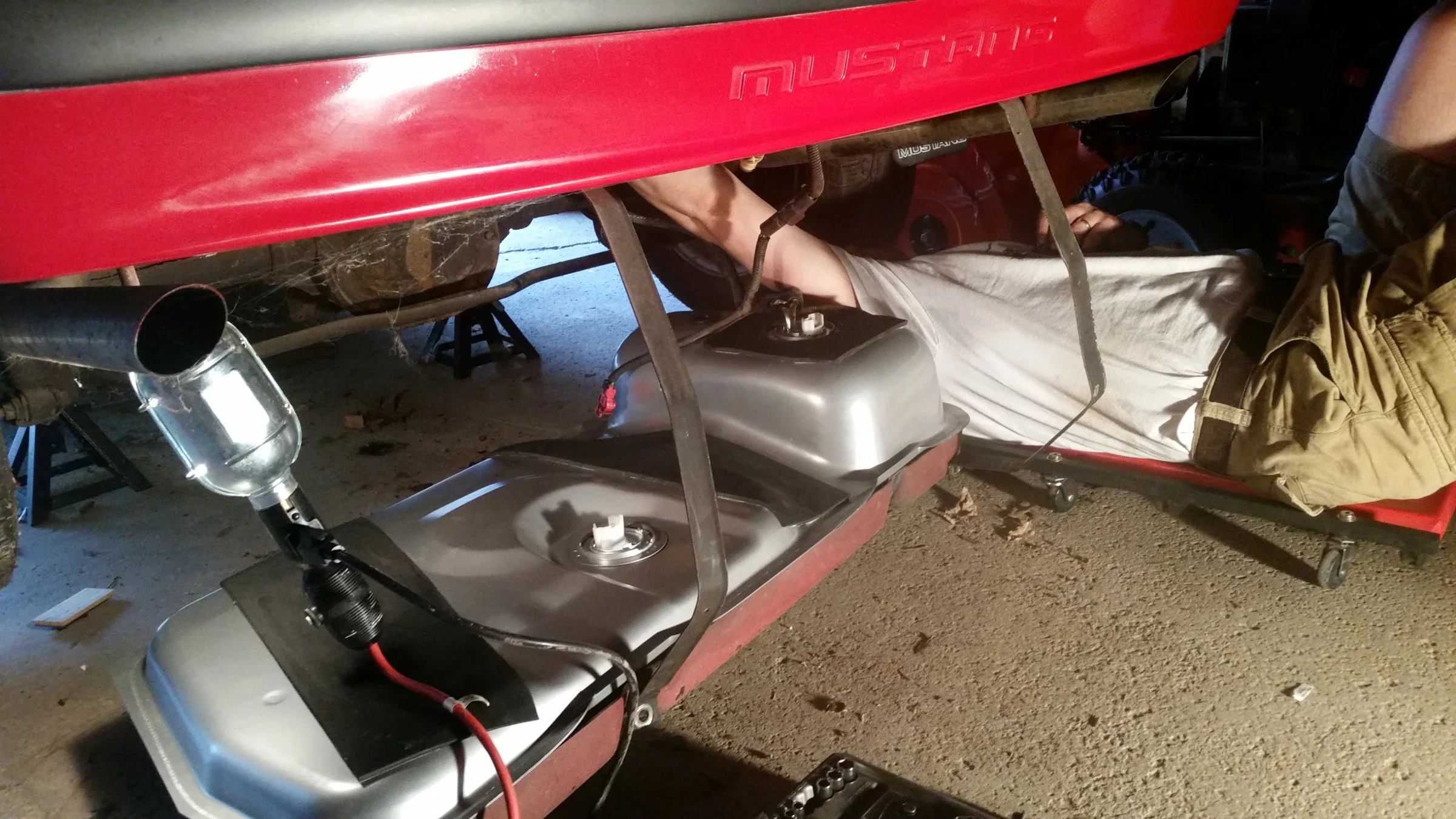

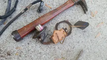

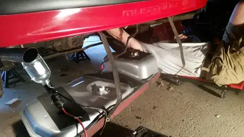

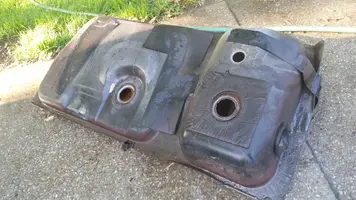

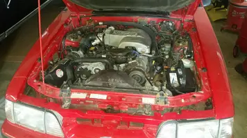

These are the pics from 2015. My brother and I got into replacing the fuel system and put in some fresh gas. She (the mustang) fired right up and pulled out of the garage. I'll post in the other Fox forum for the rest of this build. I just thought I would introduce myself.

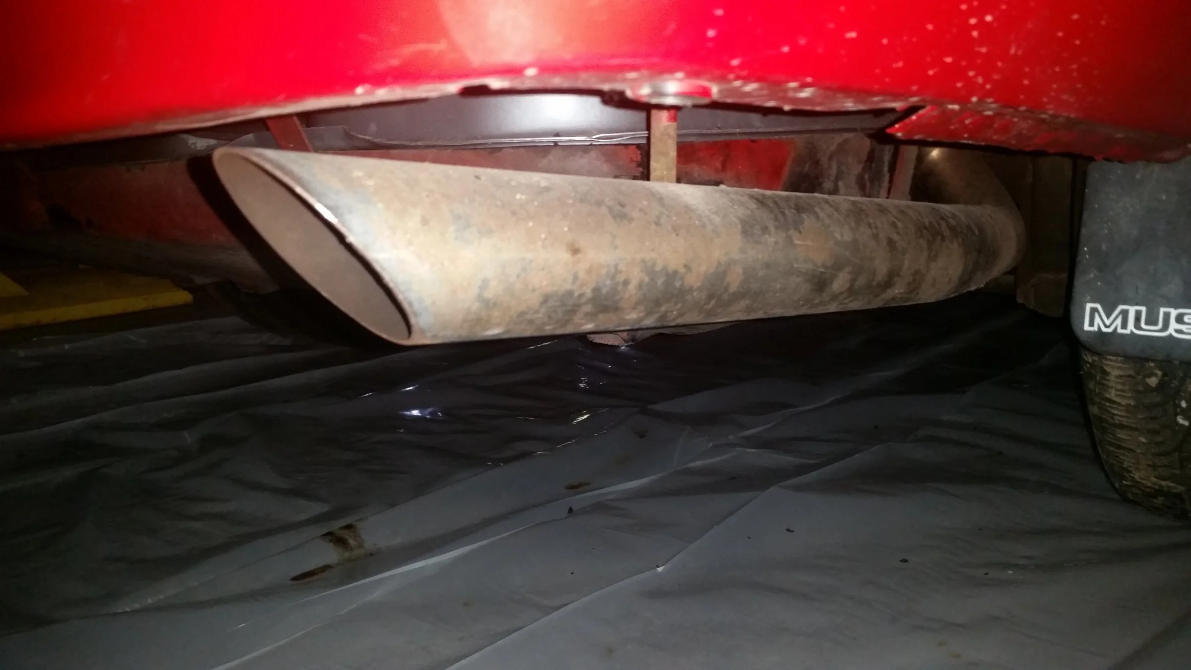

In response to your comment Dave, Why did everyone tell me to get a off road pipe? Everyone said to take the Cats off I will gain 15-20 hp. It has a Dynomax "Super Turbo muffler " which is a true dual exhaust. The Under drive pulleys are waste? The car really :poo:s and gits off the line. I read that the under drive pulleys reduce drag on the engine from the accessories on launch and gives the car more power to the transmission. The car really hauls. However I'm here for advice and help getting my fox into peak performance. So, I'm listening.
Just to address the underdrive pullies, you'll gain maybe 5-7 hp from that mod. You'll gain more from an electric cooling fan upgrade. In addition to the removing the power leeching effects of the stock fan, you'll gain the more efficient cooling as you upgrade your engine for more power.
Then again, you'll loose charging efficiency near idle with the underdrive pullies.
If you plan to upgrade any electronics, is: electric fan, stereo, computer mods, etc....You'll need to upgrade your alternator to the 3G or 4G setup. 130 amp would be sufficient for most add ons. Same problem with the underdrive pullies here again, it'll slow the alternator down, less power from it.
Do you notice your headlights dimming near idle?

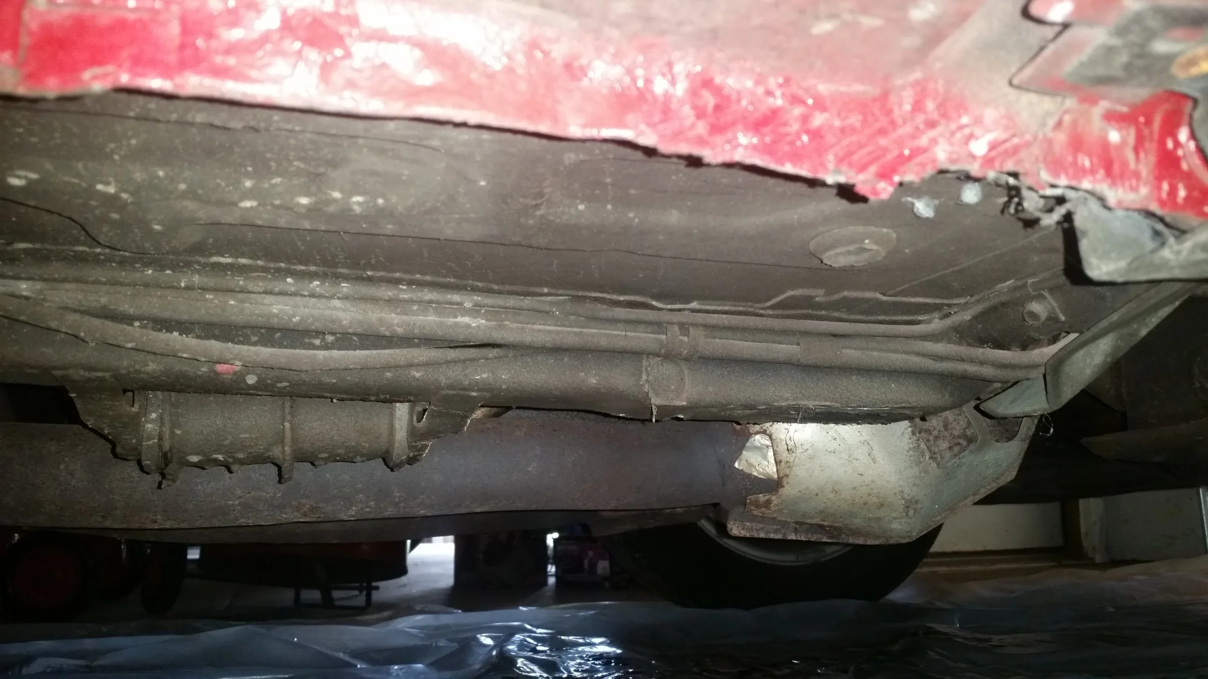

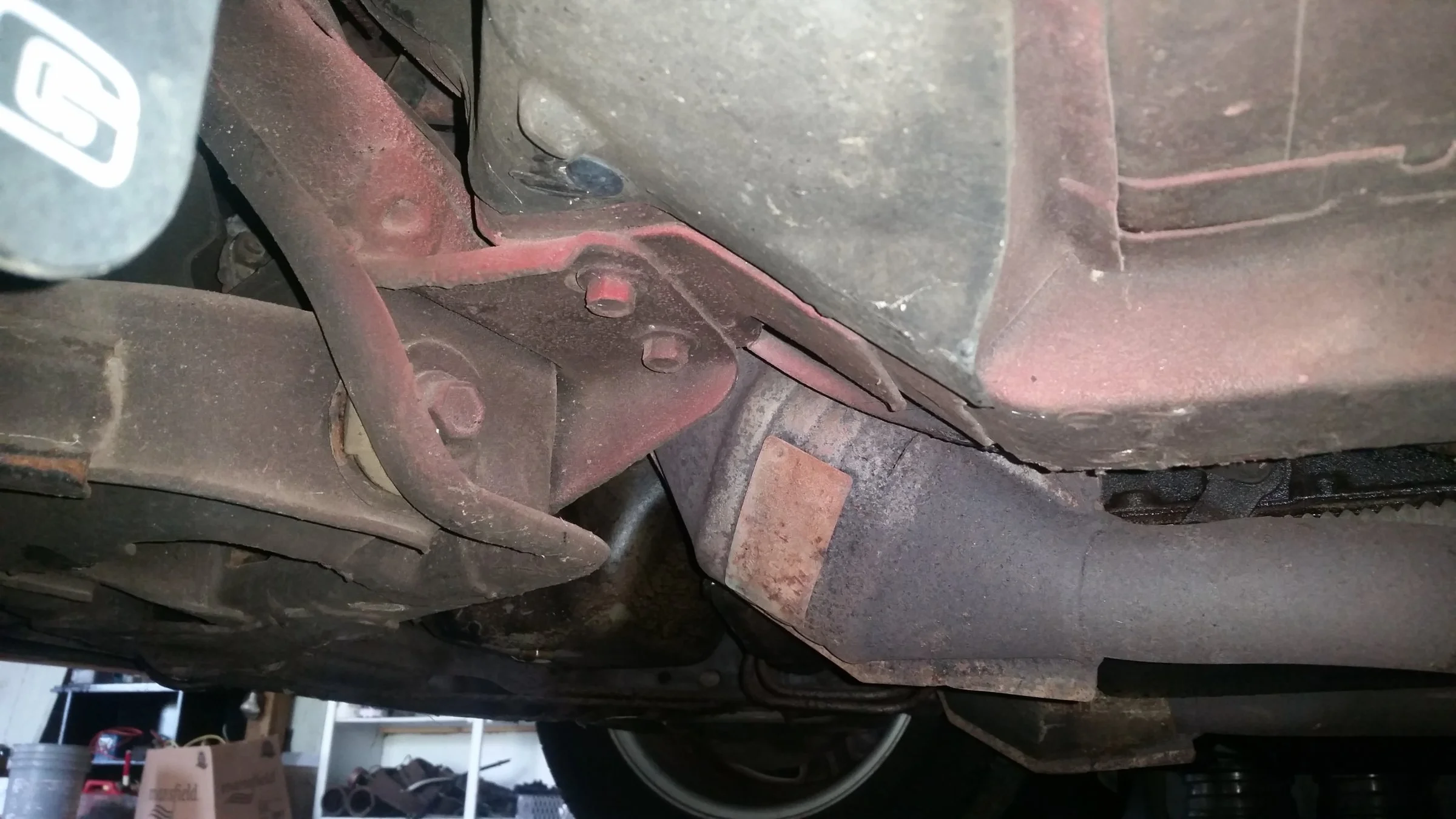

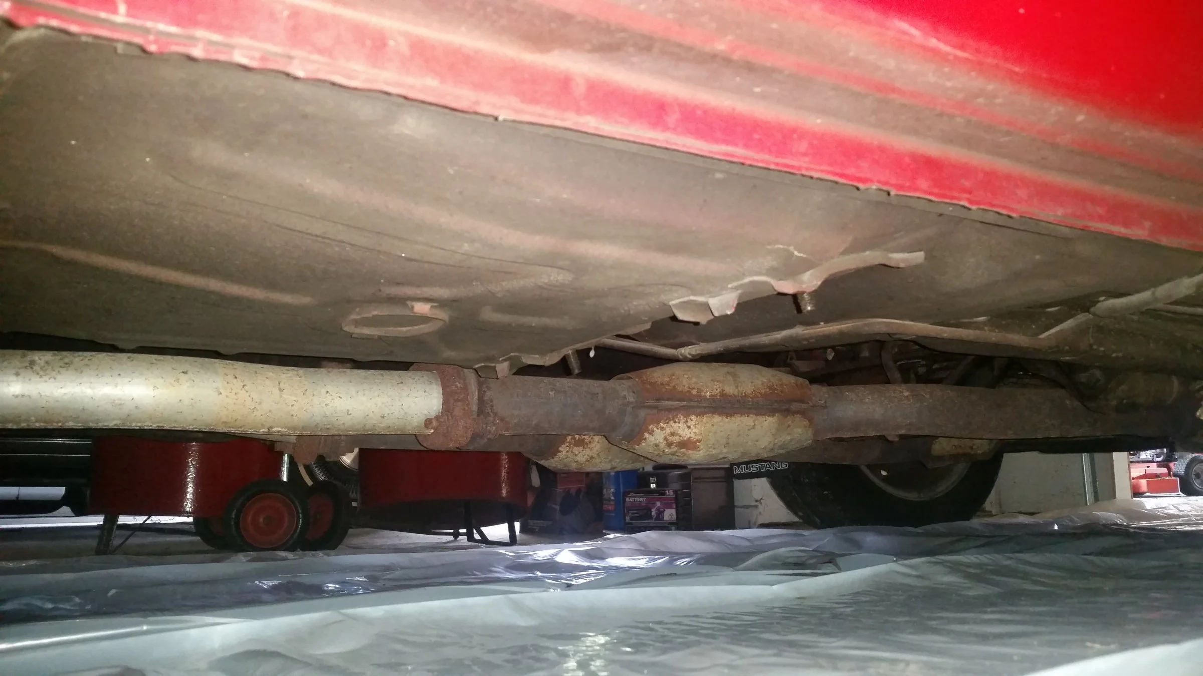

Also, the exhaust. You gain power from the larger, smoother tubes of an aftermarket exhaust system that are designed to flow your exhaust gasses efficiently. Upgrade the cats with the rest of it. Do an in depth search on the effects of cats and performance.
Not just what stock cats do, include the aftermarket ones available. There isn't a 15-20hp gain from eliminating them, the gain is from a better exhaust system.
Honestly though. It doesn't make much difference in hp with or without, the difference for me is in the exhaust smell. I know it sounds like a little thing to spend the extra on to have.

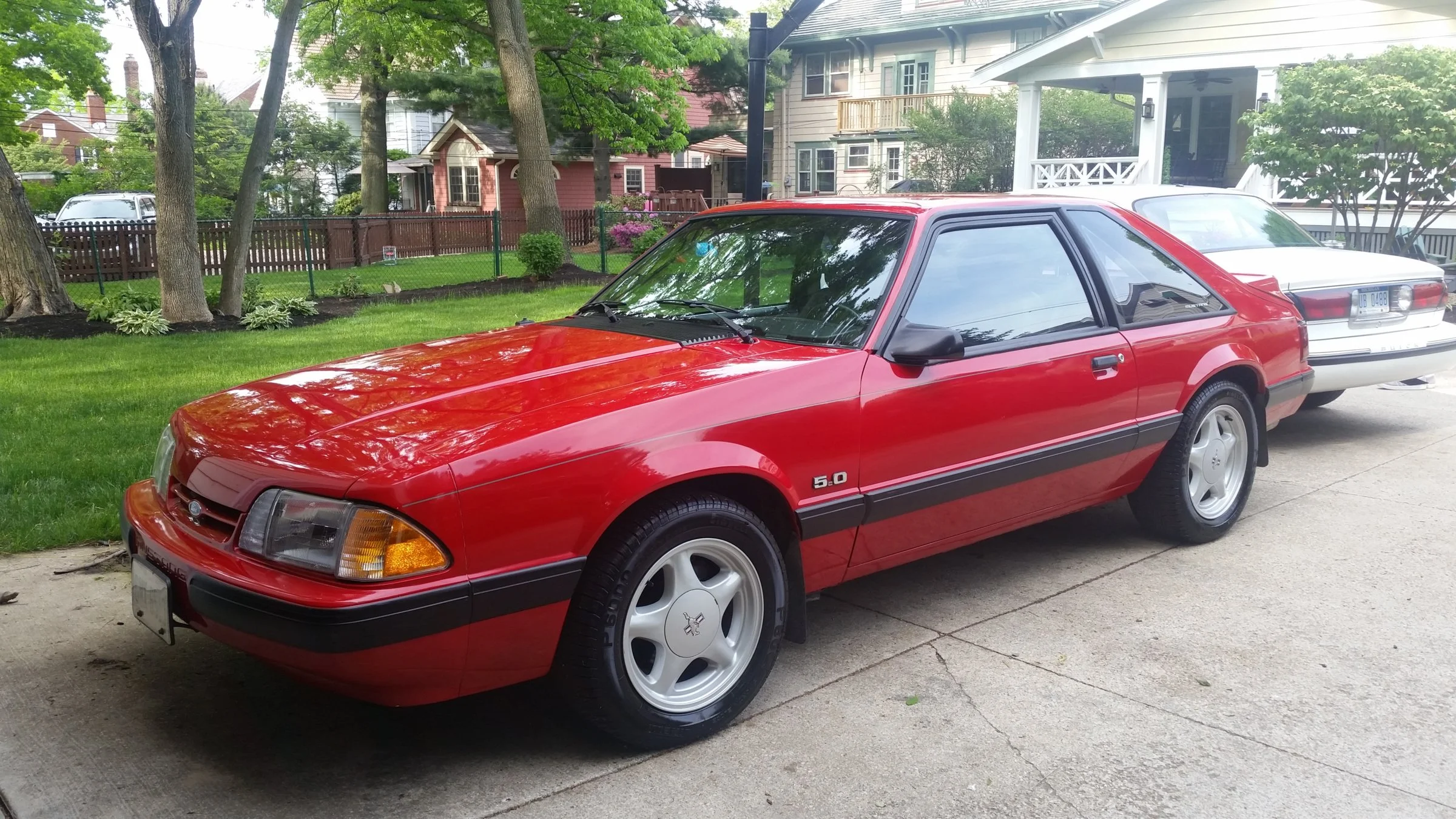

Lastly, your mustang looks fantastic. What a great starting point. Like I mentioned before, look around the fox subforums. Post a new thread of your progress as you get going in the general talk section, the guys there will love seeing one that started out that nice.
Good job on the fuel system too, btw.:nice:

I have done some research and I understand the exhaust I am running has a 2.25" pipe. I did however think the Cats were restricting. OK. I'm with you know. I called Dynomax yesterday and they informed me that the exhaust system that is installed on the car is rated up to 360 hp. So if I'm going to get down with engine modifications the Exhaust it going to have to change. For this summer I think I will be OK. I have plenty on my plate at the moment. I think Frame, Brakes, wheels and tires are first on the agenda. Which does dictate a lot of the setup of the car. I liked your comment about the 96 and and later 5 lugs brakes for a wider tire. That would probably drastically improve turning on a road course or winding road. The 302 only has 49K miles on it so I am hesitant to just pull it at this point and put in something more advanced. baby steps, I'm on a budget.
Thanks for the info on the under drive pulleys. I knew that they caused a drag on the battery at idle. I wouldn't want to be stuck in a traffic jam in that car running the AC listening to the radio at night. That's another thing everyone keeps telling me is to ditch is the AC to save weight. I want to keep the AC. The AC doesn't work at the moment. The car takes R12 and I was told to fix and fill would cost me about 2k. So that isn't happening. I was also told by a local mechanic in my area that I could repair the leak then change the filler nipple and put in R134. Any fixes to this problem I am all ears. I want to keep the AC. I appreciate your responses. Thanks.

I'm not big on Fox-bodies, but, my god does that one look beautiful. You've really got a great ride there. I understand the desire for more power and such but I'd leave a 28-year-old car in that great of shape unaltered. That's just me though.

Your exhaust? A nice 2.5" system will take care of you until you go insane on power (550ish~rwhp).
