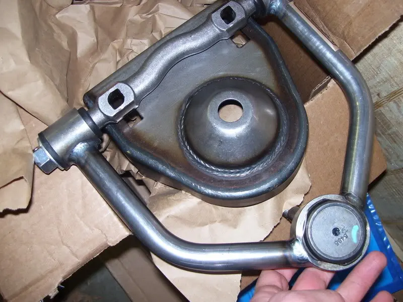

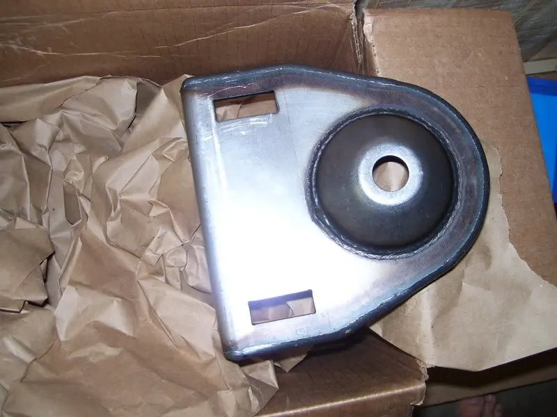

from what I have read the maximum adjustment on it is -.5 degrees...at least for the heidts kit...which is what I have....anyone know first off whether this is true? I looked at the "hats" which weld to the top of the frame rail and they have slotted holes where the upper control arms bolt to with vertical bolts...presumably to adjust camber(makes perfect sense) just wondering f I slotted the holes a bit further whether this would allow more negative camber...I'll take a picture and post it if it needs clarifying
sla units? I would like to say I am just starting to learn about suspension characteristics and terminology, but isnt caster the angle between upper and lower pivot points? I would think that would require slots starting toward the front of the vehicle and running rearward, front to back so to say, the slots on the "hats" start at the passenger side and run toward the drivers side(or vice versa) I have trouble imagining slots like that used to adjust caster, though I can see toe in/toe out adjustability, keep in mind this isnt a mustang II, its a heidts IRS system based around the mustang II design....the original mustang II system also has strut bars, whereas this kit has tubular upper and lower control arms

here are a couple of pictures I just snapped....I cant see these slots being used for adjusting caster....camber and possibly toe in/toe out, yes
ok i see. that slot is for camber and caster. you can tilt that control arm while in the slot to achieve your caster needed. those slots look like a good size for getting proper camber adjustment.
didnt heidts send you info about adjustment capability when they sent the kit?
the instructions for the kit are minimal and their "suggested" camber setting is +.5 degrees...however they dont actually say how to do it..(besides, positive camber isn't the best for handling).so I'm working from what I can see...poor instructions(though still good enough to install) but very good quality stuff from what I can see
