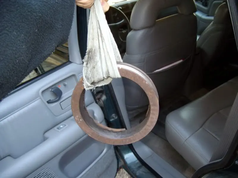

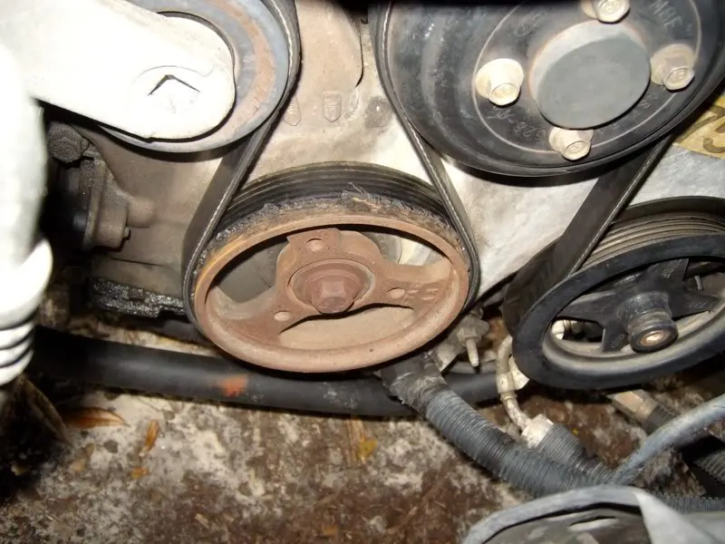

So i spun my balancer off today...
Steeda sells just the crank pully for $150 but it will require a belt change from stock.
I have a stocker in the shed I guess I'd sell for about $50 if your interested. I'll PM cell phone. I work at FSU so I could bring it tomorrow.

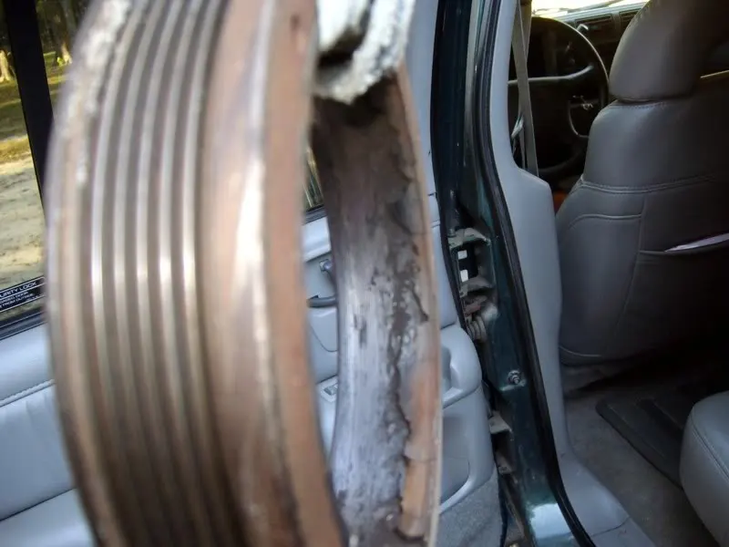

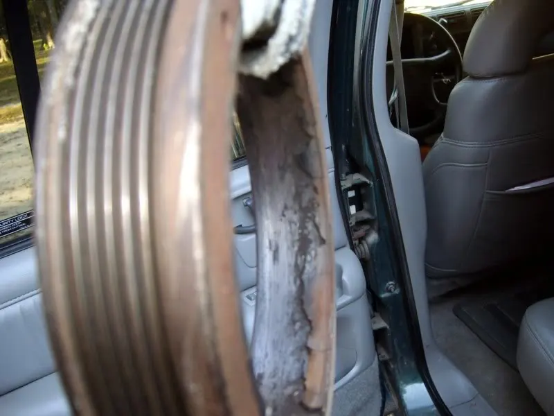

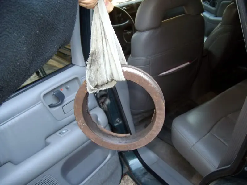

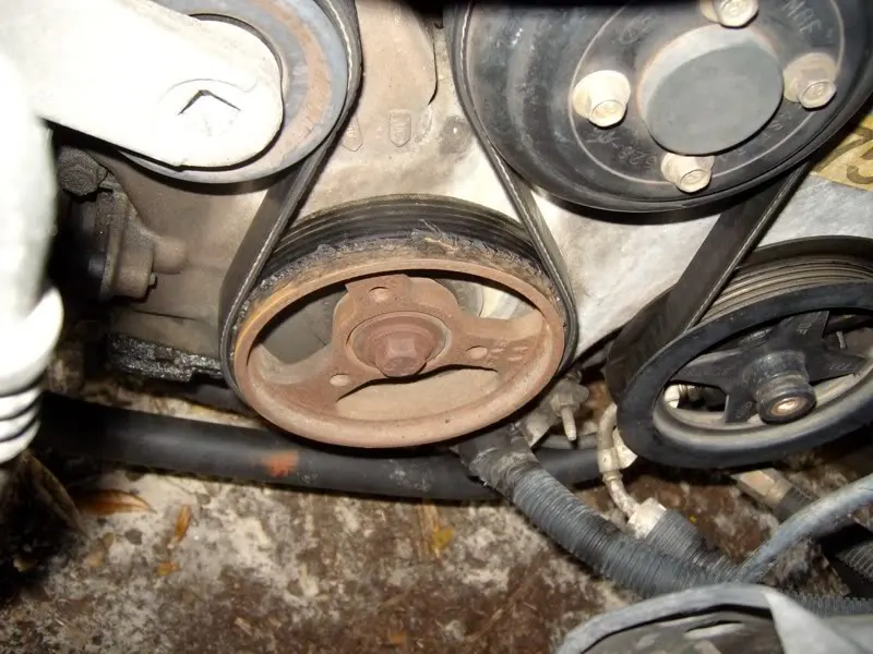

This is hilarious, the area in red which is the outer part of the pulley separated by injected rubber actually slung off. I'm guessing cause of age and the rubber being dried up and cracked. I guess the belt somehow came back on using the tensioner, but i drove home no problem.
wow, i never noticed that was rubber, it must have been dry rotted realy bad....
