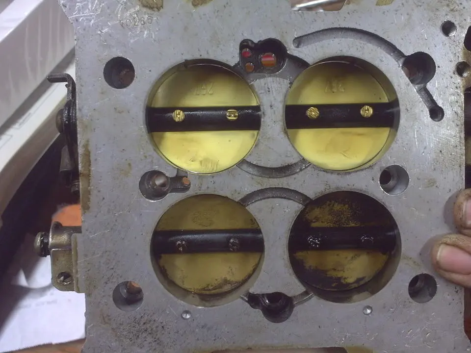

im posting pic's of my carb 4b holley because
i was just wondering why my primary butterfly's are so clean and the secondary's are dirty i was getting realy bad gas millage so i decide to try my hand at rebuilding my first carb i think i will be ok on that just wanted to see if any one could tell me any thing about it being clean on the primary's thanks
ok th pic's are 2mb each i cant upload but like i said the primary's or the side to the front of the car that the fuel line is closer to is the side that is so clean like out of the box clean
That is normal for a engine that has some valve leaks or a large overlap cam.
What you see is the primary is washed by fuel all the time and the secondary is closed most of the time and you will get this black soot
