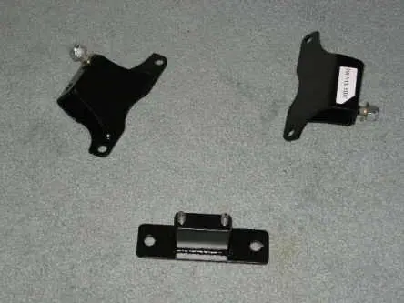

I got the Maximum Motorsports Solid Mounts today, all three. Definatly nice peices. I guess I'll just have to find out. Will post pics tomorow if people request.

I have the poly mounts as well, I might run the poly tranny mount, but I am definatly going with the solid engine mounts. I'll probally run one then swap to the other and then make the decision from there. Anyways, they are some nice looking pieces. Here's a pic:
