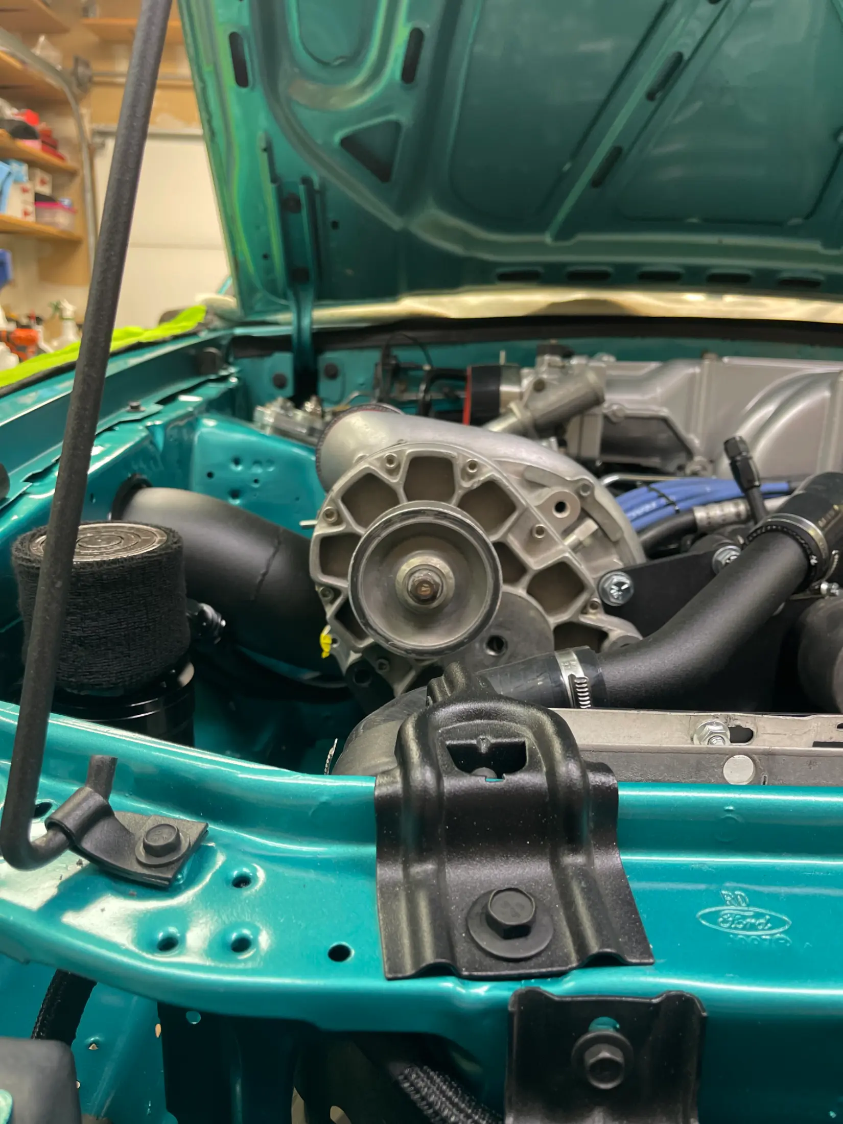

92 LX UPR k member 8.2 deck motor with s trim. Car was running driving no problem. This winter pulled motor to paint engine compartment and change pan gasket. I noticed the motor mounts were smoked and ordered new ones. Car all back together, looks amazing runs perfect. Went to put the hood back on and no go. The hood actually hits the case…….not the clock able outlet. Order engery suspension motor mounts thinking the summit/pioneer brand mounts were wrong and same issue. I do not want to go to the solid/drop mounts.
Anyone have any ideas? I’m stumped. Been into foxbodys since 93 and not my first rodeo.

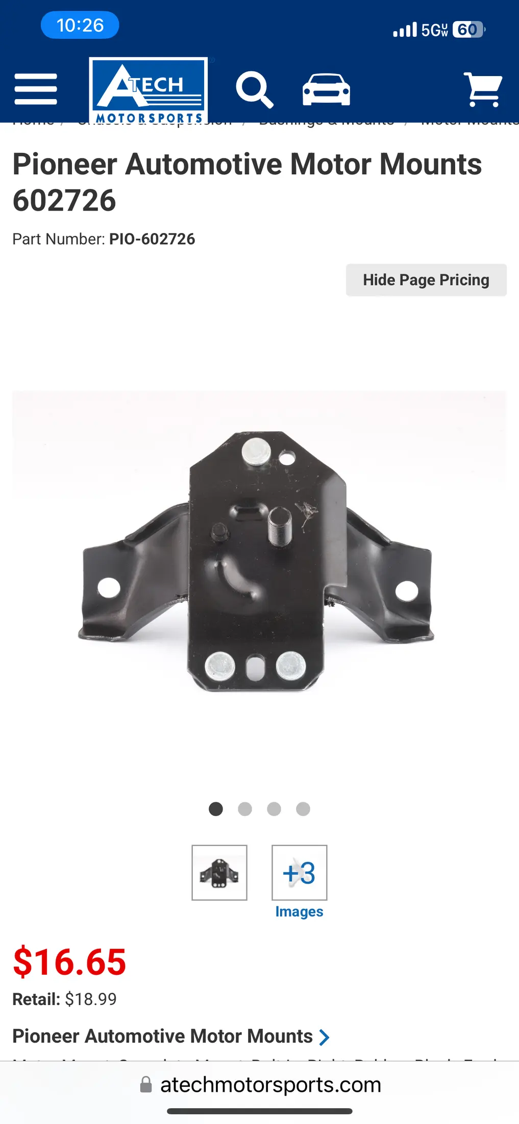

Hmm, looks like it should fit. But I was reading a review on Summit where the person said to get it to fit requires modification.
One other sites list it as ‘universal’ fit. That’s a tough one.

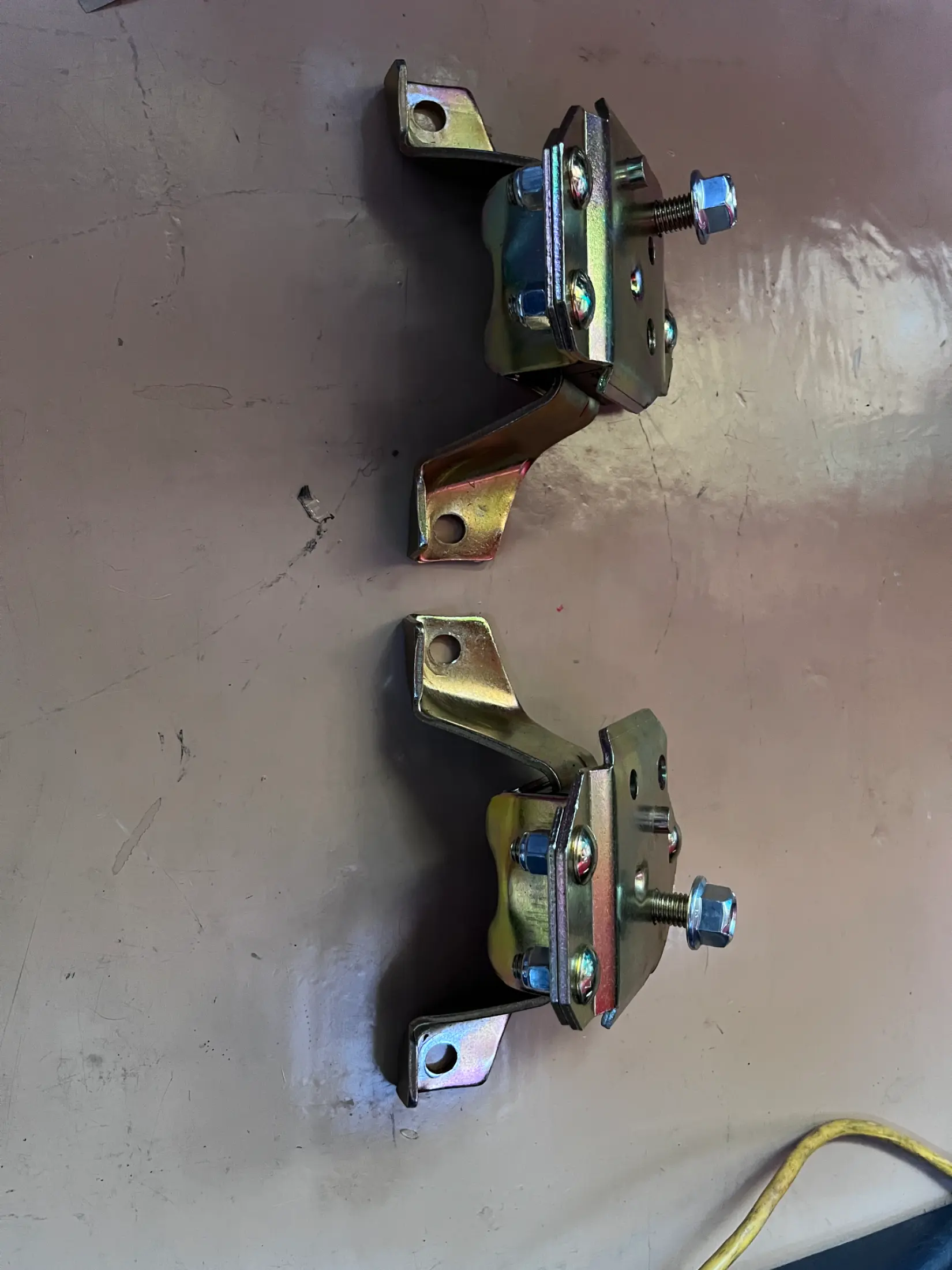

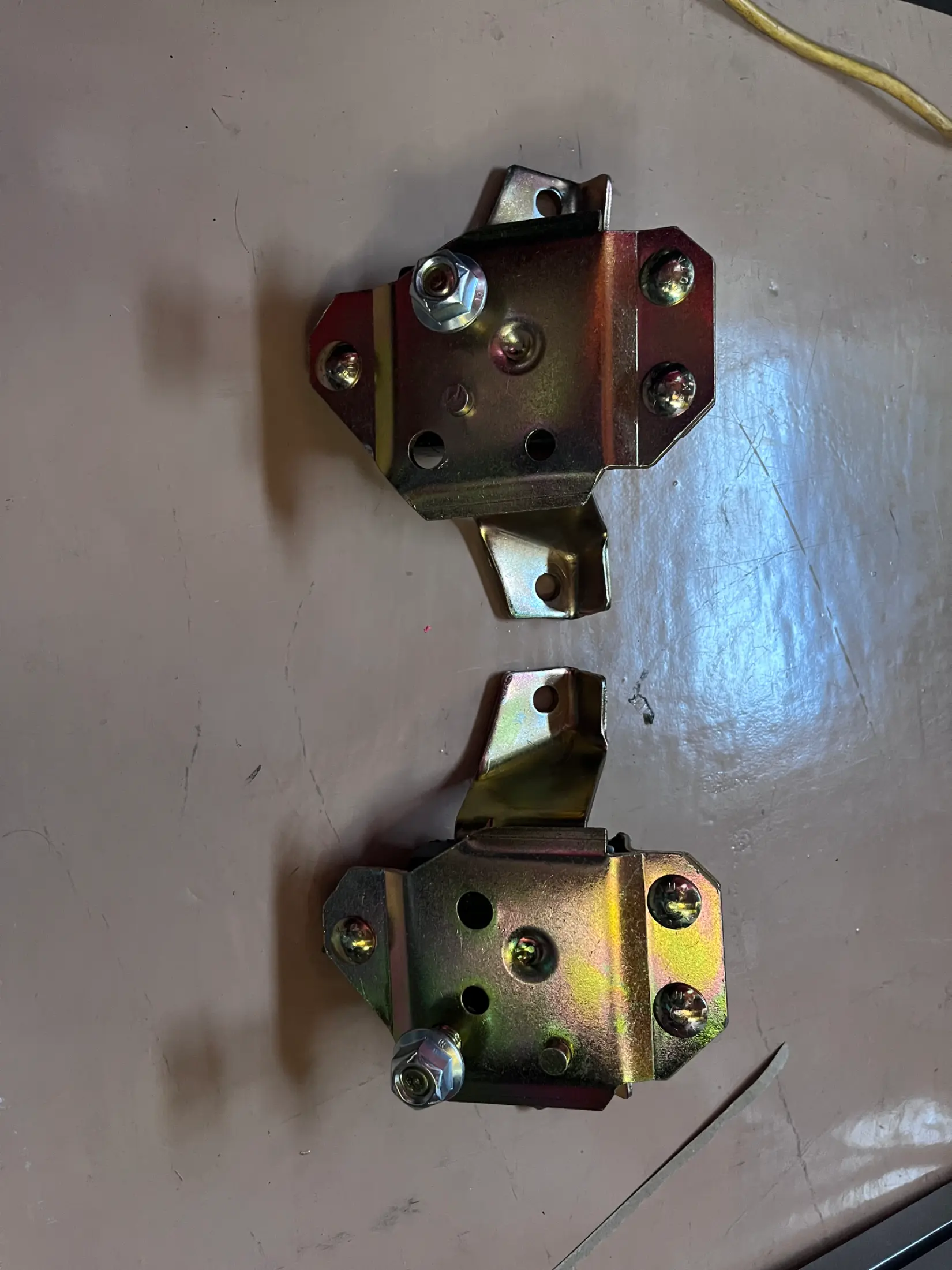

I don’t know if this helps at all but here’s some photos of the mounts I have. Energy suspension. I just happen to have them out as I also need to install them:
Does anything look different?
