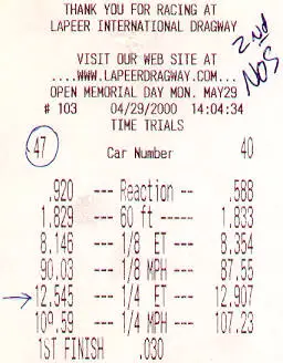

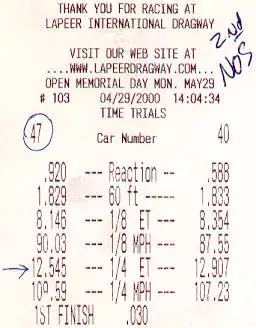

here is a timeslip from my old '89 notch 5-speed w/ just 4.10's, et streets , and exhaust
here is on a 75 shot
