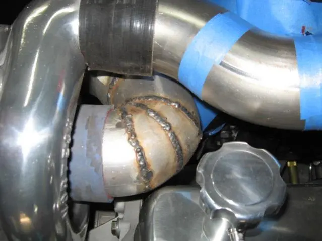

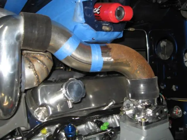

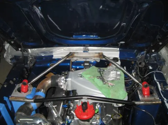

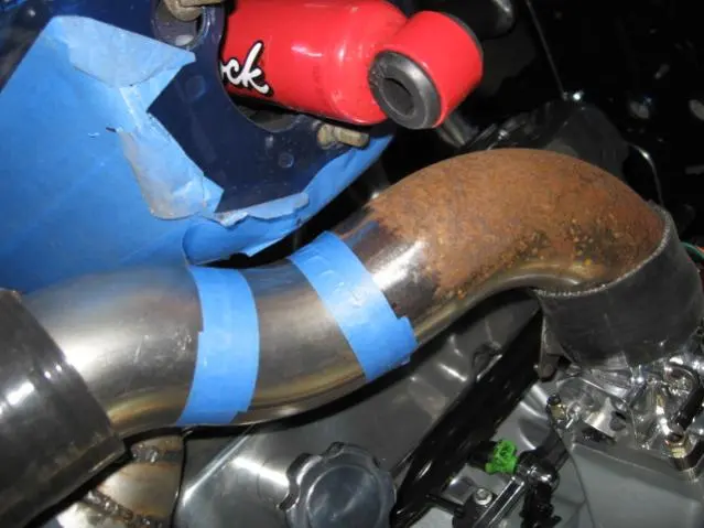

Some custom pipeing for the Vortech.

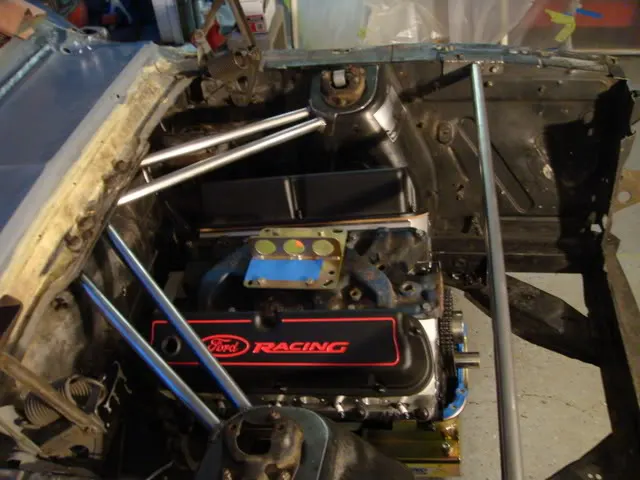

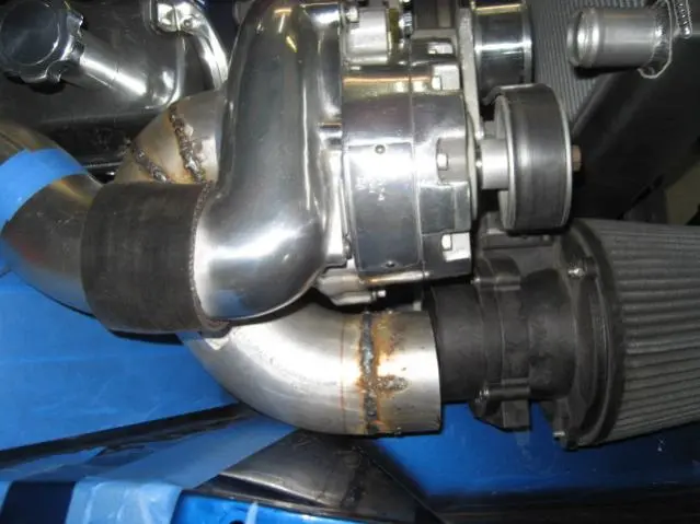

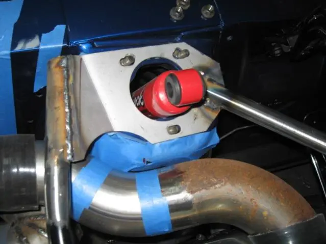

I had to address the same plumbing issues with my Vortech conversion. I was able to use the blower to TB tube but had to fabricate my air inlet in a very similiar way that you did. How hard was it to make the brace for the engine bay. I have been thinking of something like that from Jay at Mustang Depot.
[/IMG]

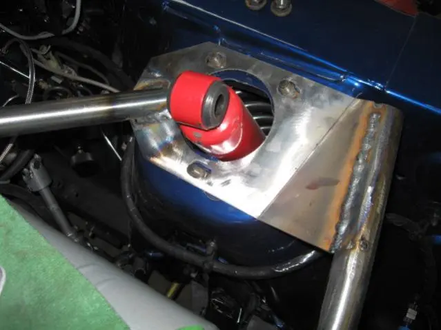

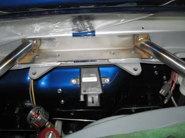

I got the brace from Laurel Mountain Mustang http://cgi.ebay.com/ebaymotors/65-66-67-68-69-70-MUSTANG-SHOCK-TOWER-BRACE-NEW_W0QQitemZ120366636673QQihZ002QQcategoryZ34200QQssPageNameZWDVWQQrdZ1QQcmdZViewItem
When I got it I soon found out that it fit like crap. I decided to cut it at every weld and weld it back together while attached to my car. I bent the main bar up a little for distributor clearance and I bent the drivers side tower to cowl bar up a little to clear the intake manifold. I tacked it all together on the car and then took it off for complete welding. It fits like a glove now and I can pull the distributor with it installed.

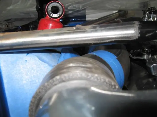

Keep in mind that I made the brace fit first and then made the blower tube to fit after. I also clocked the compressor housing on the supercharger to fit. There is about 1/2" of clearence above the pipe.
