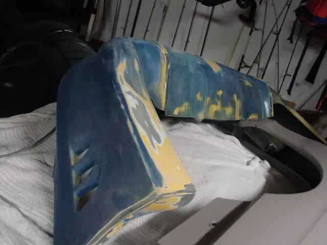

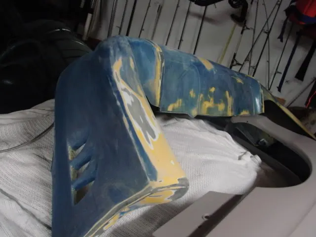

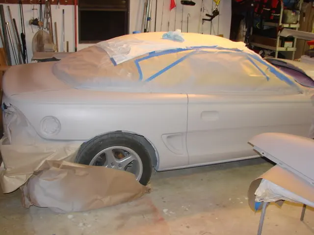

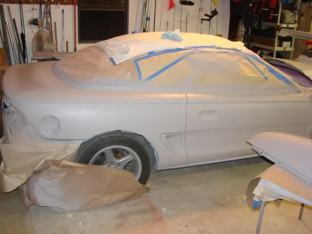

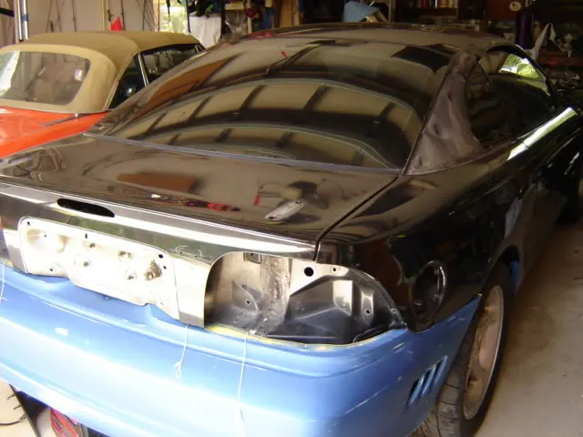

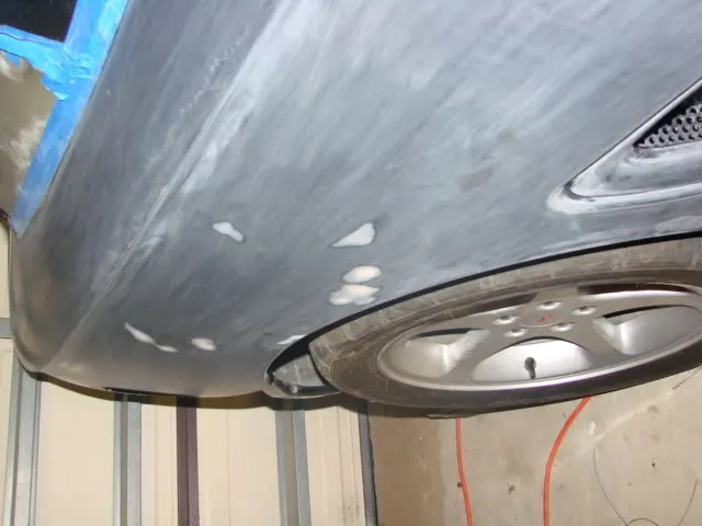

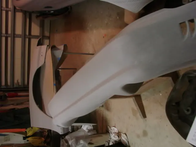

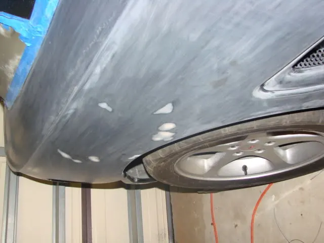

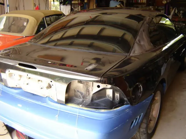

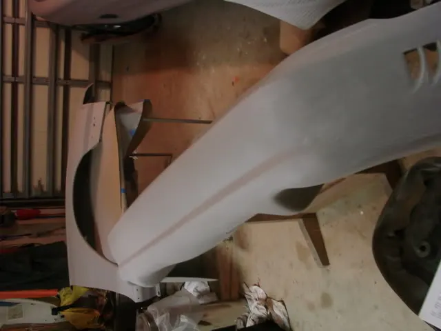

Good progress today! I primered the entire car (probably overkill, but I am trying to get it as nice as I can), fenders, and then a few spots on my rear bumper and my side skirt. Tomorrow I sand the front bumper, and then primer that along with the hood. Then Thurs and Fri I sand sand sand, and hopefully (If I find someone) Friday night it gets sprayed. Saturday I will reassemble, and then Sunday I make the drive back to school in Tampa. Monday morning I have class all day and then sometime during the week I will be wetsanding the car. Stressful past two weeks but hopefully it will pay off! This is the first time I have seen my car dent free, I cant freaking wait to go :drive: :drive: :drive: ~!!!!.
Before:
Saleen Bumper
Decklid with filled holes
Dent fixing
Test fitting the back bumper
After:

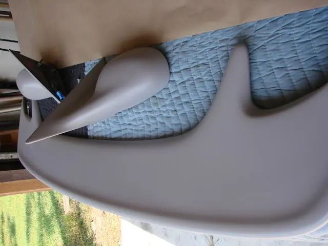

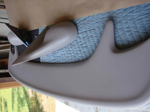

Mirrors and S281 spoiler
What I did today:
