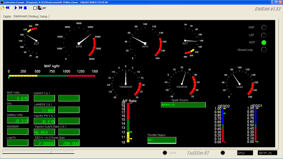

Don 95Vert said:
Anything you can do with a chip, you can do with an XCal2 - and the XCal 2 is the best Ford datalogger in the world.
Does it have cool real time digital guages?
That's a joke BTW.
