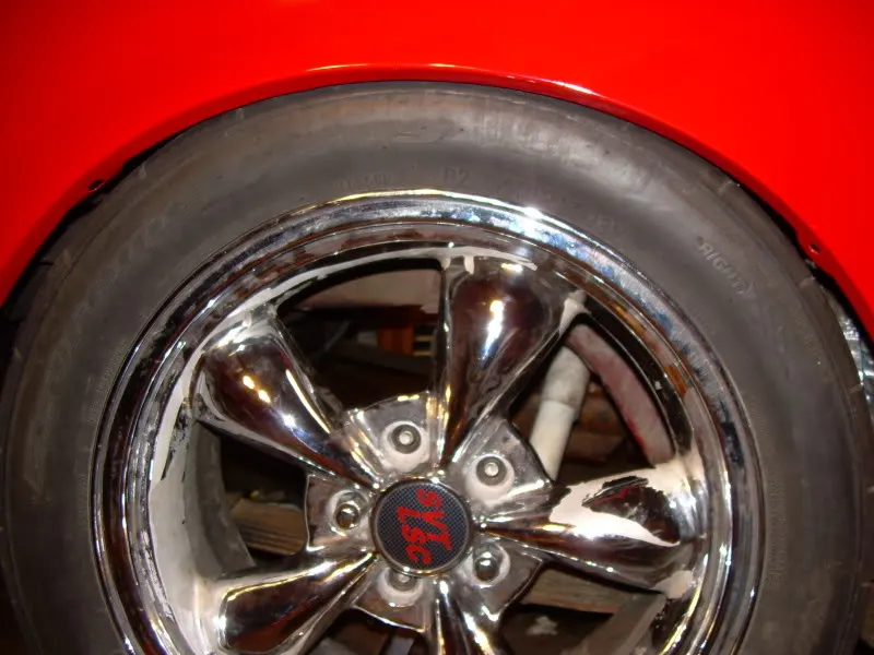

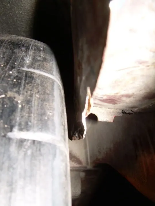

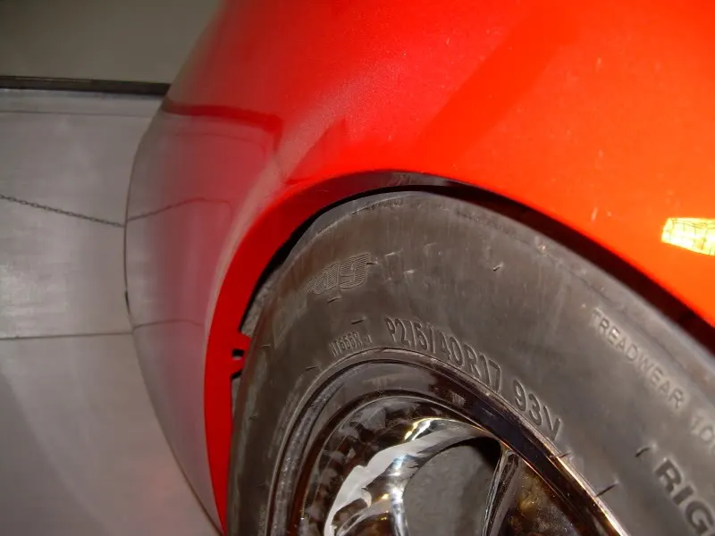

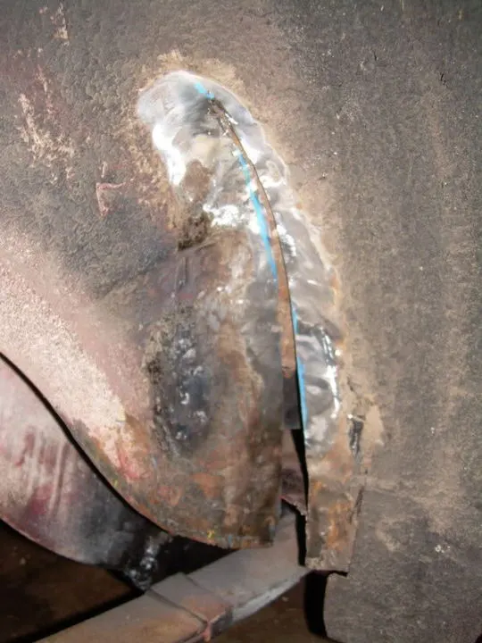

So I finally bit the bullet and went for a slight minitub. I cut up the front of the rear wheelwell on my 66 coupe and was able to move the front in about 1.5".
Next went on some nitto 275 drag radials on bullit rims. They might work, but prolly need some fender rolling. This is with stock springs and 2" drop blocks to simulate under a bump. It is still 2" off the bumpstops however. How does clearnace look?

The inside looks ok, but the outer lips will definetly have to be rolled. I am considering the wheelhouse mod as well. I have trouble getting my 225's to go without rubbing.
i think if i got a 5" bs is would have tucked better.with all the air out of the rear,it would barely rub, but had the same clearance asyours......although i didnt cut the inner wheel house
I am putting on M/T Drag Radials 275/50 15 (just for to and from the track). Right now I am planning on getting a 15x8 wheel with 4.75" BS, do you think I would be better off going with 5.00" BS?
it depends how big your hammer is.If i have a choice of rubbing, i would choose the inside for less cutting rather then the lip.
Most of the rubbing will come from the front inside corner of the wheel well.I "massaged" mine with a BFH just enough to stop rubbing in hard turns.I didnt see a need to cut, but maybe with a 5" BS, you might have to.It will also depend on how low the rear is.
I cant see how you got that 275 to fit without doing this mod. I had to easily take an inch out for them to fit
