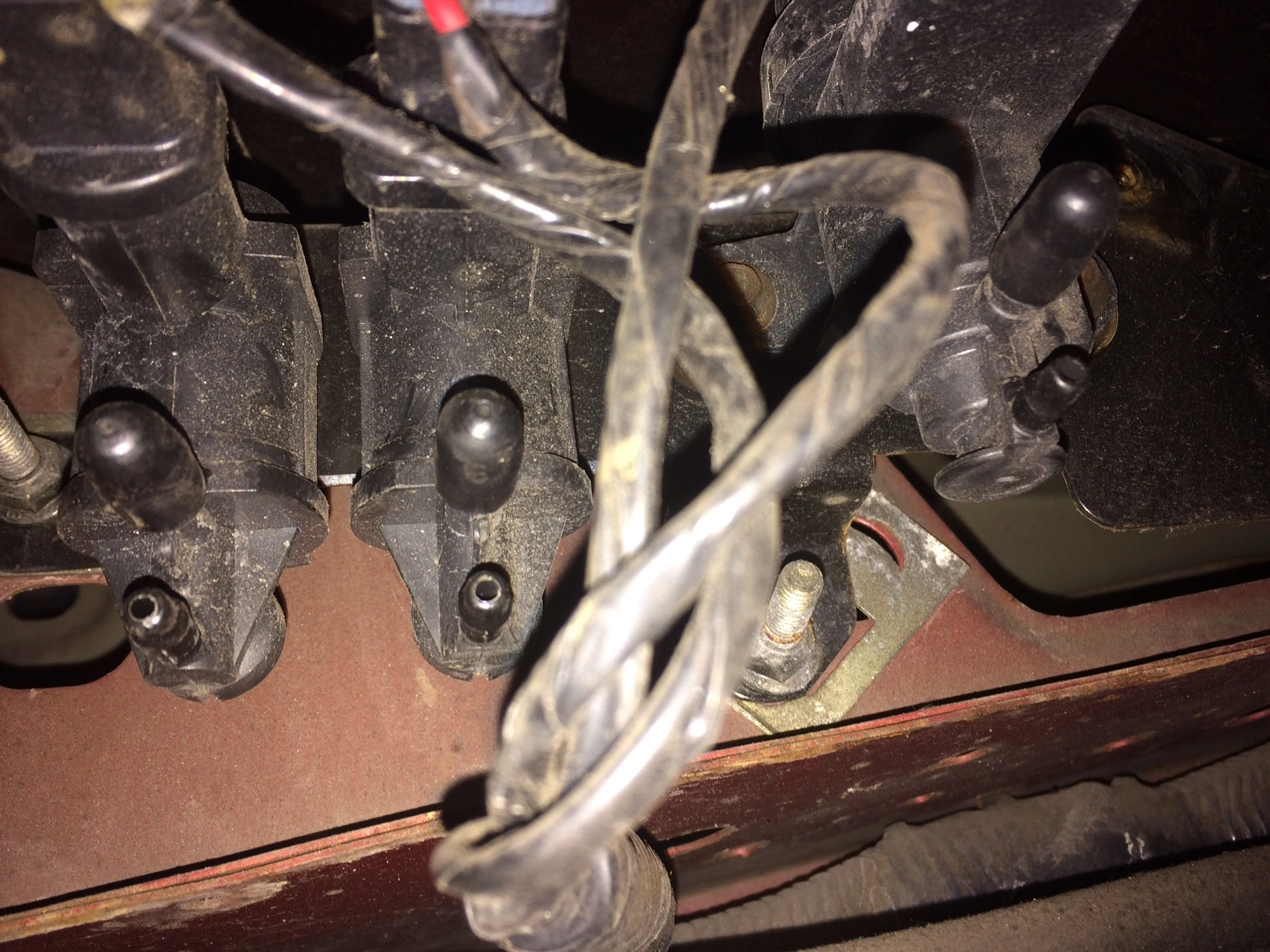

I did an extensive search but it seems that all the threads don't have a definitive answer. I deleted my smog pump along with complete EGR valve system. My question is , The three solenoids under the passenger side wheel, can I unplug them or leave them plugged in, cap the the two ports on them or no caps. Obviously my concern is the check engine light and not having the engine run properly. I left the egr valve plugged in cause from reading I will get a check engine just alone from that.

So can I disconnect the solenoids without getting a check engine or compromising performance.

Yea, it will just have a perpetual code, the cl may light up once in a while but it can live without them. Cap off the vac line that runs to it.

Just a update. All the solenoids were disconnected and I have the egr plugged in with the plunger taped halfway until I get a plug I ordered on ebay to eliminate a possible check engine light. So for zero check engine light.
You won't get a check engine light but you'll still have a code since the egr valve isn't moving (the resistance doesn't change). The better way is some tuning software and a chip to shut it down - then you can also do whatever you want with your injectors, MAF, etc. You can do so for as little as $150 or so (Jaybird+f3+TunerPro from Moates). QuarterHorse+BinaryEditor is better of course.
