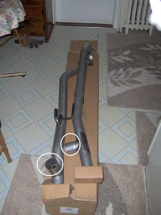

sorry if this seems like a stupid question....
PeteyAce
Jul 2, 2004
346
17
but does this have to welded or do i just clamp it?
you can also get the clamps at auto parts stores. I got a 2.25" clamp for around $10 or so at O'Reilly - you might not have them in your area though.
Kinda weird no shops in your area will do it, but most likely it's because of the missing cats. I could see how steep slopes could scrape and cause problems though.
Unless the cross over tube is mishapen and causing a mismatch between the sides, clamping will do just fine. If you have a minor problem with fitment, you may consider picking up a pipe expander to make small adjustments in roundness.
Dont weld it becuse it hooks to the h pipe mounts witch connect to the trany mounts thouse tall 90 rods/flangs in the center of the H pipe will not clear enough for you to take it off if you weld it
i clamped mine, but I had to clamp it off of the car, because the pipes would not connect straight on once they were attached to my headers, than i had to use porta power to seperate the h pipe while clamped, to extend and fit my headers, i didnt feel like welding it, waste of time, clamps always work in my opinion
