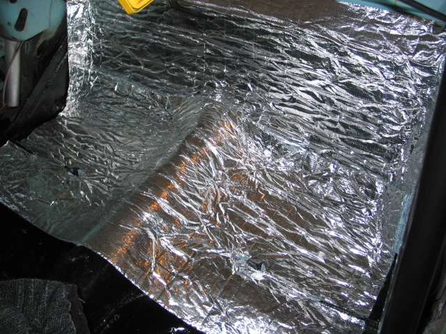

This is "WonderMat" available in large rolls for little $$$$:
Here's what I did:
Here's what I did:
http://www.edbert.net/carpet.htm
I purchesed something similar at a hardware store. It is actually insulation for hot water heaters and the like, but it worked pretty good in my 73 mustang for reducing the noise levels. My exhaust note is pretty loud at 2000rpm, but that stuff really took it down a notch.
