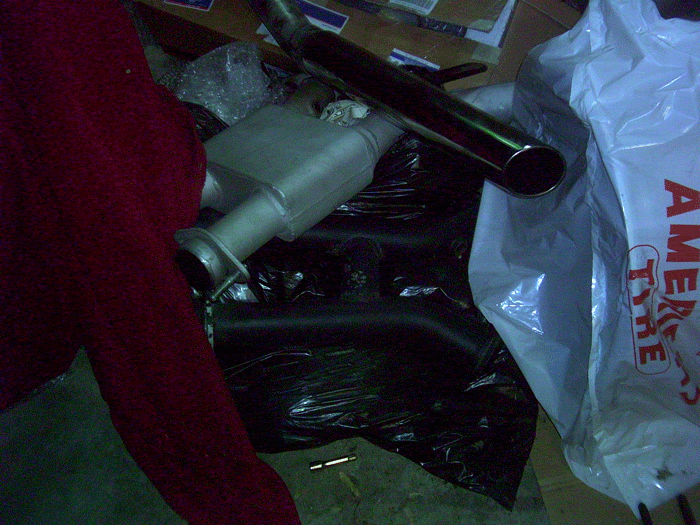

i just ordered my ss mac catback this afternoon. Im having trouble deciding what to mate it with. I narrowed it down to either a mac offroad h or the offroad prochamber. i just dont know the sound difference. all the sound clips i hear are the mac catback with the prochamber. non are with just the offroad h. And i already dished out 500 on the catback. the h is only 180. And it doesnt come in ss. If i got the prochmber id probably just go ahead with the ss one. But if the difference in sound isnt that noticable then id probably just go with the H.
thanks for the help guys and gals.
jeff
