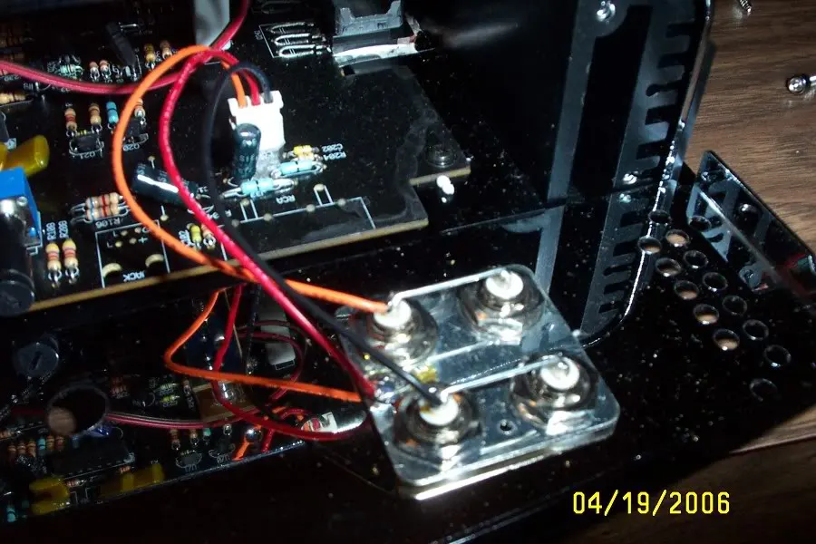

Every morning when I go to school my subs don't work. Then when school gets out and I get out to my car they work. Some days Ive gotten pissed enough to sit outside and wiggle wires and **** and they'll suddenly work and other days i can wiggle as much stuff and check as many connections/fuses as possible and they still won't go til after school. Any ideas as to what would be causing this?

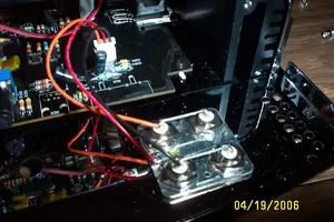

Alright well i have the amp inside my house right now im going to tear that down and have me and my dad take a look at it, he's an electrical engineer so hopefully he'll be able to tell if anything's messed up. All the wiring should be fine ive changed the speaker wire and when i was taking everything apart i could tell everything was connected tight. Nothing could be pulled out without major loosening of the hex screws holding the wires in. Ill get back to you guys on what we find out. I'm pretty sure it's nothing to do with the subs themselves though. The amp and subs are both less than 2 weeks old and the problems always been fixed by moving/messing with wires/hitting the amp/waiting til its after school. Another thing that is supporting the theory that something is expanding and making contact is that today it never really warmed up well and the subs never really worked today, i hit the amp a couple times and the subs started working for a bit then it stopped again. I have pictures of what I believe you guys are talking about possibly having cold solder joints.

it could even be a minor little hairline crack in the signal paths on the board--which can also come on and off from expansion due to heat...
