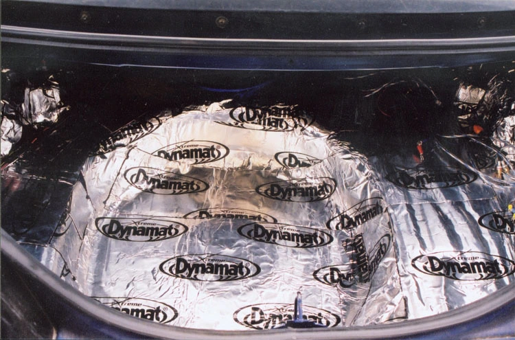

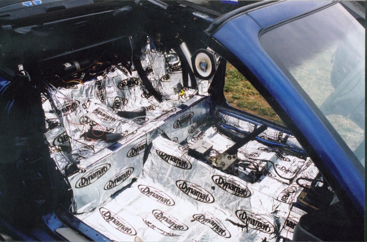

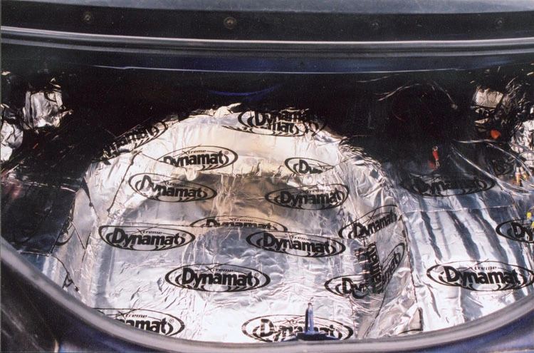

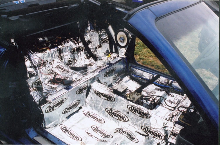

I used about 2.5 packs of the 36 sq feet of extreme dynamat...and it works great! I got it for 90 bucks per 36 sq ft pack. i still have about 23 sq feet left...I covered the entire cab, doors, trunklid and entire trunk:
