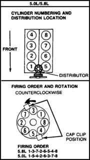

well i might of found my problem.
i just found this diagram:
i was using one that didn't show the cap clips
now i have the cap clips inbetween 3 &1 - 6&5
not 7&3 - 5&4
i'm running out to the garage to switch it up now. back in a flash lol

on its right
i'm such a ****in idiot:bang: :bang: :bang: :bang: :bang: :bang:
