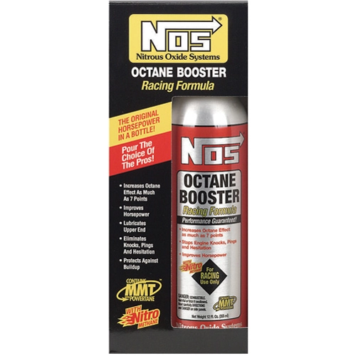

I don't believe "gas treatment" nor "fuel injector cleaner" boost octane any degree.
Try something like the NOS racing formula:
