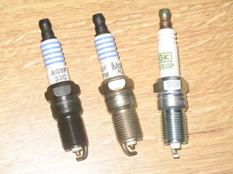

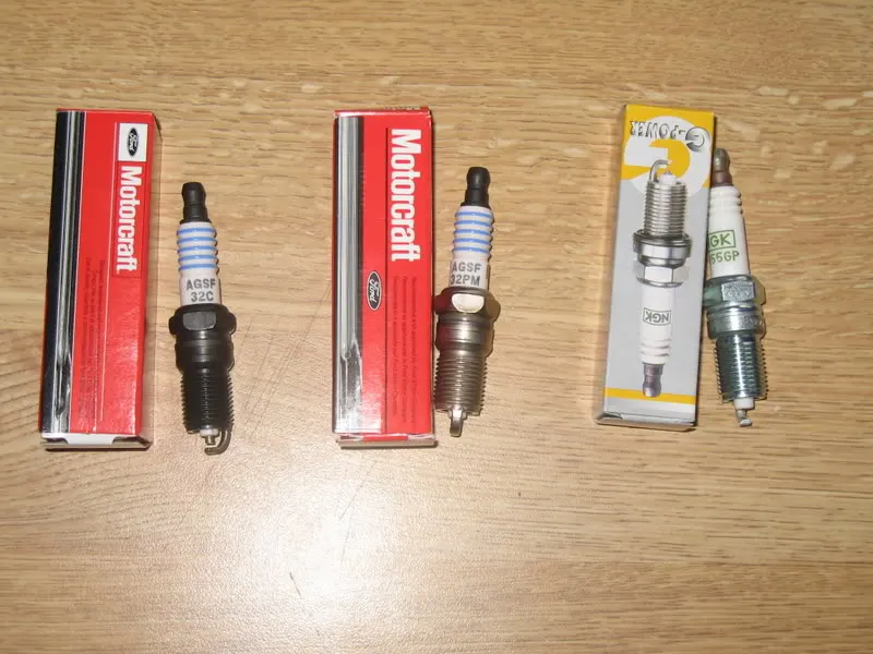

Hey everyone. Which of these plugs for my 04 GT?
Left to right: AGSF32C, AGSF23PM, NGK TR6

I use the Motorcraft platinums(center). The Motorcraft coppers may be slightly better performing tho they won't last as long. Never used the NGK's before so I can't really say anything about them other than alot of people seem to like them.
The middle ones are the best. AGSF 32C's.....aren't those for 302's??? I always bought those for my 5.0L I used NGK TR6's in my 95 GT with the Procharger. I think it is two steps colder than stock and my car ran good with them gapped small.

all the Motorcraft plugs that used the "AW" designation were of the 1/2 thread design and discontinued and about a year ago, FoMoCo/Motorcraft finally got on the bandwagon and replaced ALL the "AW" series 1/2 thread design plugs wth the "AG" series which is a full thread design.
also you can sea the NGK plug has an extended tip vs the Motorcraft which is NOT a good thing, as the extened tip plug is closer to the top of the piston which can lead to a collision between the too...and moving the spark closer to the piston is in theroy, like advancing the ignition timing slightly, thus causing detonation and other spark related issues
