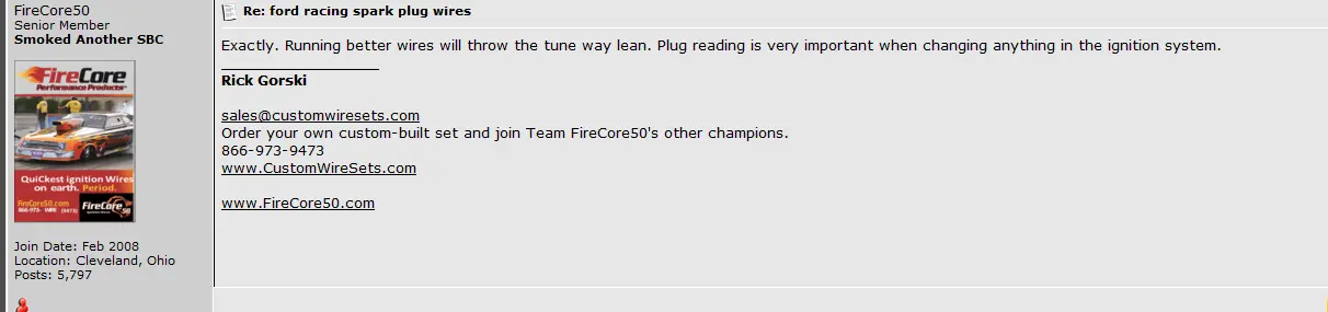

I'vr read over the years Rick Gorski from Firecore50 wires has done some extensive analysis on this.
http://www.yellowbullet.com/forum/showthread.php?t=321168
