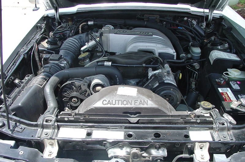

Speed density

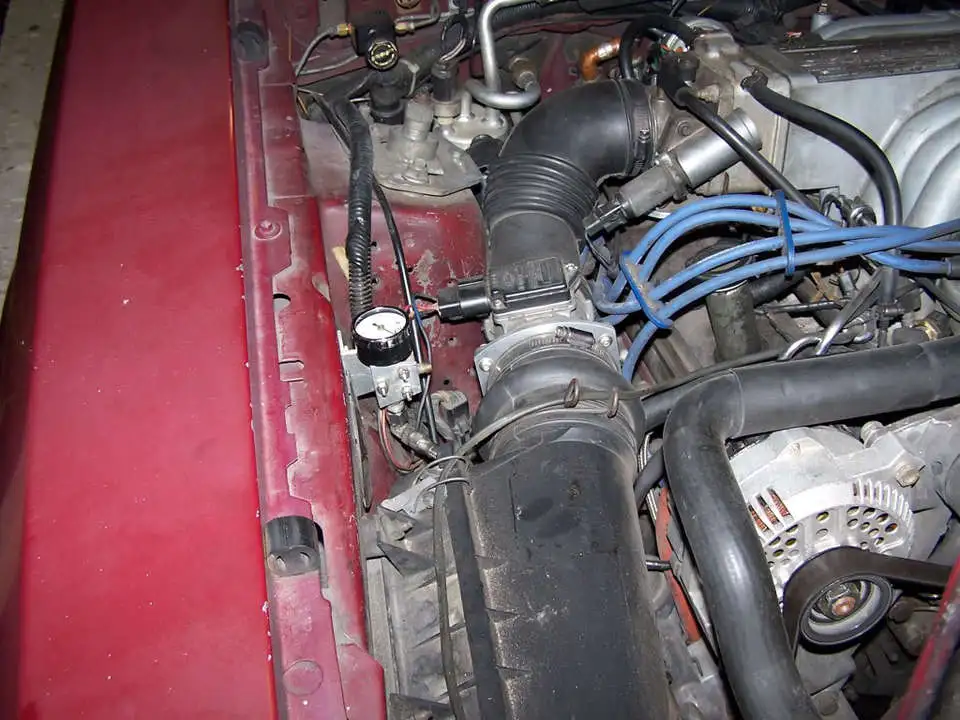

MAF

Picture of a MAF - yours may be slightly different.
