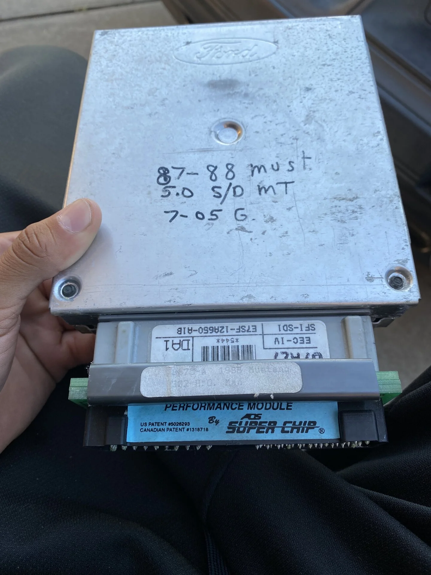

Just saw that my old computer has an AOS Super chip would this be compatible with the A9L ECU and could this be a reason for a rough run without it

That is Old School!
If that is the ecu you removed, then it shouldn't affect how the car is running now.
I would suggest pulling codes, and doing a part number check for the injectors and the MAF housing/sensor.
That setup should not need a tune, so most likely something is off, either a part mismatch or a conversion/wiring issue...
