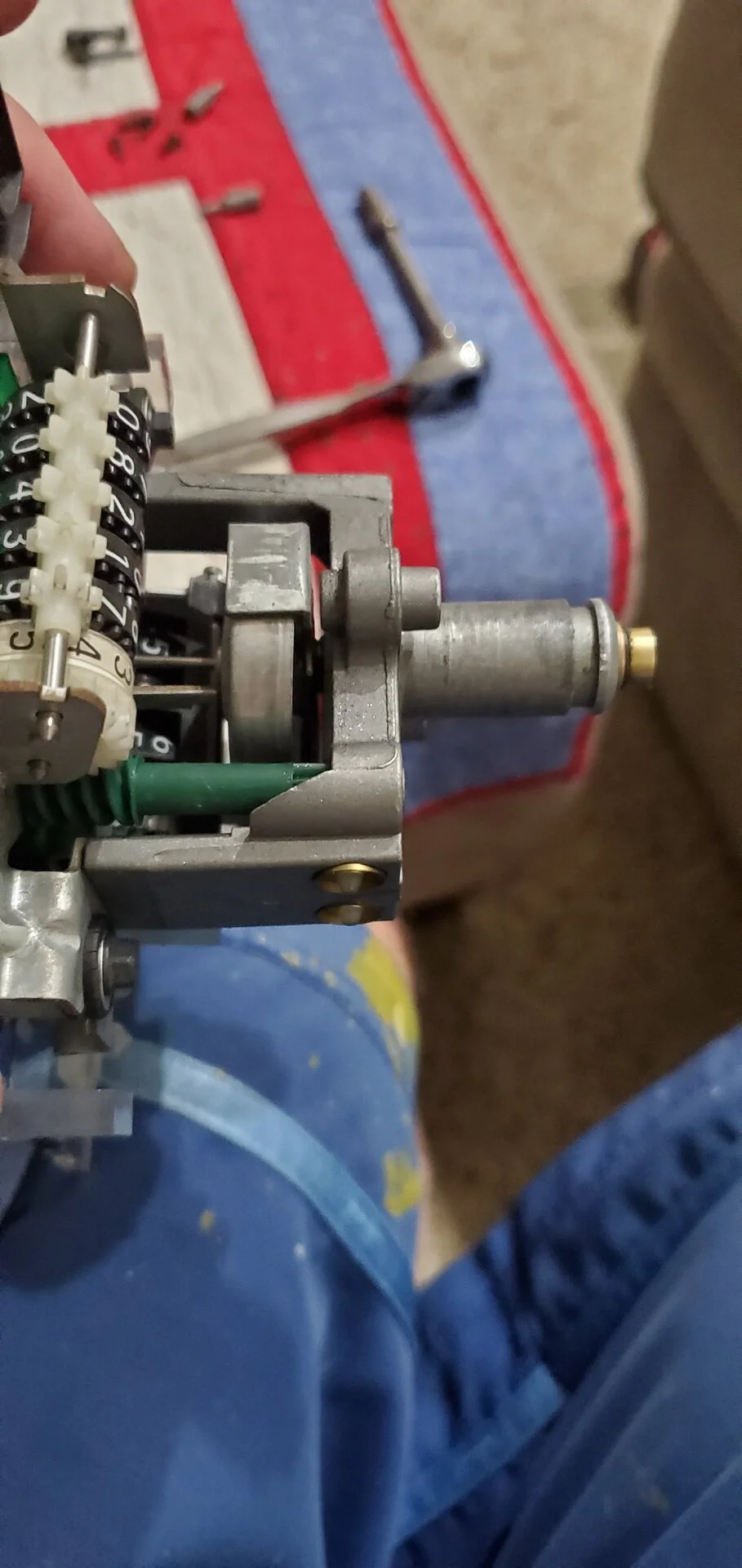

Update... hooked a new cable up and spun it by drill and it was the same as the old cable. So I have the cluster torn apart... where in this pic should I be cleaning/looking for the problem?... and what is my course of action?
I spin it by hand (I know it isn’t a uniform spin but nonetheless) and it is erratic like with the cable...

BUT... I THINK I fixed it?!?!?! I’ll let you be the judge. It’s NEVER worked right
EDIT:it’s not letting me upload videos... but it bounces about 20 mph (10-30) until the drill spins it over about 25 mph then it’s pretty darn steady. I’d even say the faster I spun it (say 80 vs 50) it’s damn near no wiggle... I think it’s as good as I’ll get it? If it does this IN the car, I’ll be ECSTATIC lol... it’s NEVER worked even close in my ownership (since 2005) :O_o:

Most of them bounce under 20MPH. My first 140MPH speedo did this even with 3 new cables. I swapped to a 160MPH speedo head that had low miles on it, and using a drill it's steady even at 5MPH. No bounce. My 140MPH speedo on the bench with a spare cable will bounce like it did in the car, which is why I believe that the issue isn't always a cable, but can sometimes be the speedo itself.
Reactions: Andrews24
Yeah it’s 100% the head. I’ve gathered info from you and Jrichker with his Speedo breakdown step by step - and going part by part, it would 100% have to be in the cluster (head). You have 3 cables, I’ve tried one, others have tried the cable... all else there is is the sensor, and 2 tooth gears... we’ve ‘bench’ tested without the sensor and gears and duplicated the results of in-car leaving it to be in the speedo cluster - absolutely agree with you.
As for me, I lightly got brake cleaner onto that disc that spins as well as the 2 ‘arms’ that spin around the disc - there was some ‘build up’ of like old metal(?) mixed with an old lubricant(?) - and got some brake cleaner inside the backside of that disc. I made sure it dripped away from the speedo.

I cleaned the head with brake fluid and used some all purpose oil on mine and it’s been pretty smooth and quiet for almost a year now. I battled that for quite some time. Drove me nuts.
