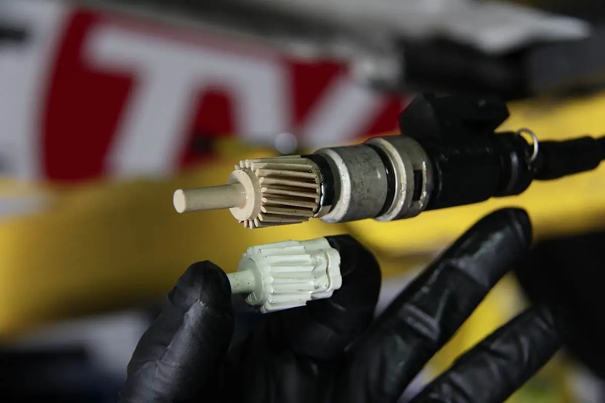

You are right i don't think its the the o-ring. I just checked underneath. I have a drop hanging from the bottom of the electronic plug after wiping it clean last night. The o-ring area was bone dry.
The picture below is not mine but as reference. See that little silver clip ring at the very right, that is where my dribble of oil was hanging from. Right where the middle finger is pointing.
Can I pull it out with a pair of pliers, then take the electronic plug off before sealing it with some silicone?

I believe there is an o-ring inside there as well. I could be wrong as it's been a while.
The clip is more of a spring that secures the cable in the VSS. A good yank will free the cable, or remove the clip
